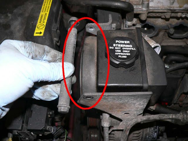

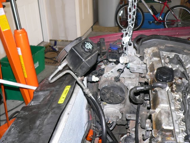

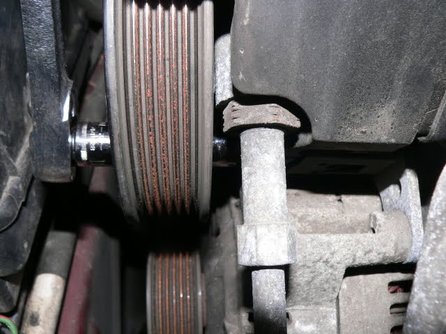

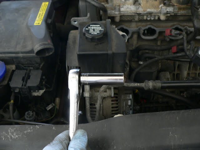

You remove the pump spacer bolt, then the guard plate, then the two bolts holding the pump on the inside of the car, then thru the pulley there are 3 bolts (feel around for them). After that just lift off.
