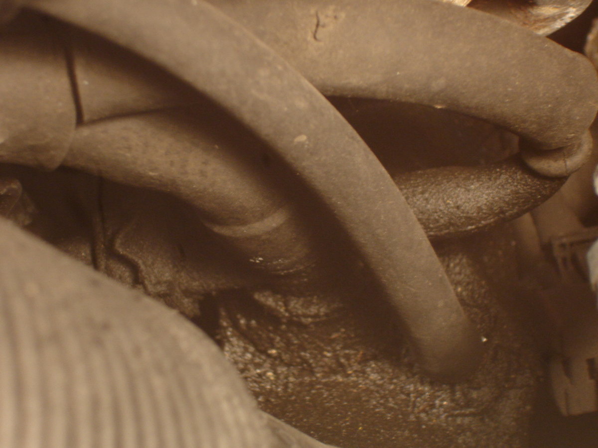

So here are two pictures of what I'm dealing with:
This is a wide angle view looking down on the air intake where the PCT valve is.
Here's a close up of the PCT / Air Intake connection. I noted that there is a lot of oil around this connection.
This is the actual location where the PCT attaches to the air intake. There is a hose in the foreground that I believe is not associated with the PCT valve.

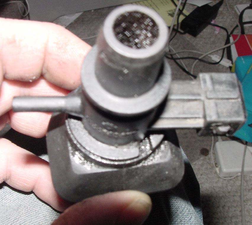

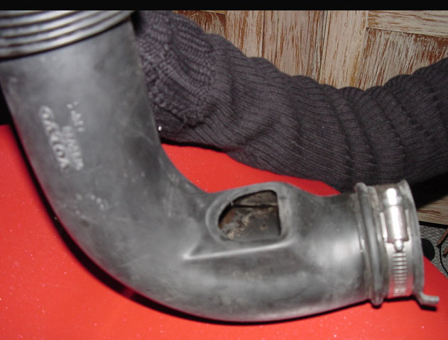

In the pictures below, the PTC has come out with ease due to the rubber seal deteriorating so much that unmetered air was getting into the system and giving me error codes. Not a good idea to remove the PTC in this fashion
The second picture is the turbo hose, sans PTC, but with the clamp attached, the third shows the top and side hole and the electrical connection.

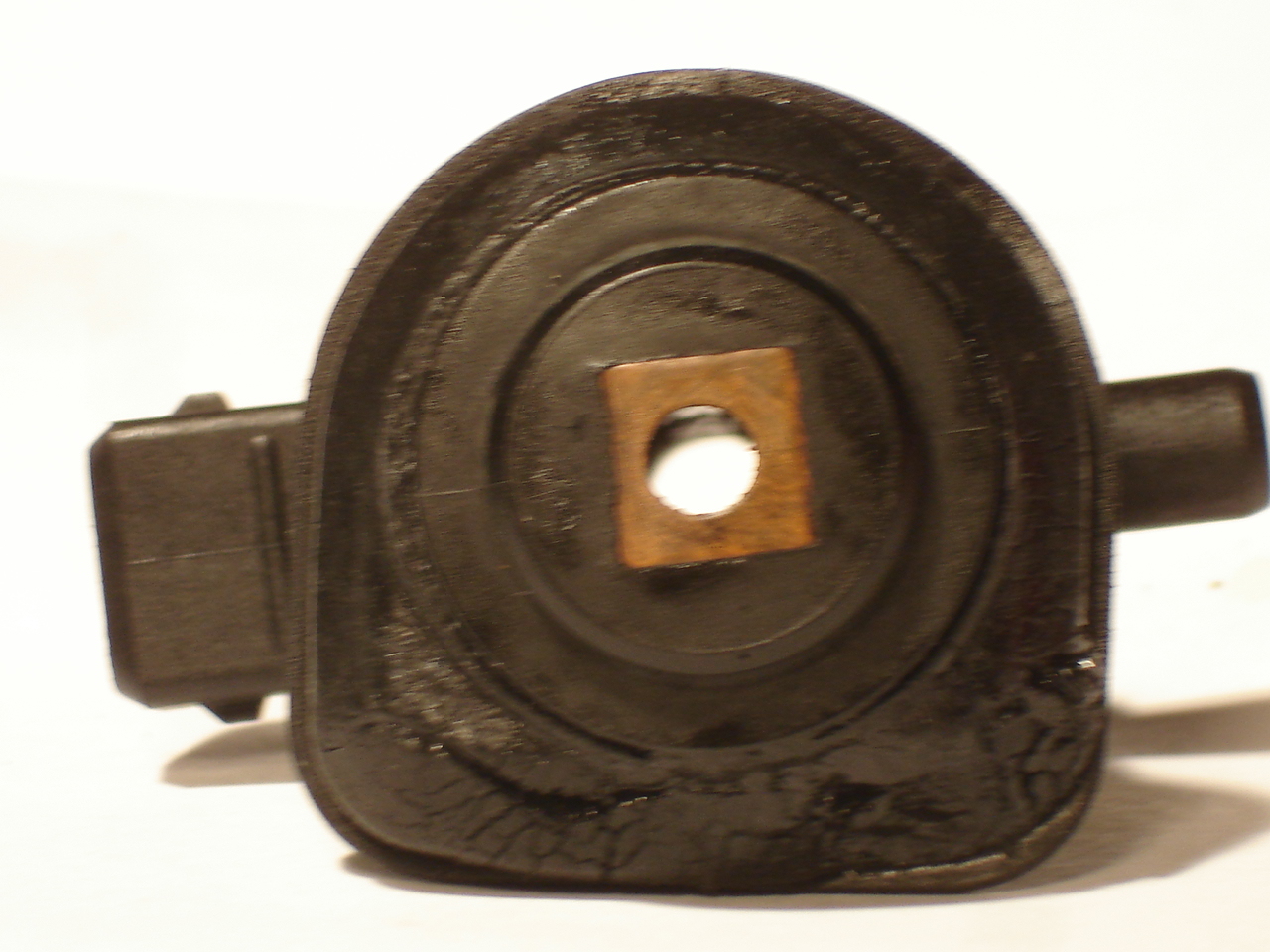

I managed to get the PCT off. Actually the entire thing came off the air intake hose. It looks
like the PCT should come out without the mount to the air intake hose.
The rubber seal has deteriorated on my unit. Do I need to replace the seal? I haven't seen then for
sale but given the deterioration I would expect someone must sell them.

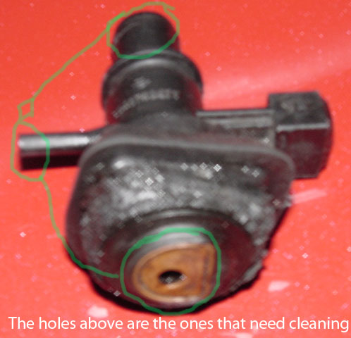

Surprised at how much oil is all over the PCT valve and everything around the point where it connects to the air intake.

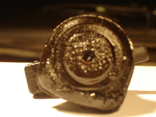

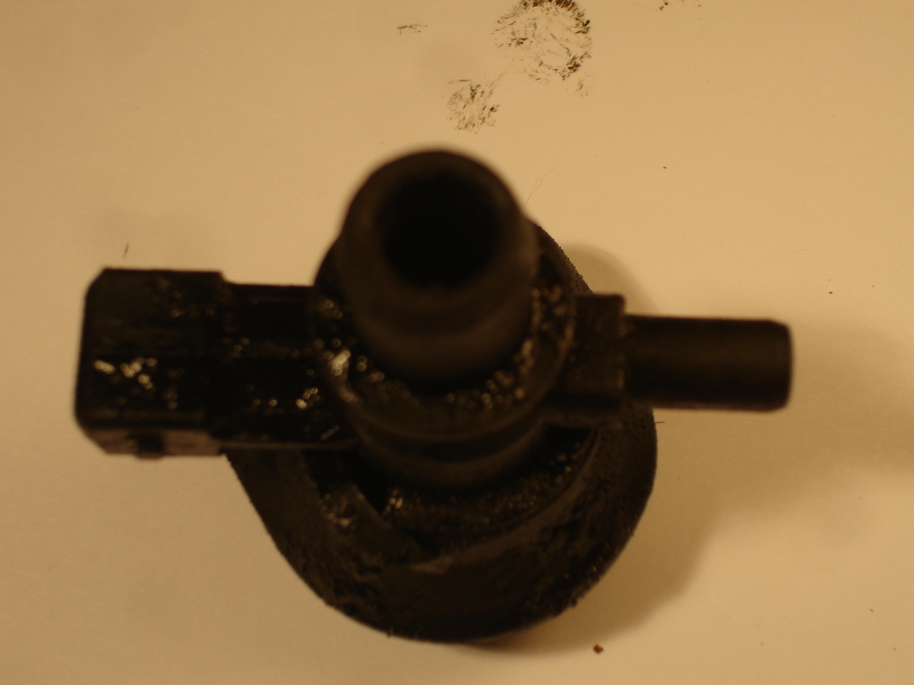

The bottom opening is almost completely clogged with oil sludge. I guess this means my PCV system
is not doing a heck of a lot with the PCT in this condition.
The bottom of the PCT looks clogged up pretty good.
I tried to get a good shot of the large tube at the top. There are very hard deposits on the inside of this
tube.
The PCT right after removal. The large tube at top has significant deposits.
Started cleaning the PCT and an amazing amount of oil deposits material is coming off. Haven't completed cleaning
the hard deposits out of the larger tube. Need to get a better tool, like a test tube cleaning brush, to really to at this.

Do not bother cleaning it, you need a new turbo hose ! There are no replacement rubbers. Fcp or Darrel Trip or any other parts suppliers will have it. Ask for extra caps for the new Turbo hose as you may have extra nipples (newer version)that need to be closed.

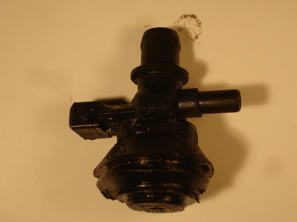

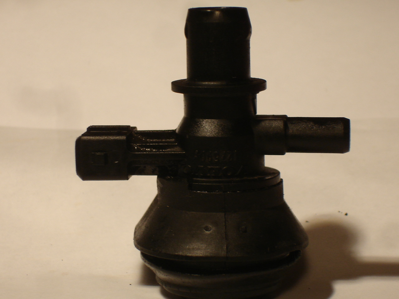

I cleaned the PCT valve. A small toothbrush works pretty well. Used a combination of degreasers
and sea foam to clean off a lot of the oil deposits. I suspect the deposits may be due to the valve's
function of heating the gas coming from the oil separator.
There were no hose clamps on either of the two hoses going to PCT on my 1997 Volvo 850 GTL. Someone
mentioned there would be clamps. The hoses do not appear as though a clamp had ever been there. Is it
the case that the intake hose has a vacuum such that the tendency is to pull the hoses instead of blow them off?
Here are a few pictures:
You are now able to see through the cleaned<br />valve passage.
valve passage.
Note the clear passage:
Cleaned up quite nicely. Some deterioration<br />in lower seal but most of it still intact.
The PCT valve was in reasonable shape so I decided to use it instead of purchase a new hose. I discuss my thoughts

Here is my take on whether a new hose is needed. I also have some questions that might be good for
any PCV / PCT tutorial to cover.
First: New hose.
A new hose it $89. I believe most of this cost is due to the fact that the air intake hose includes the
PCT valve. I don't see the PCT valve sold separately (why) nor do I see the rubber seal that deteriorates
available. Someone posted a link with a hose (without PCT valve) and someone else said I needed to replace
the hose (implying the PCT valve could not be salvaged.
My air intake hose is perfectly fine. Therefore I am resistant to buying a new one because the rubber seal
on the PCT has started to deteriorate. If someone buys one for this job please take pictures demonstrating how
to get the PCT valve out for cleaning without removing the PCT mount. I'm assuming you are supposed to be
able to remove this and clean it without having to buy a new air intake hose. I may eventually need a new hose
but I'll put on my MacGyver hat before I shell out $89 for a new air intake hose.
What types of sealing material will hold up under these high temperatures? The upper portion of my PCT rubber
seal is perfectly fine. If I could remove the air intake (which I wasn't able to do using reasonable force) then I would
seat the PCT valve on the air intake hose and seal it in place. What has the consistency of silicone but will hold up
in this application? I'm assuming silicone won't work.
If a more secure mechanism is necessary it doesn't look difficult to build a custom PCT clamp using two hose clamps
and something to hold the PCT in place.
If my PCT valve falls off I will try one of these first. It is my understanding that the PCT valve is vary reliable. It's
just the hose companies who design the rubber seal to disintegrate so people have to buy hoses.
Air Intake Hose $89 - Looks a bit redesigned<br />compared to the host in my 850.
