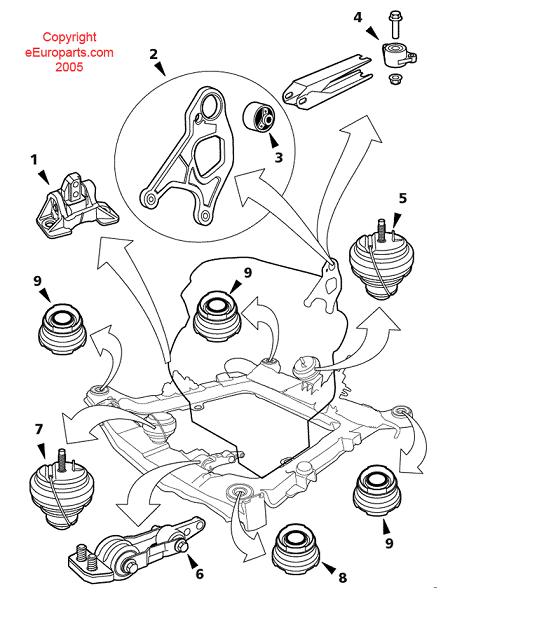

More specifics! When do you hear it, getting on/off the gas at low speeds, when the transmission changes gear...?
If so, it's probably a motor mount showing signs of wear under heavy engine load. The top one (as you probably already know) at the firewall, and the lower one under the transmission are usually the suspects for making clunking noises. The subframe ones will cause a lot of engine vibration, but not necessarily noise. Those can be checked, too - you should be able to insert a finger between the bottom of the engine and the front frame bracket.

I have a new #3 on that diagram. polly upper from IPD.
