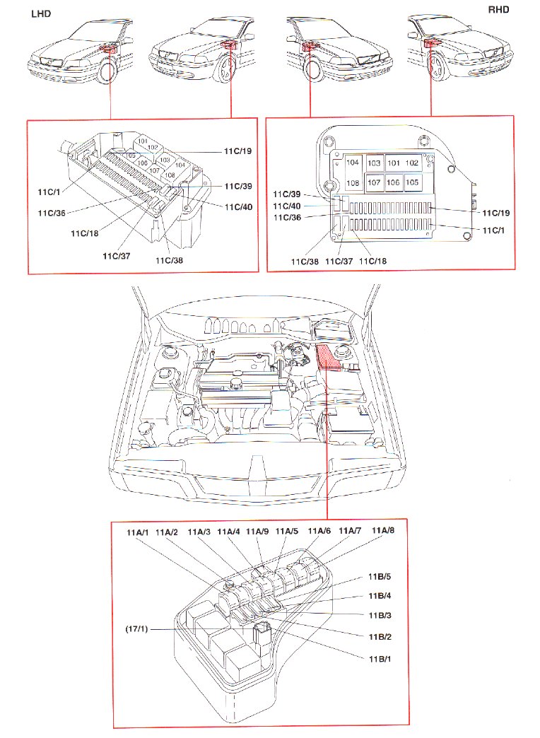

If you had smoke from a vent, I'd consider a bad blower motor and/or power stage for that motor.
The power stage makes the most sense and it IS installed inside the ductwork near the blower motor.
Both of these items are behind the glove box. That probably blew some fuses...And will again until repaired.
There are two fuse boxes under the hood.
98 x70 Fuse Locations.pdf
(144.34 KiB) Downloaded 172 times
The ECC system gets power from fuses 11A2, 11A6, 11A8 and 11B1 in the BIG fuse box.
The 11A fuses in the BIG fuse box are master fuses and usually feed more than one system through
sub fuses in locations 11B and 11C. So having several seemingly unrelated things stop working makes sense.
For the ECC, check fuses 11C5 and 11C10 in the box with all the small fuses.

i appreciate your advice. i opened up both fuse boxes and saw nothinging with the markings you described. In the adobe script it said it was a 98 x70, my car is a 98 s70 glt, im not sure if that changes anything, i appoligize for leaving out that information if relavant. the adobe file was damaged and did not open anyway. again i appreciate your efforts.

x70 is just shorthand for any C/S/V70 series car.
C(oupe or Convertible), S(edan), V(Wagon).
I don't know what happened to that PDF, so try let's this as a jpg:
98 x70 fuse locations.jpg (143.78 KiB) Viewed 1646 times
