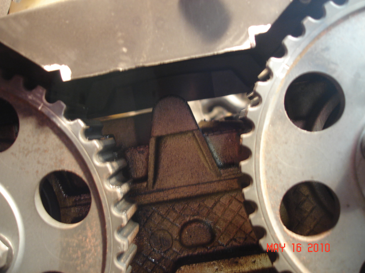

1) Here is a picture of my existing timing belt timing marks. Are these acceptable? They look okay
when looking at them from above but the camera picks up a little different view when looking head on.

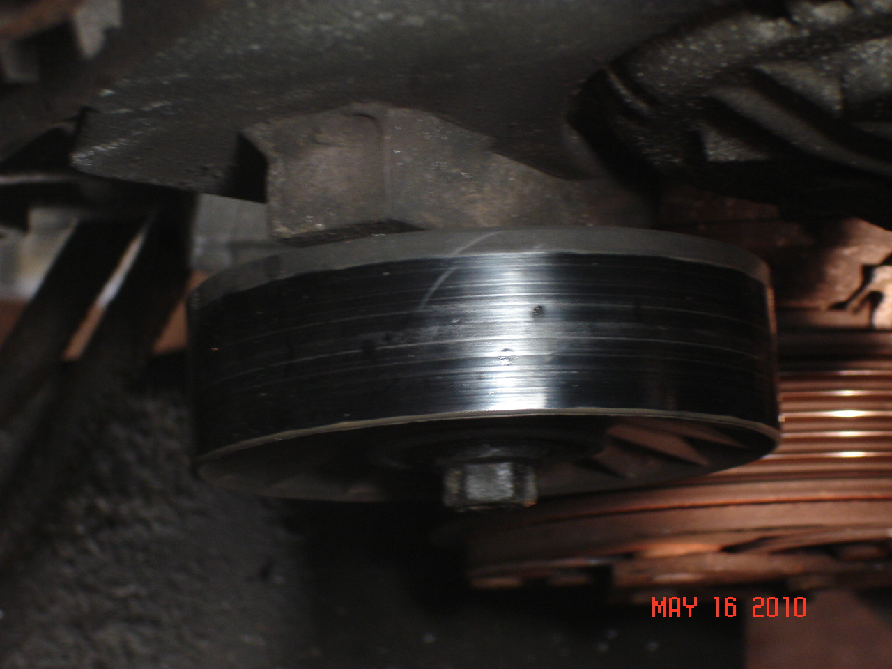

2) After removing the serpentine belt and auxiliary drive belt tensioner I spun all of the rollers.
The auxiliary belt idler roller squeals.
Is this a matter of lubricating the idler roller? The 1995 850 service manual does not discuss lubricating this roller.
I haven't removed it yet because I thought I was doing the timing belt today...can you say project creep.
The 1995 Volvo service guide that's online recommends lubricating the auxiliary belt tensioner every 30,000 miles.
When folks are changing the timing belt or serpentine belt do you normally lubricate the auxiliary drive
belt tensioner? Do you use the Volvo grease? Or will multipurpose grease work?

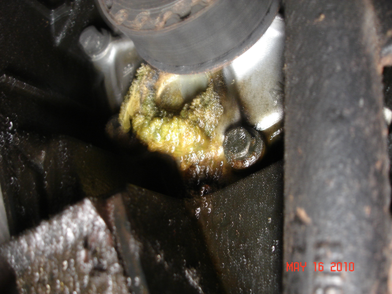

3) Water pump
Looks like I need to clean up my water pump some...haven't gotten close to it yet but looks like the seal is failing
which has resulted in this crystal structure on the water pump exterior.
Is it the seals that fail on these most of the time? This one is at least 80K old. I'll need to check my service records.
I've seen posts where it appears the seal failed and the individual replaces the pump. Is there ever the case where
you change the gasket and reuse the same pump? How many mile do you expect out of a pump?
I will install my new one so send me your offers on this slightly used one...

the marks look fine, but paint the marks on the cams also for easy double checking. Do you have the cam lock tool? Use it to prevent movement of the gears.
The roller needs replacing if squealing. Also you need a new water pump and tensioner while you're in there.

It would be a really good investment to change that water pump while you're in there, especially since it looks like it's beginning to fail. Always better to be safe than sorry!

Hello, The two rollers (idler and tensioner) don't count as "project creep". Finding the sweating water pump qualifies you as a lucky person. Since it's probably time to change your coolant anyway, add a can of water pump lube. A man who took care of many engines used the stuff and NOBODY in his family (or mine) ever had a problem. Also, as you may have read, start at the crank pulley and go "counter-clockwise" when you install the new belt. Keeping it tight around the idler and over both cam sprockets. Oh yeah, wire brush and anti-seize your lugs AND inspect the motor mount by the crank pulley. Kira

I can't fit a socket into the inch or so of space between the auxiliary drive belt idler roller bolt and the frame.
No doubt I can remove it with an open wrench or a stubby.
My concern is that my torque wrench will not fit into this space so I won't be able to torque the
roller properly when I install a new one. So how does it go, install new roller, hand tighten bolt,
remove engine from car, torque bolt, reinstall engine. Maybe drilling a large hole in the frame will
work...
