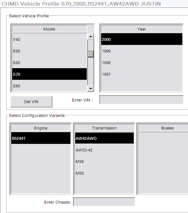

Matt, good addition to the site. I think we should add the fluids that each of the respective transmissions use for a flush/fluid change; that would be very helpful information to put together.
One little thing...as far as I know, both the 2000 S/V70 AWD's still used the AW50-42 transmission.
Cars with the B5244S engine, and AWD (Europe?) came with the 50-55AWD transmission, but AWD's were never made with that engine in the US (they are all B5244T).
Nitpicky point, I know, but the 5-speed only came in the base model 2000 cars. :mrgreen:
