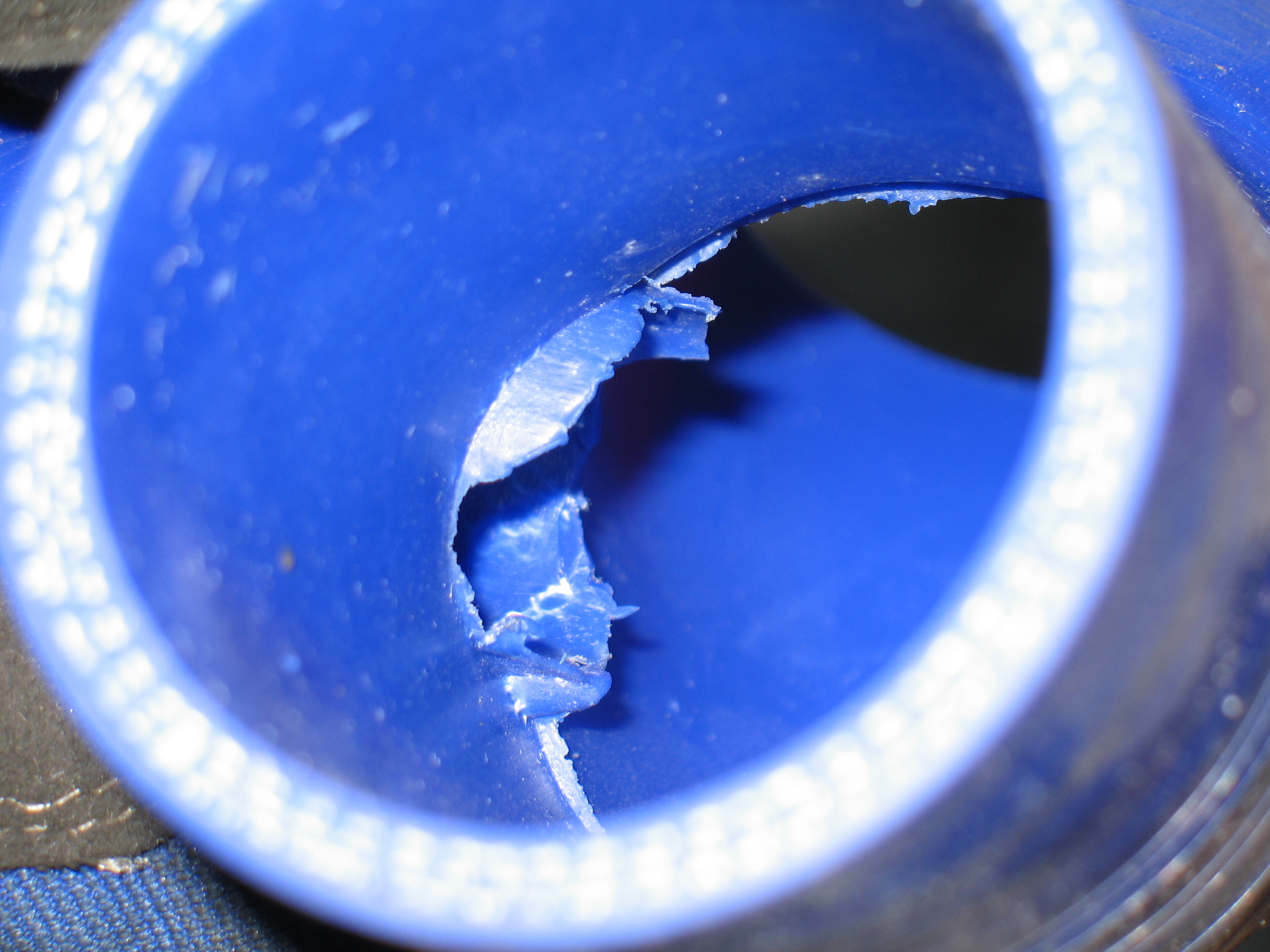

First, should I be worried about the excess material in this hose? This is the hose that has the ‘arm’ running off to the idle control valve:

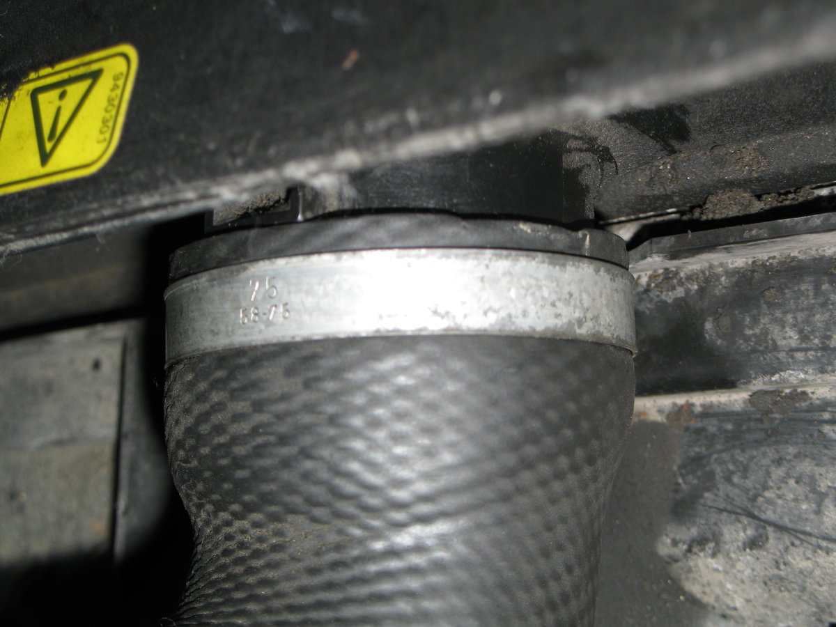

Second; the hose diameters (all of them) seems to be way too small – almost as if the inner diameter needs to be what the outer diameter is. The blue replacement hose that connects to the intercooler has an inner diameter of 58 mm. I didn’t measure the hose that is installed, but there’s no way its inner diameter is that small. The hose clamp has the following marking:
75
58-75
I'm going to guess that is the "usable" mm range of the clamp. There's not much metal hanging out from under the screw, so that tells me that the hose has an I.D. of 70 mm or so - correct?

Personally, I would probably just take some scissors or a small sharp knife and cut away that excess material. As long as it doesn't come loose and go anywhere, it shouldn't be an issue. Just cut it off.

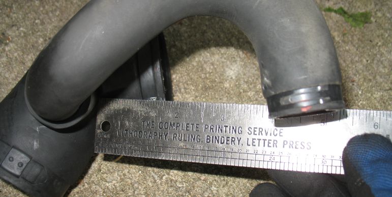

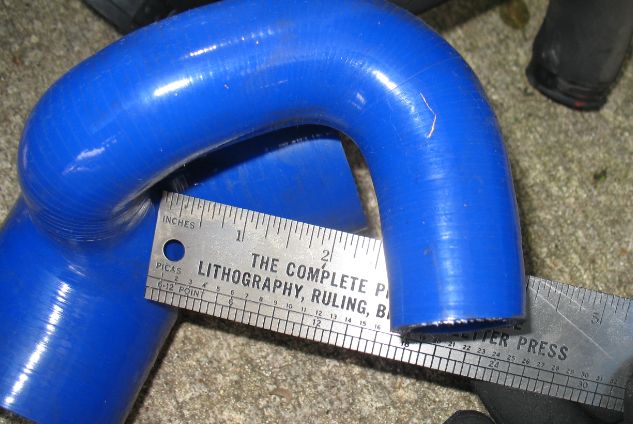

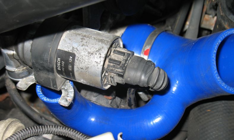

To aid anyone not able to view the external link for the pics, here are three of the most telling:
The hose opening is in the middle of the IAC bracket but should be to the left of it by another 1.5 inches: Outer edge of silicone hose reaches to 4 inches: Outer edge of old hose reaches to 5.25 inches: You can probably tell visually that the main part (throttle to intercooler) of the old hose is shorter than the silicone. Cutting the silicone (1) would not give enough distance for connecting to the IAC, (2) would throw-off the alignment for the pipe coming off the intercooler, and (3) the silicone hose is slightly wider at the throttle connection, so if I cut it the diameter would actually be smaller than it is now.
