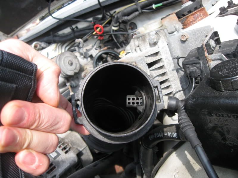

Was told by a mechanic to disconnect the MAF and see if it changed anything. I cannot locate the MAF sensor! The air temp (charge?) sensor is readily visible (first sensor after the air box), but there are no other sensors in the tube up to the manifold, and I see nothing that resembles pictures of the MAF from Rockauto.

My engine appears not to have a MAF(!).
It does have an Air Charge Temperature Sensor sensor where the MAF should be, view of down the tube directly after the air box
The sensor in the tube looks exactly like the picture at Rockauto.

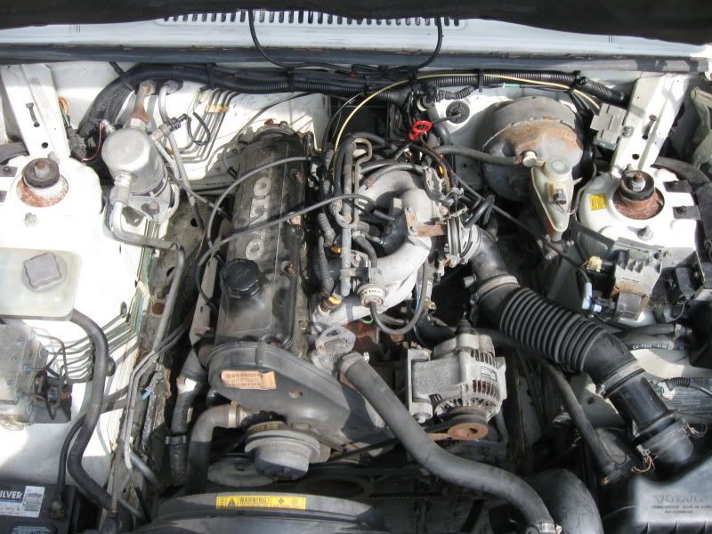

Overhead view of the engine (sans distributor, pulled to inspect it)
According to the various under the hood and door stickers, it is a B230F engine, Family NVV 2.3 V5 FR8X, evaporative family E3, ex emission control system MPI, HO2S, TWC, the car was manufactured in Belgium on 09/91.

The MAF is part of LH-Jetronic system...Your Volvo has the Regina system and there is no MAF...You have already checked the air temperature sensor...On the left fire-wall-to-spring tower brace you will see the diagnostic unit...Right next to it is the pressure sensor...The pressure sensor has a vacuum hose connected to it and the symptoms you are getting sounds like the hose is off...If it is not, then the unit should be checked...

On the brace to the spring tower there is a doo-dad which has a white semi-opaque hard plastic vacuum line going into it and also a 4 wire flat electrical connector (upper right corner of the picture I took, unit has a gray metal shroud with two Phillips head screws holding it to he strut, line and connector are on the underside hidden from view). Is that the unit, and if so, how do I check it?
