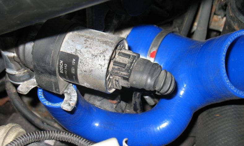

On the '97 850 GLT it's under the throttle cover near the Schrader valve of the fuel rail. On the butt-end is a wire harness and on the other (is that the head-end?) are two hoses.
Here's the butt-end of it.

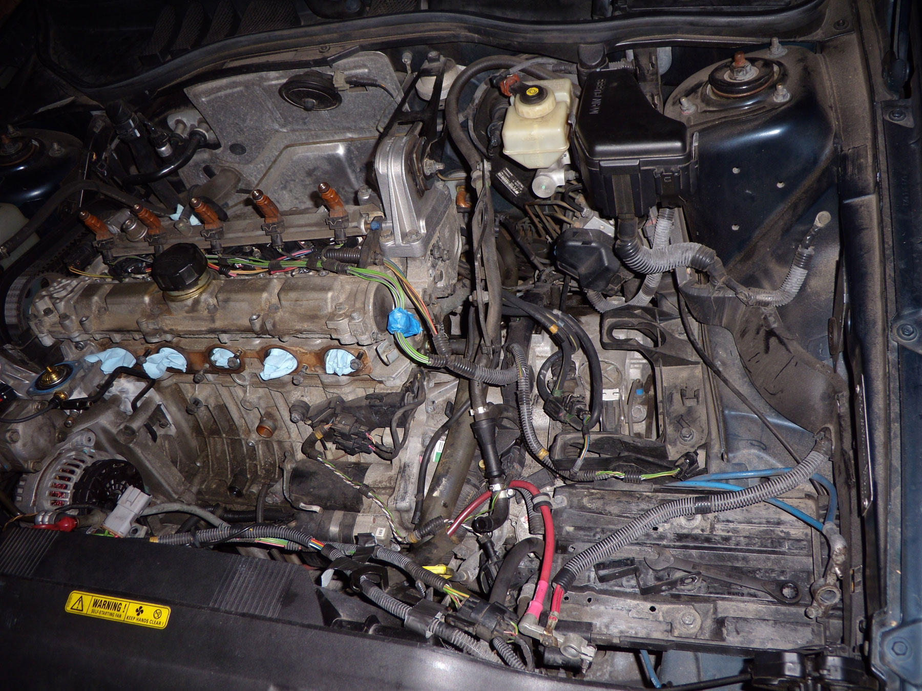

Ecbsykes is right, my battery is out of the car.
As a matter of fact, I'm cleaning all kinds of things.
Removed: fuel rail, intake manifold and ETM, electric cooling fan, intercooler hoses, air intake to turbo (w/PTC), the PCV system, air box, upper radiator hose... I think that's it.
Now, it's really easy to view and work on what's left attached to the car.
I was going to look underneath around the transmission but it got dark and the mosquitoes were hungry. Plus, I want to finish cleaning things up so I can put the car back together. Waiting on some parts but hope to be driving again this weekend.

It should look similar to the above picture. I just went out to listen to my car, and I definitely heard the buzzing. It was hard to pinpoint, but definitely in the area under/near the manifold. Sorry I can't be more precise.
