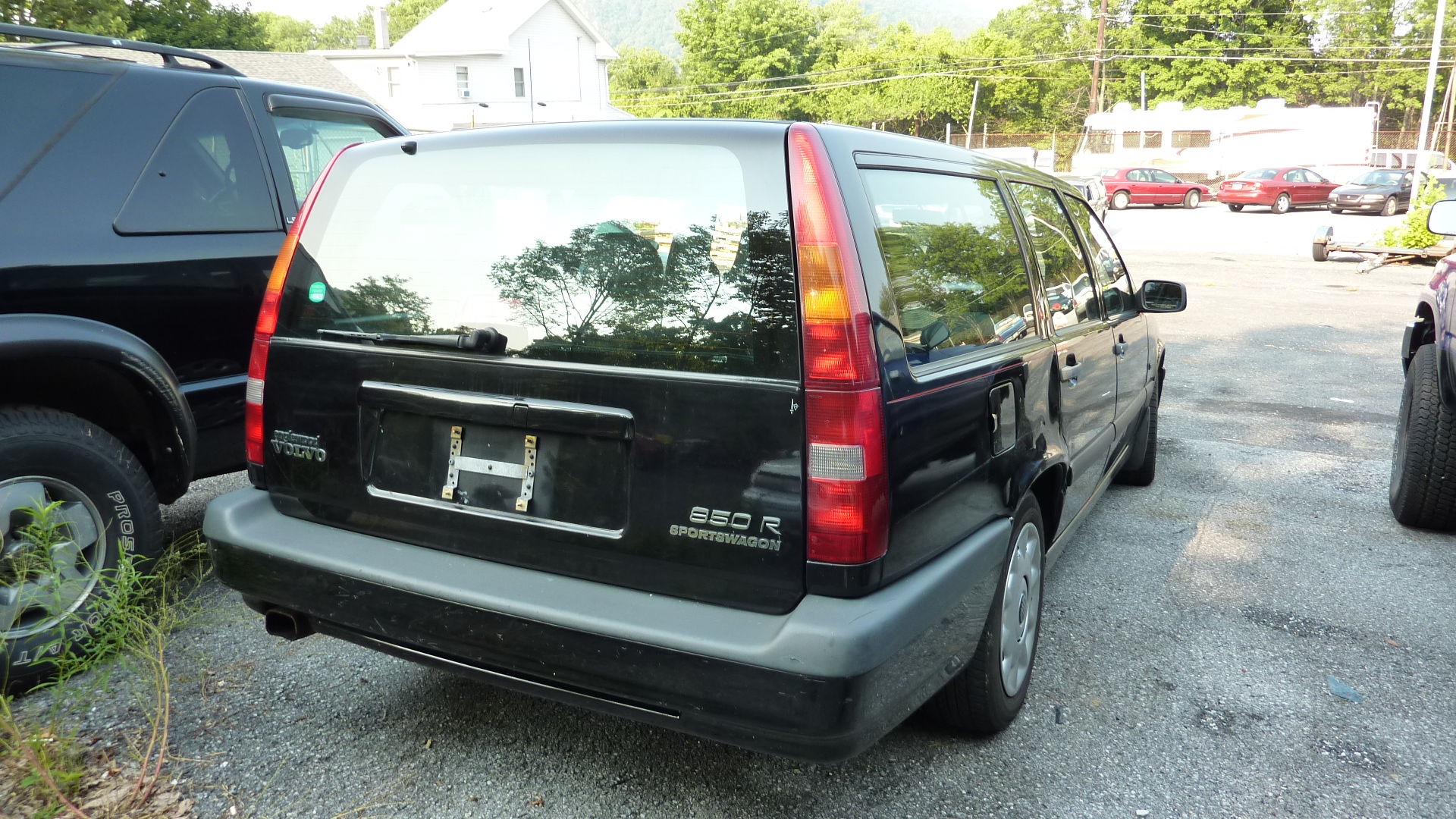

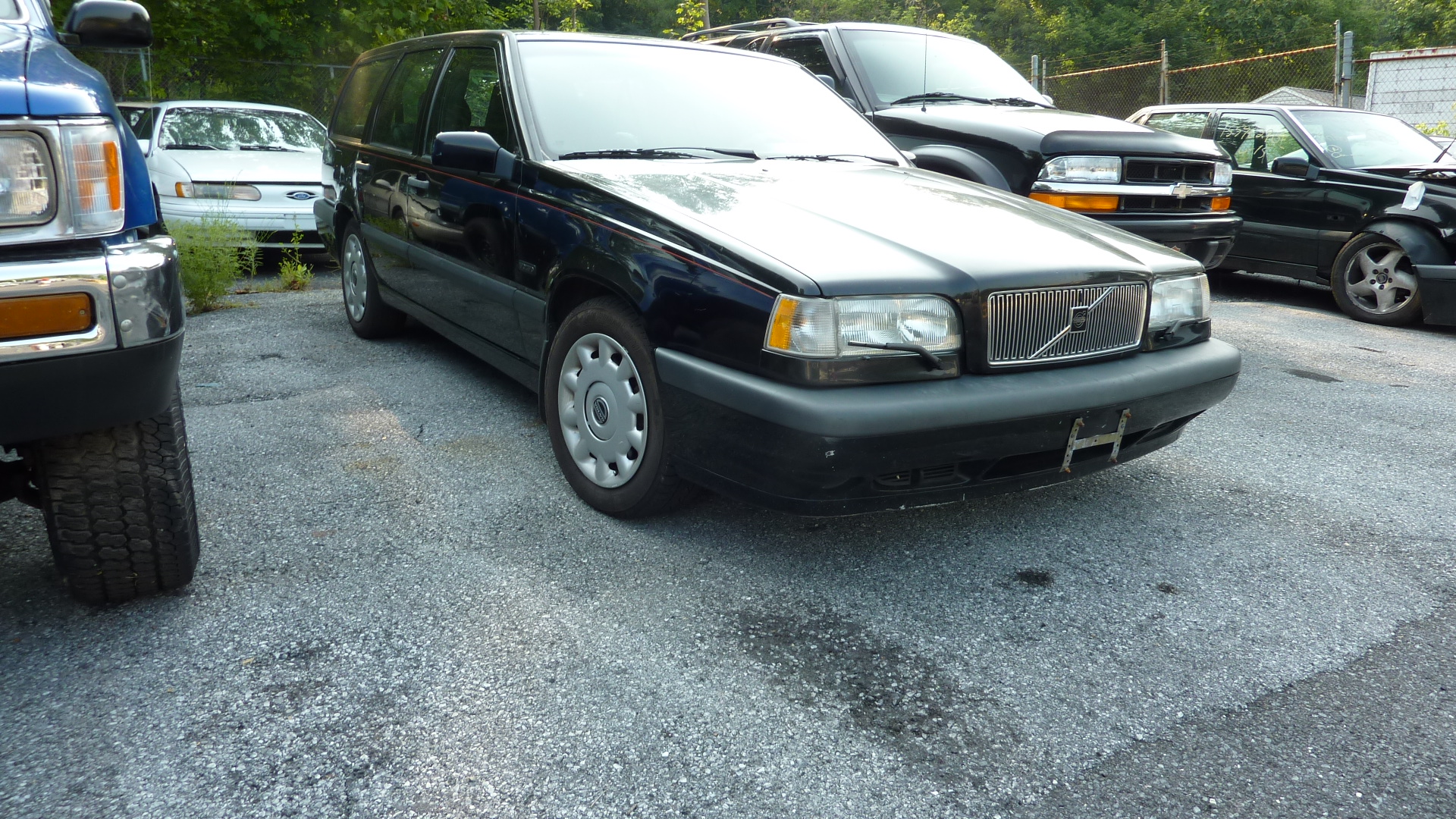

Sportswagon R 5th cylinder has no compression, mechanic (s) say take the high road and replace the engine? Seems like a shame to waste one with only 95K miles. I have a wrecked 850R but the mileage is over 200K .
