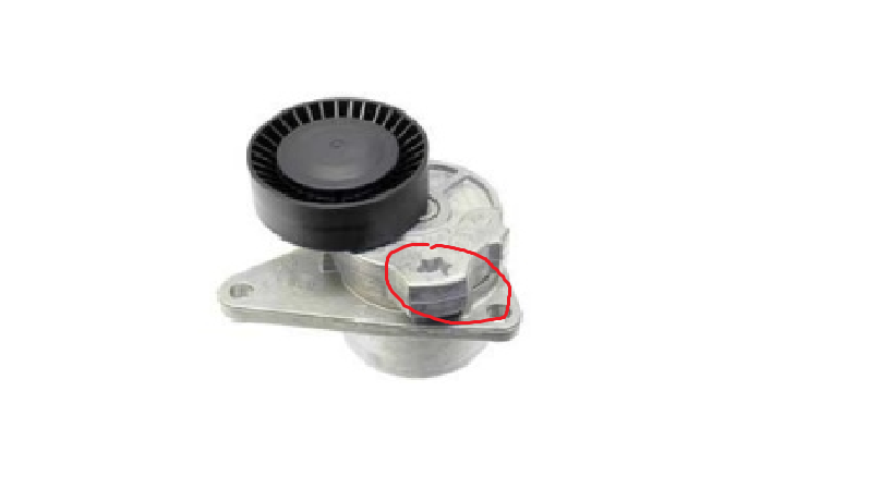

Thanks for your help and advise. The problem I am having is that in order to remove the serpentine belt I need to use a male
star type bit that fits into the belt tension mechanism. I have seen tools on line that are slim enough to fit between the belt
and the side of the vehicle but none come with the star bit. I purchased a torx t 60 bit that fits into the "female" star on the tension mechanism but am unable to use it because once attached to a ratchet it is too large to fit into the star. I even inserted the torx star bit into the belt tension release and then attempted to attach the ratchet but there was not enough room.
There is a box on the fender wall that houses what appears to be some type of plug in computer module. If I could remove that box I would have plenty of room but do not want to cause further problems by attempting to remove this box, especially if it
has computer modules in it.
By the way, this 2001 Volvo was manufactured in Sweden. Don't know if that makes a difference but in most comments about
this situation people keep referring to usage of a 15 mm or 16mm socket to release the belt.
Again, looking for the star type of tool that is used to release the belt tension mechanism so I can get the serpentine belt off and on.

Please post a picture. Very unusual case.
If needed buy a torx bit and use a wrench to turn on the shaft of the torx bit.
Please post pic -concern is that you are on the wrong pulley.
ECM box can be removed but is better if not disturbed.

I am trying to upload a pic...in the meantime, here is the link that shows it. You can see the star in the middle. - rib

+1 jds60r could you insert the torx bit with an adaptor—say 3/8 x 1/2", then get a spanner wrench on the adaptor. That might buy you enough room to loosen it. Just a thought.

I see the pic. Thanks

Friends in S80 land advise me that your pulley has a black cap in the middle of it that is hiding a 14mm bolt. It pops off easily.
Mention was made of a 3/8 allen key fitting somewhere as well but I do not see where yet.
