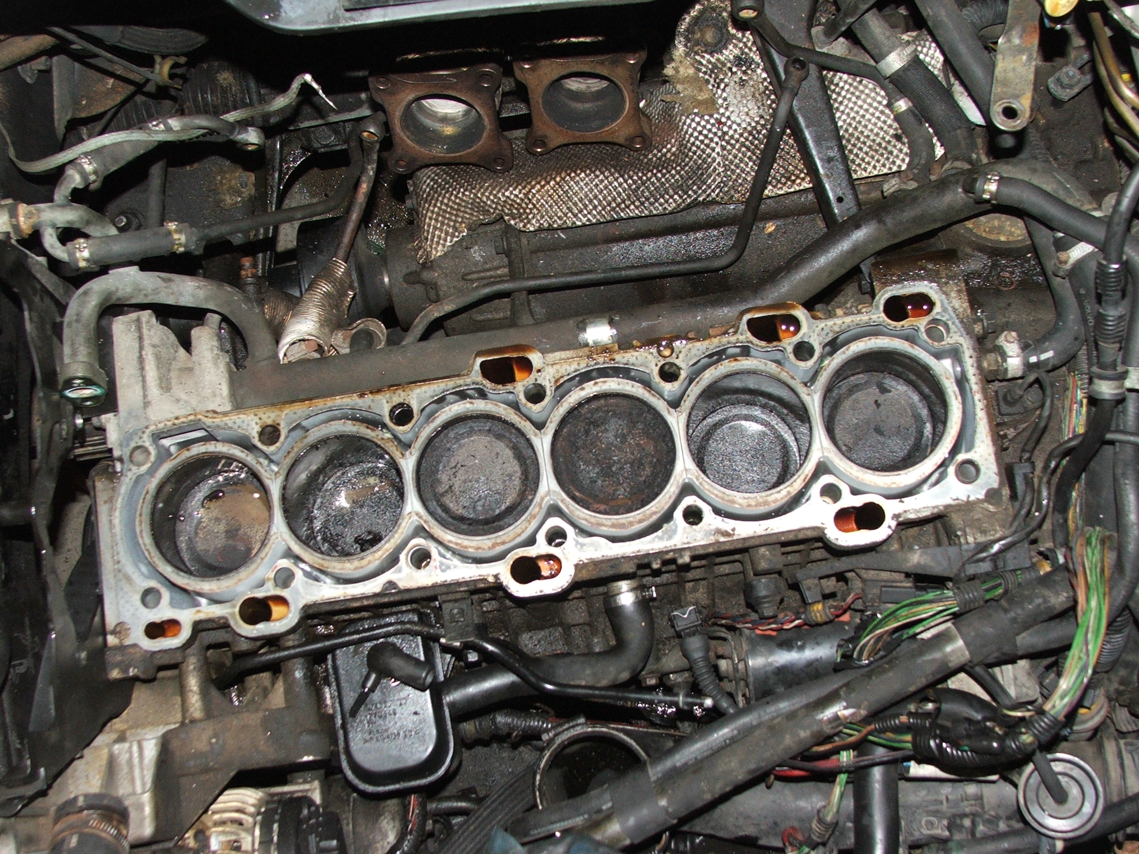

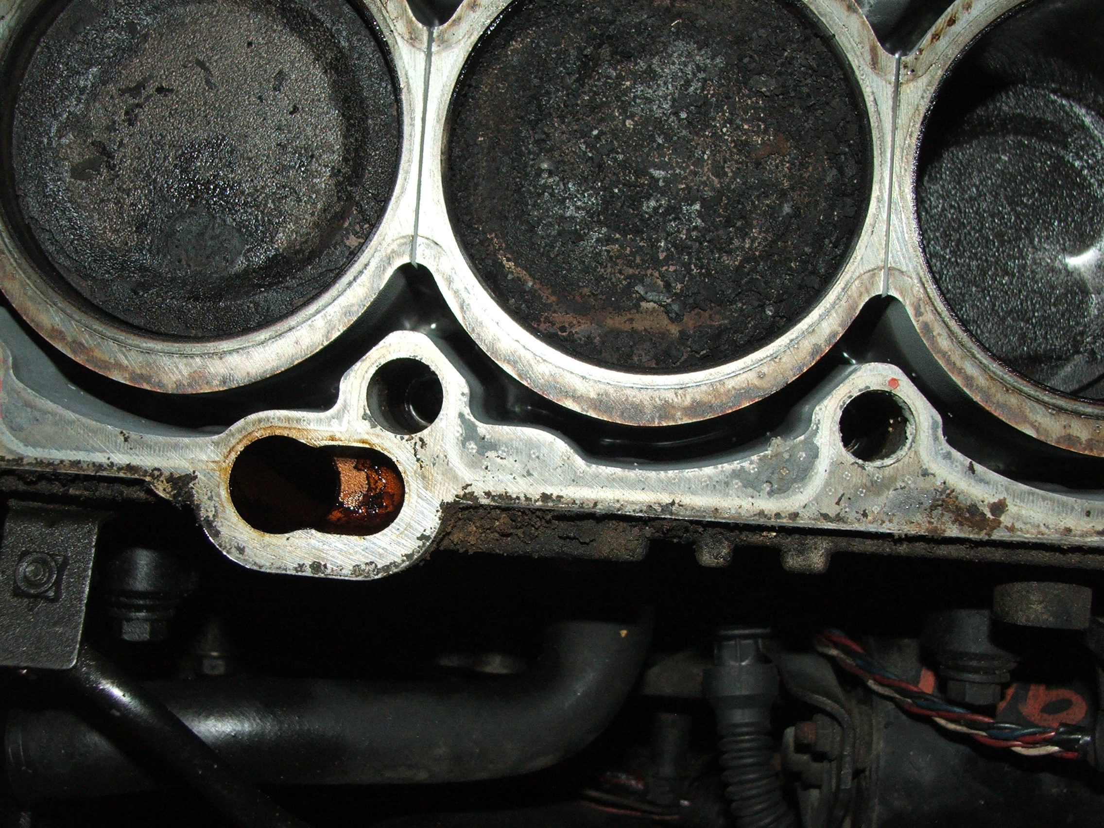

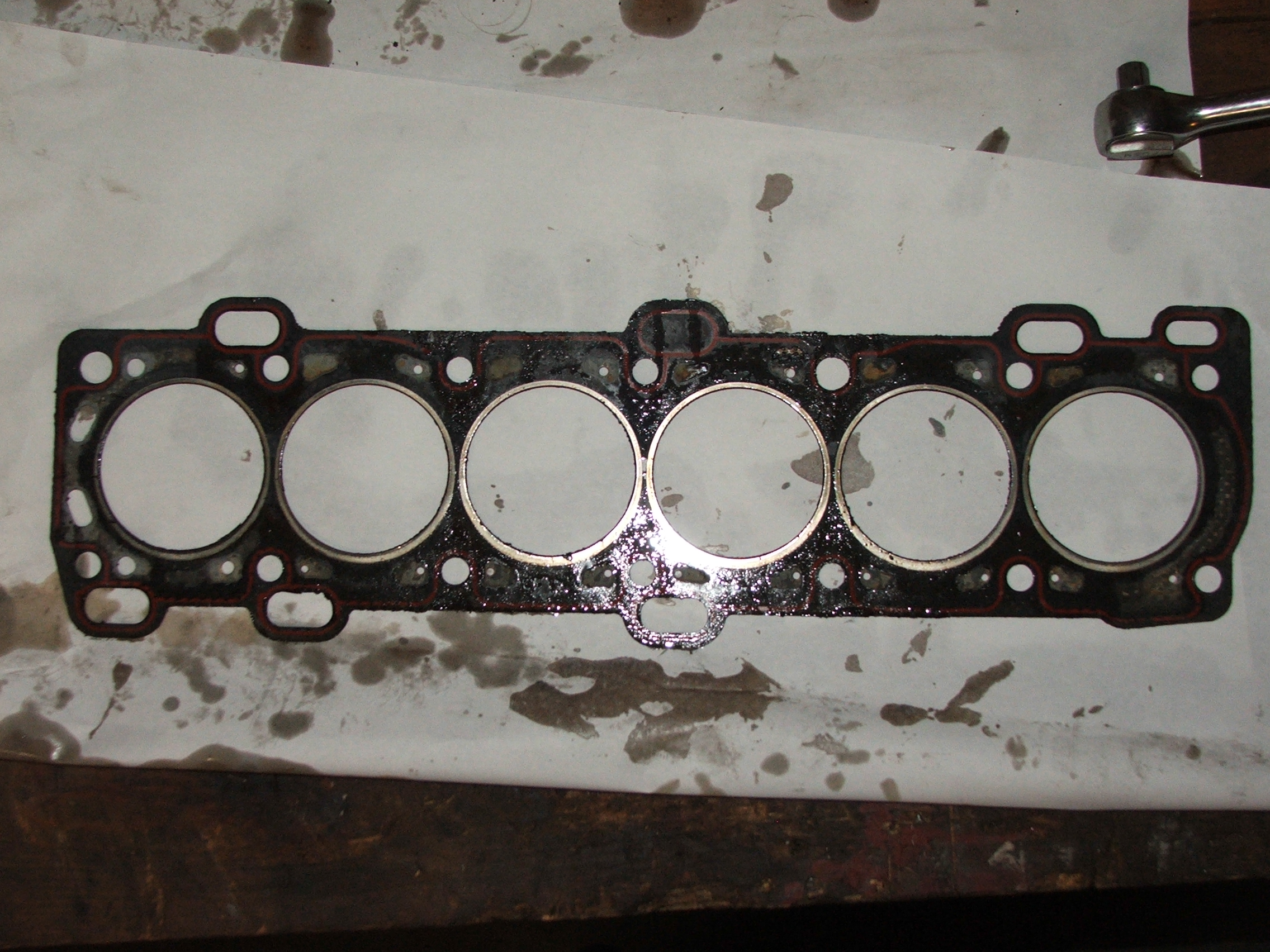

Alright so I've gotten the head off and its off being pressure tested today. Broke one of the bolts on the way out, but luckily it just about stayed in tact to come out in full. A lot more carbon on the head and pistons than I expected, especially on cyl #4. No signs of a leak that I can find, there is a small nick about 3mm long on the head and gasket by one of the cylinders, doesnt appear to be leaking there however. Doesnt appear to be any distortion on the head so fingers crossed. Now for some pics I have some of the head too but wont be able to post them until tonight.

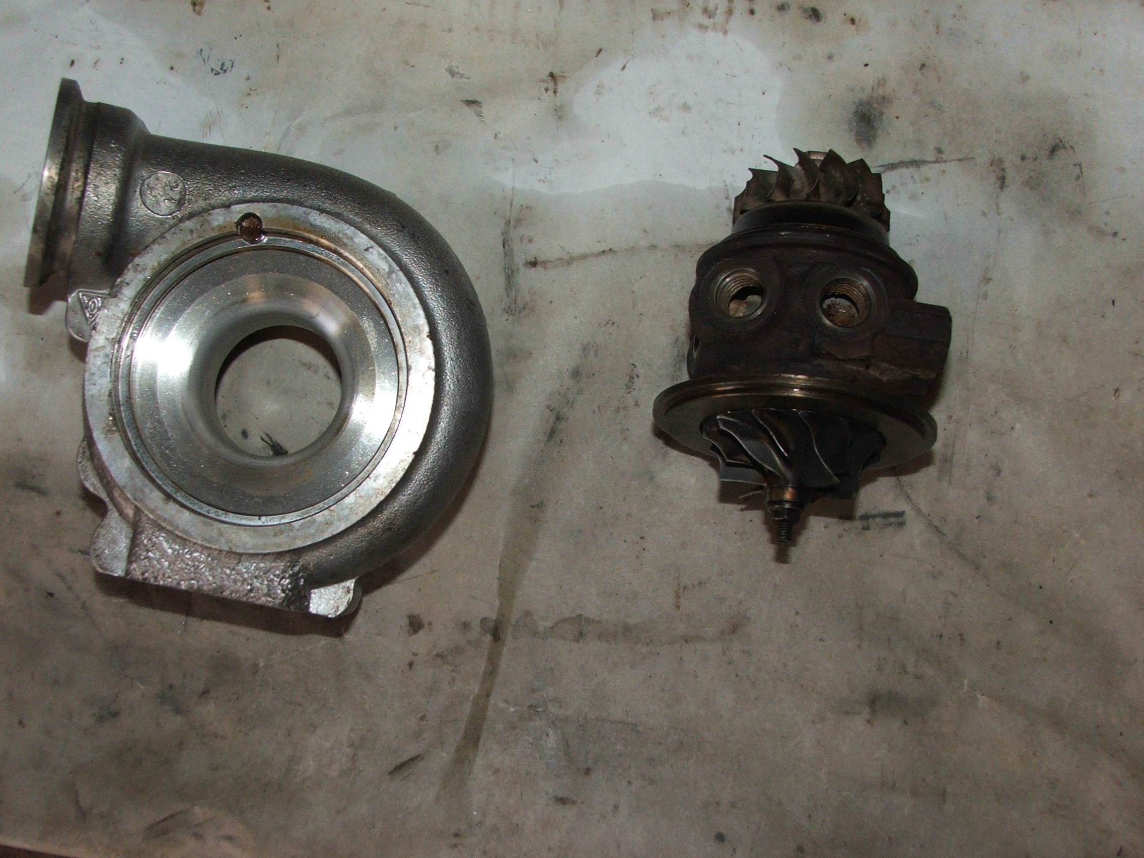

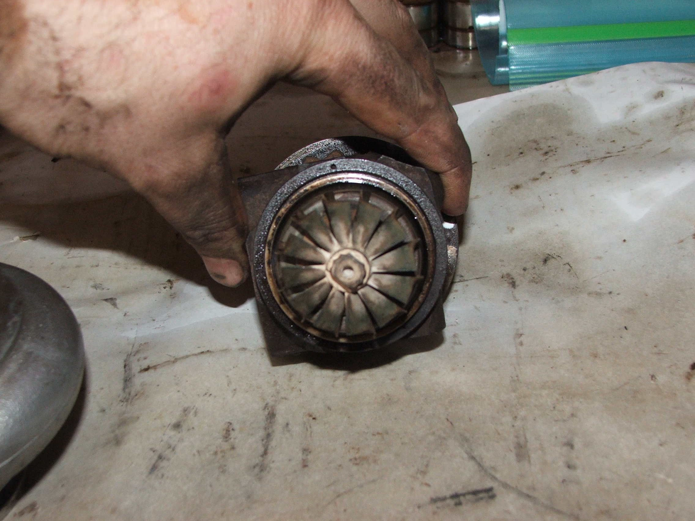

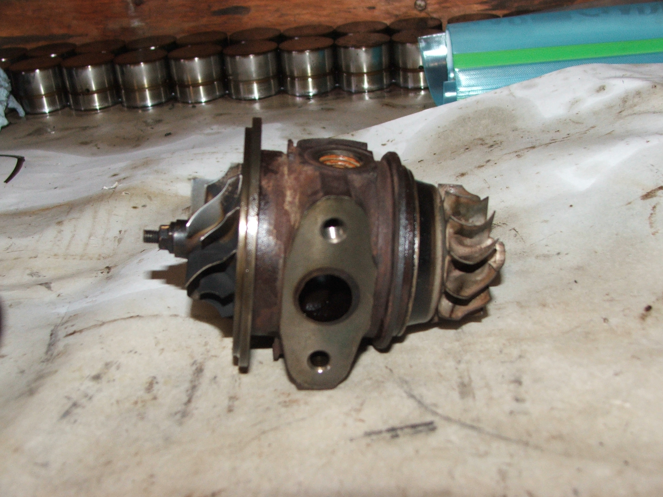

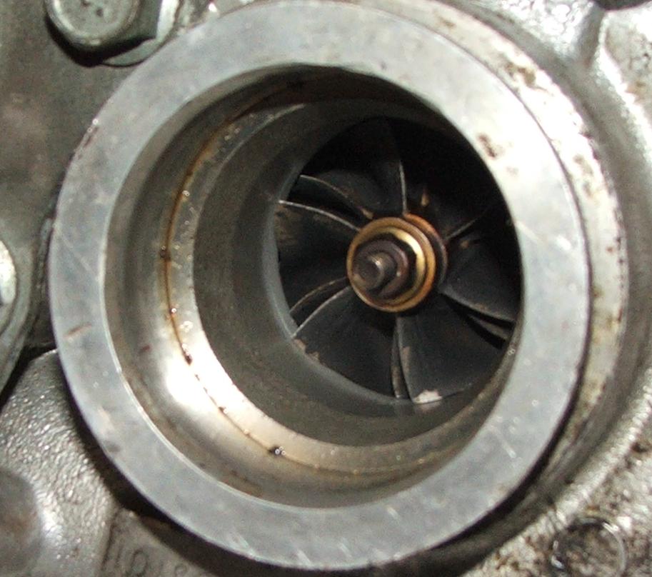

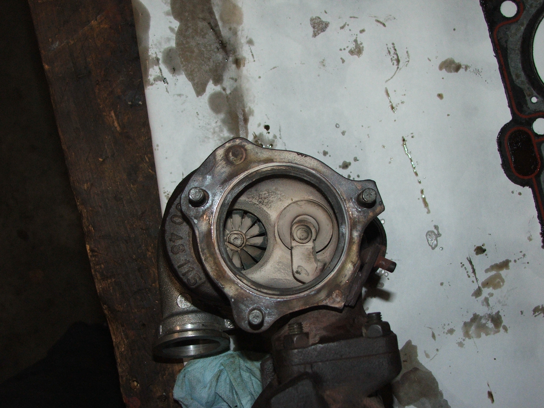

- Turbo 2 compressor side. Looks like contact with the housing? I wasnt able to make it contact by hand...I wonder if a temporal drop in oil pressire may have caused this?
- Turbo2Compressor.JPG (90.71 KiB) Viewed 3277 times

OK update.....
Head is back from the shop, cleaned and skimmed (was .007 out apparently).
Got the inlet manifold and ETM all cleaned up nice as well as the cylinder block and aluminum turbo piping.
Most of the carbon cleared off the piston crowns (was nearly 1.5mm think in some spots!).
Valve cover cleaned up, but I think I might get it steam cleaned to get all the crud off.

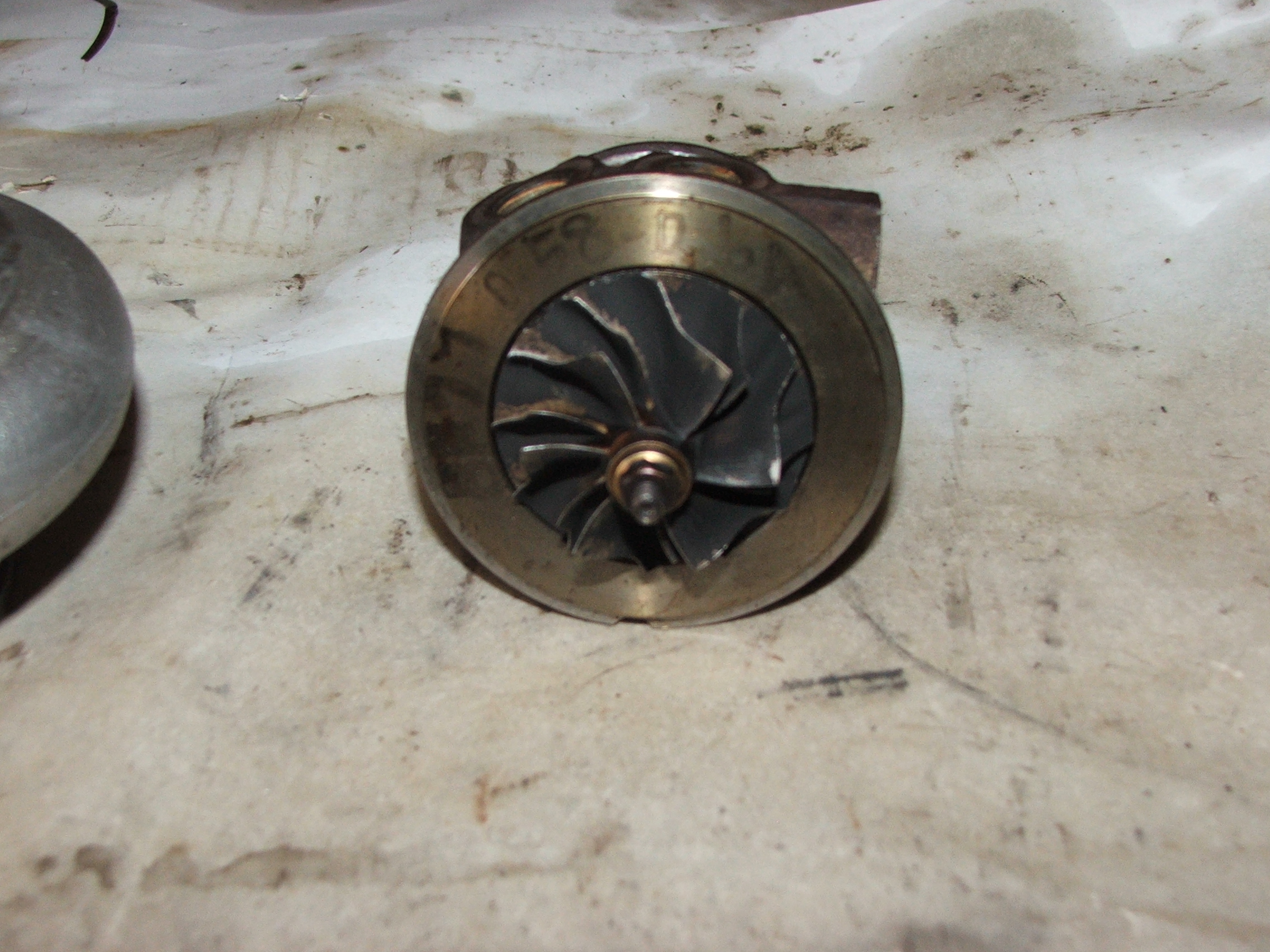

Think I might hold off on rebuilding the turbos, i pulled apart #2 and it has writing on it like it has already been rebuilt. My theory is that the compressor wheel hit the housing before my ownership and was rebuild. The wheel looks fine. Heres some pics. This is how turbo #2 looked before cleaning....Looks pretty damn good to me.
Any ideas on how much radial and axial play is permissible on these TD03-8G turbos?
According to their staff, this kit is suppsedly compaible with the turbos in the T6 (SKMTD03TF035): http://baeturbosystems.com/turboservice ... ent-2.aspx
