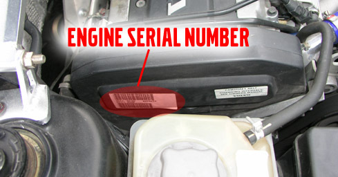

You'll have to forgive me but I'm an engine novice - can you please give me a little more detail as to where the engine code is? I've always thought it was a non-turbo engine. Are there any other clues that might tell me differently? Thanks for your help.

Finding the engine ID code
Open Hood
Look to left ( passenger side)
Go to passenger side front wheel
Look at side of motor
Plastic cover is on this side of motor
White 1.25 in x 1 inch sticker is on this cover about 3 inches down from the top and has engine code and a bar code.
We just need the engine code.
Retired

Post by JDS60R »
or just send me your VIN

Post by JDS60R »
see pic
