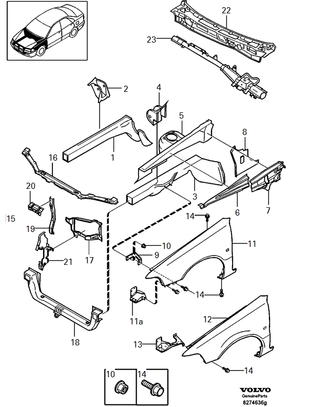

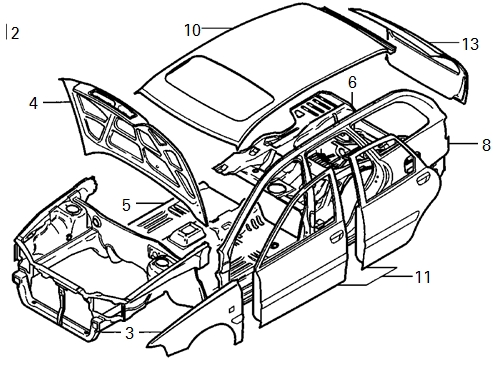

Here are some screenshots from VADIS (Parts Catalogue/Body section) I hope they will help you find out how the front section was build:
GOOD LUCK
