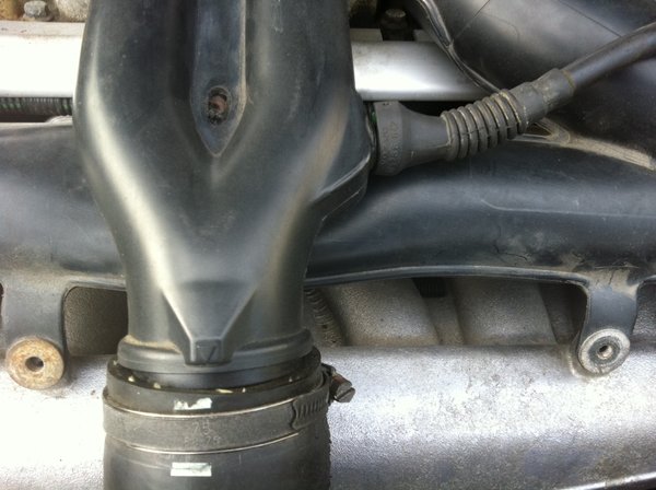

bolts for turbo assembly on 2002 s80t6
There are 3 holes on the large plastic turbo manifolds that appear to be where it is attached to the top of the engine block (car is at home, I can take a picture laterif necessary) No screws or bolts are in them, Does anyone know the part number for these, can I use another bolt to attach or am I better off leaving it alone (no shaking occurring but I obviously can't see whrn the car is moving). thanks

You can use the proper thread and length bolts but if they are the very commonly used 7mm thread size you may have a hard time finding them except at a NAPA or a bolt supply company.

In my 2000 S80 T6 all three screws are identical: M5 x 20 mm with T-25 head. Any M5 screws of appropriate length would work just fine -- you can buy them at any auto parts store or at HomeDepot/Loews. For the central screw, Volvo part number is 965175. For the side screws, it's 969408.
