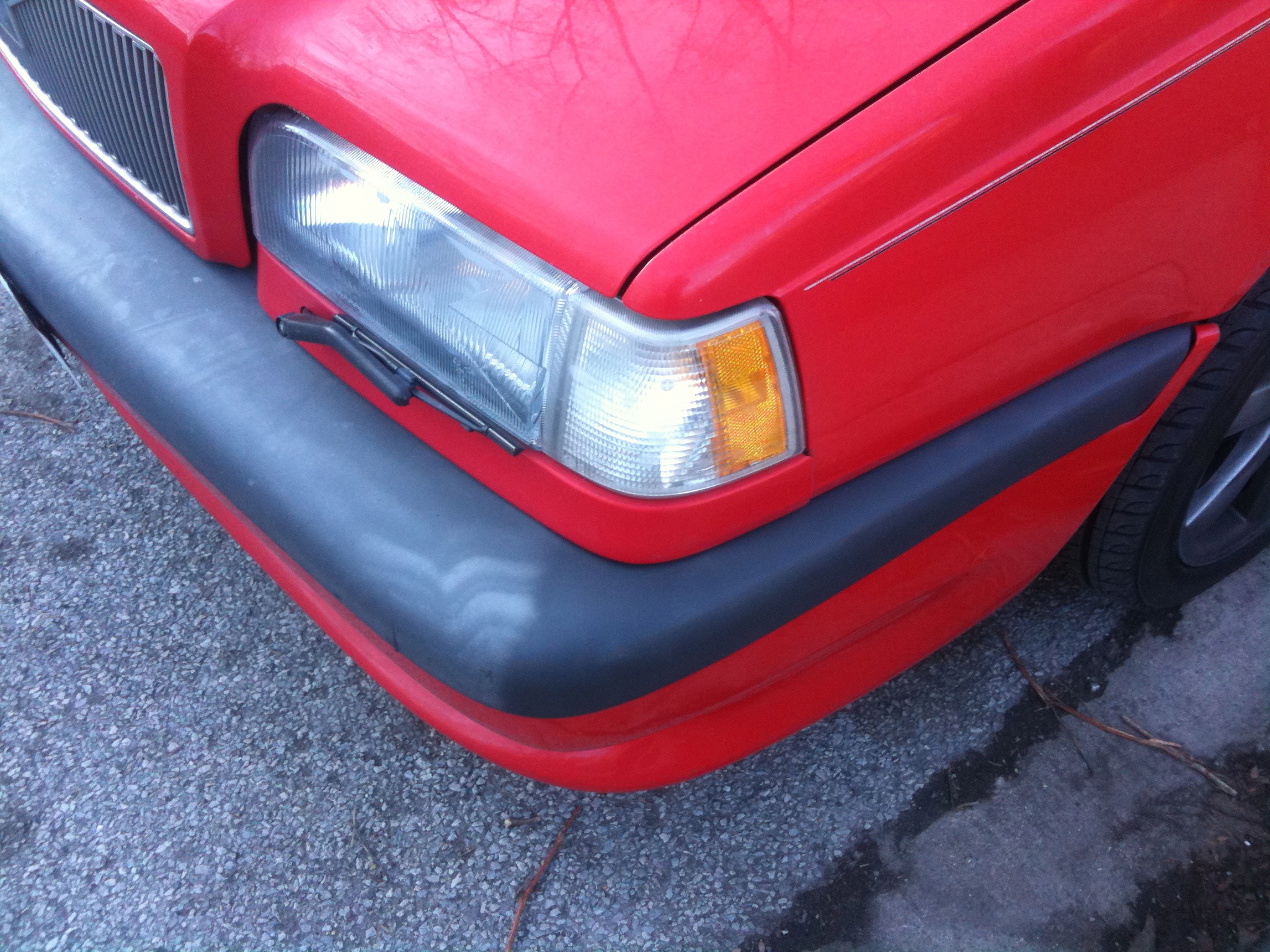

I learned a trick the other day for restoring our faded grey bumpers. Using a heat gun will bring the dark grey back to the surface. According to what I've read, this will last ages longer than any other restoratives (Mother's Back to Black, dyes, etc.). I don't have long term results, but here's a picture of my front bumper with just the fender side done:

I used low at first, but it was taking way long. I used high and things started moving along much nicer. This video was shot with the gun on the high setting and you can see how well that works. Doing it on a warm day makes it MUCH easier and produces a more even result. I kept the gun about 1-3 inches from the plastic and used a piece of cardboard as a shield for the paint - the cardboard started browning after a while!
I read about painting the bumpers, but I just don't want to deal with flaking or anything else down the road AND I really like the original look.

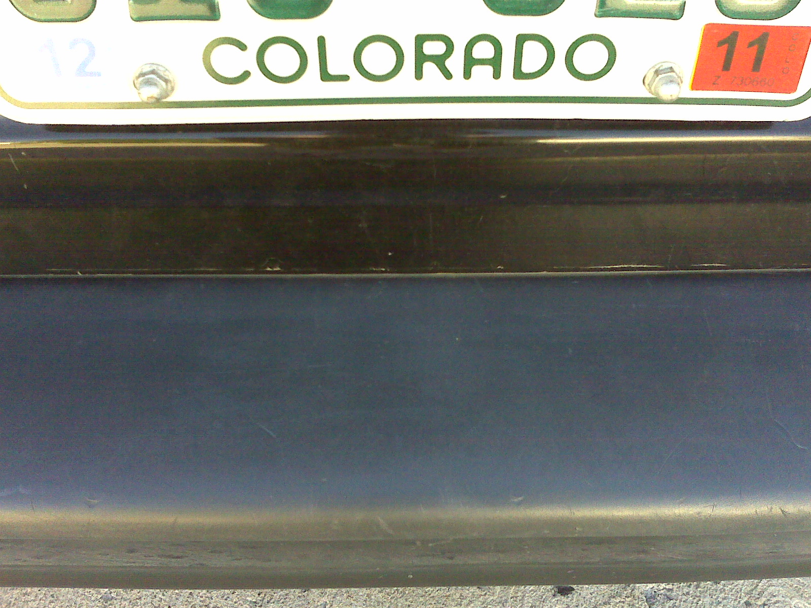

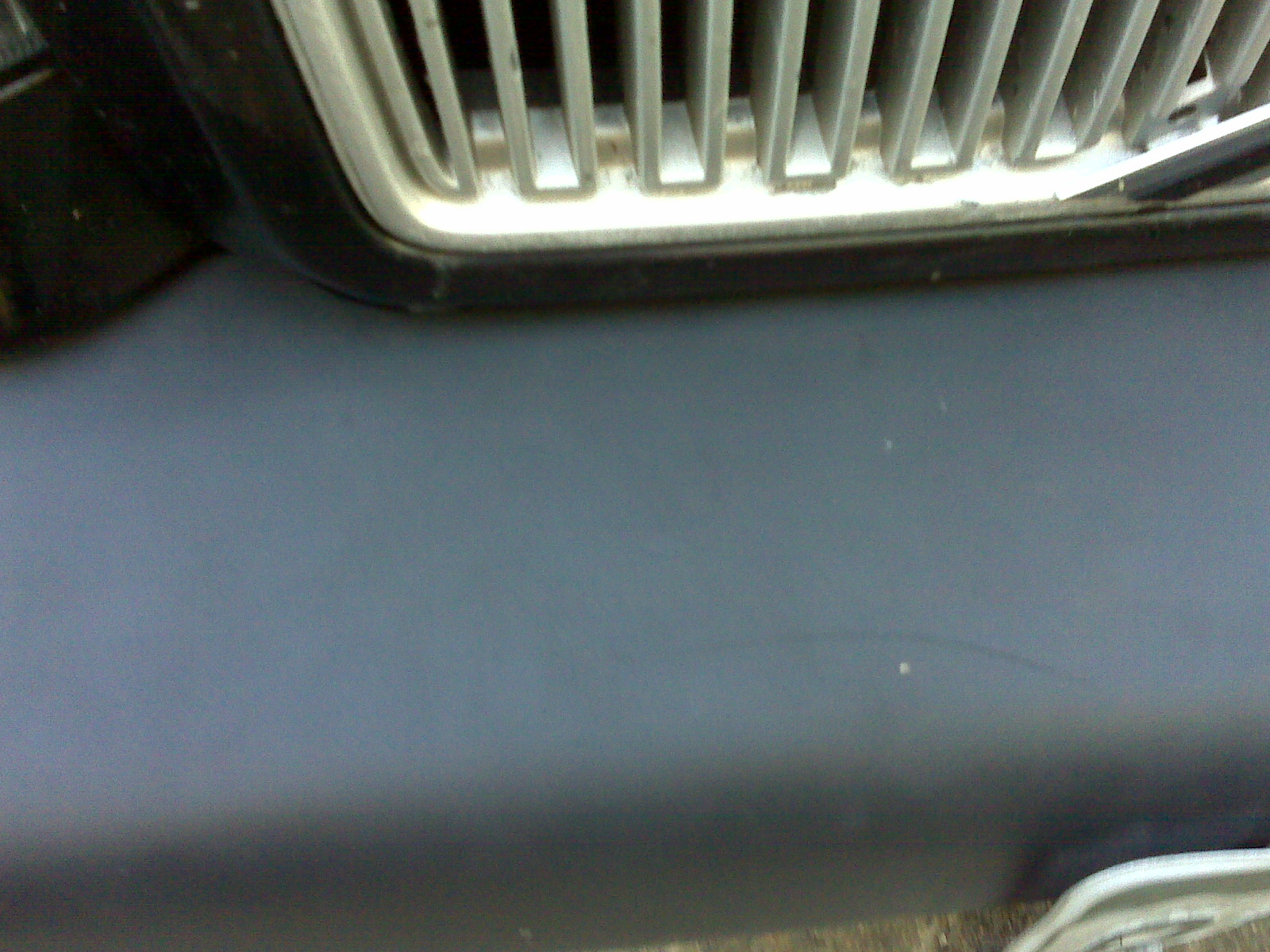

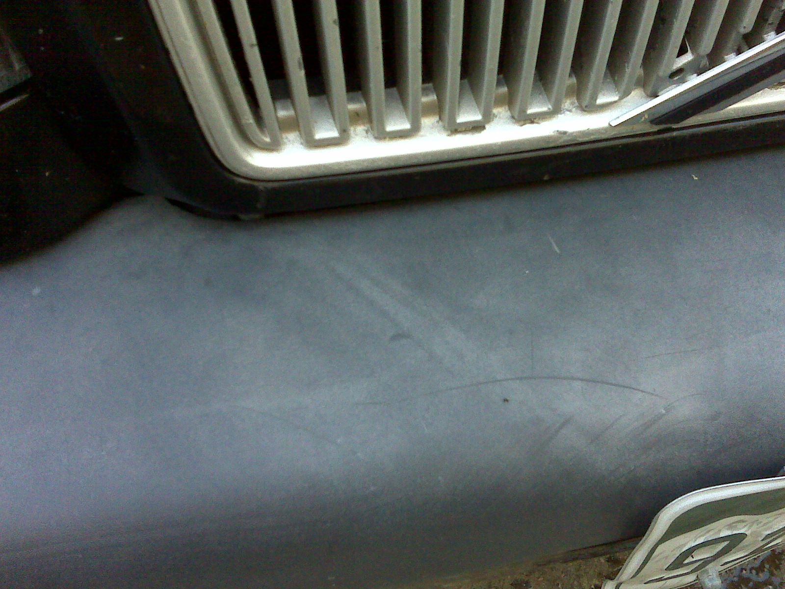

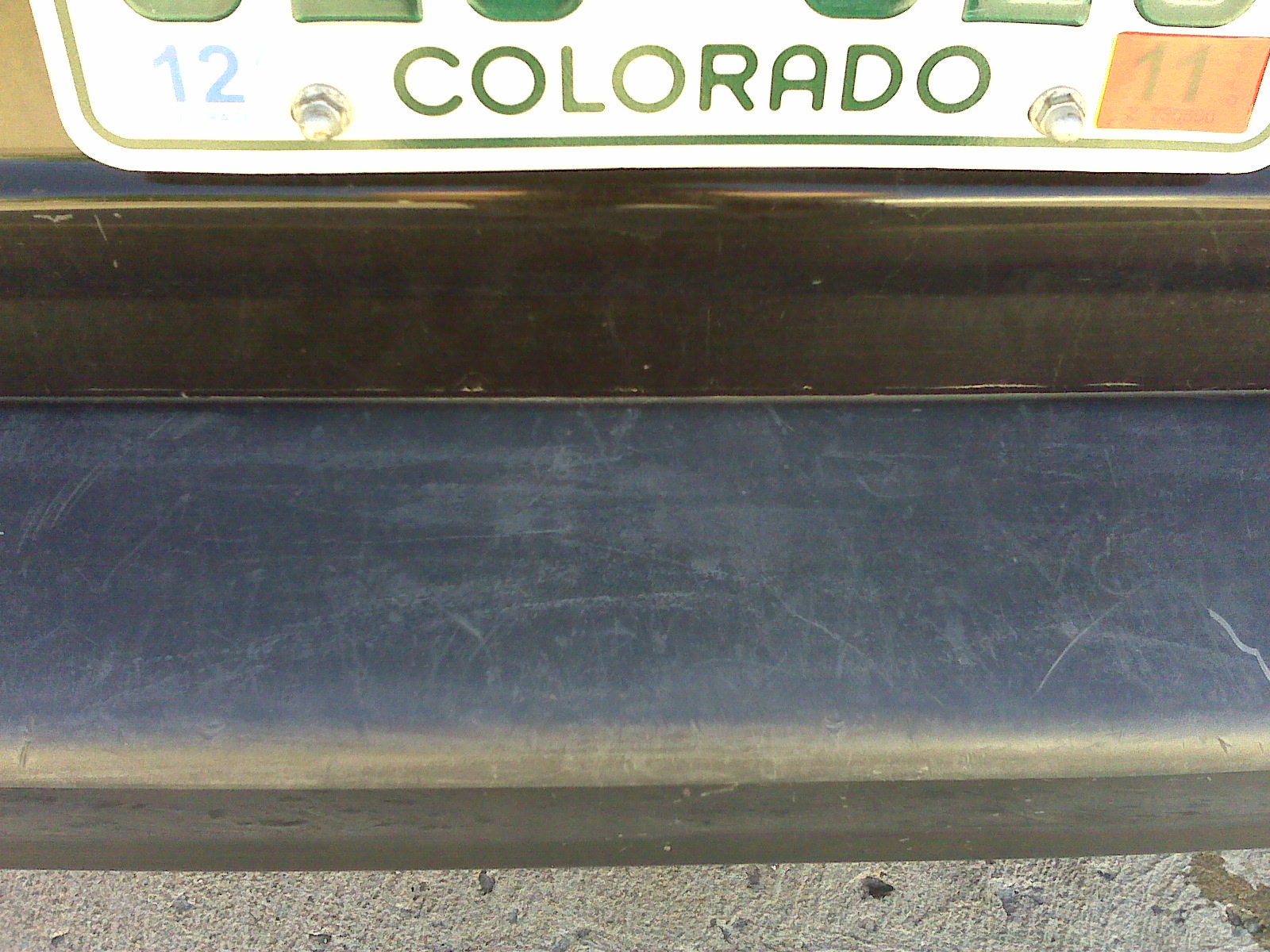

Here's some pics of my results
Not new by any means, but definitely much better
