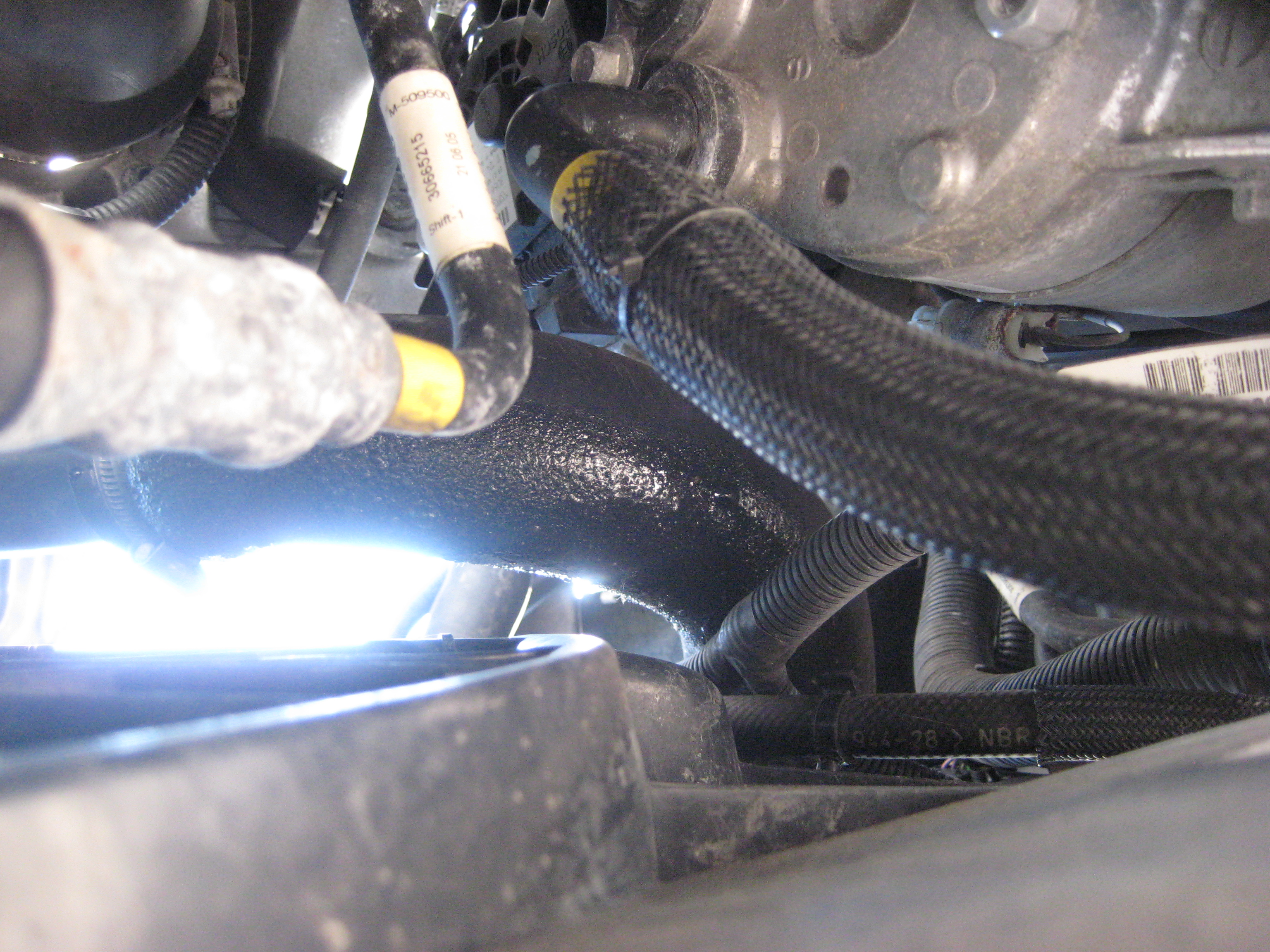

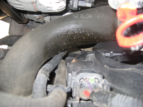

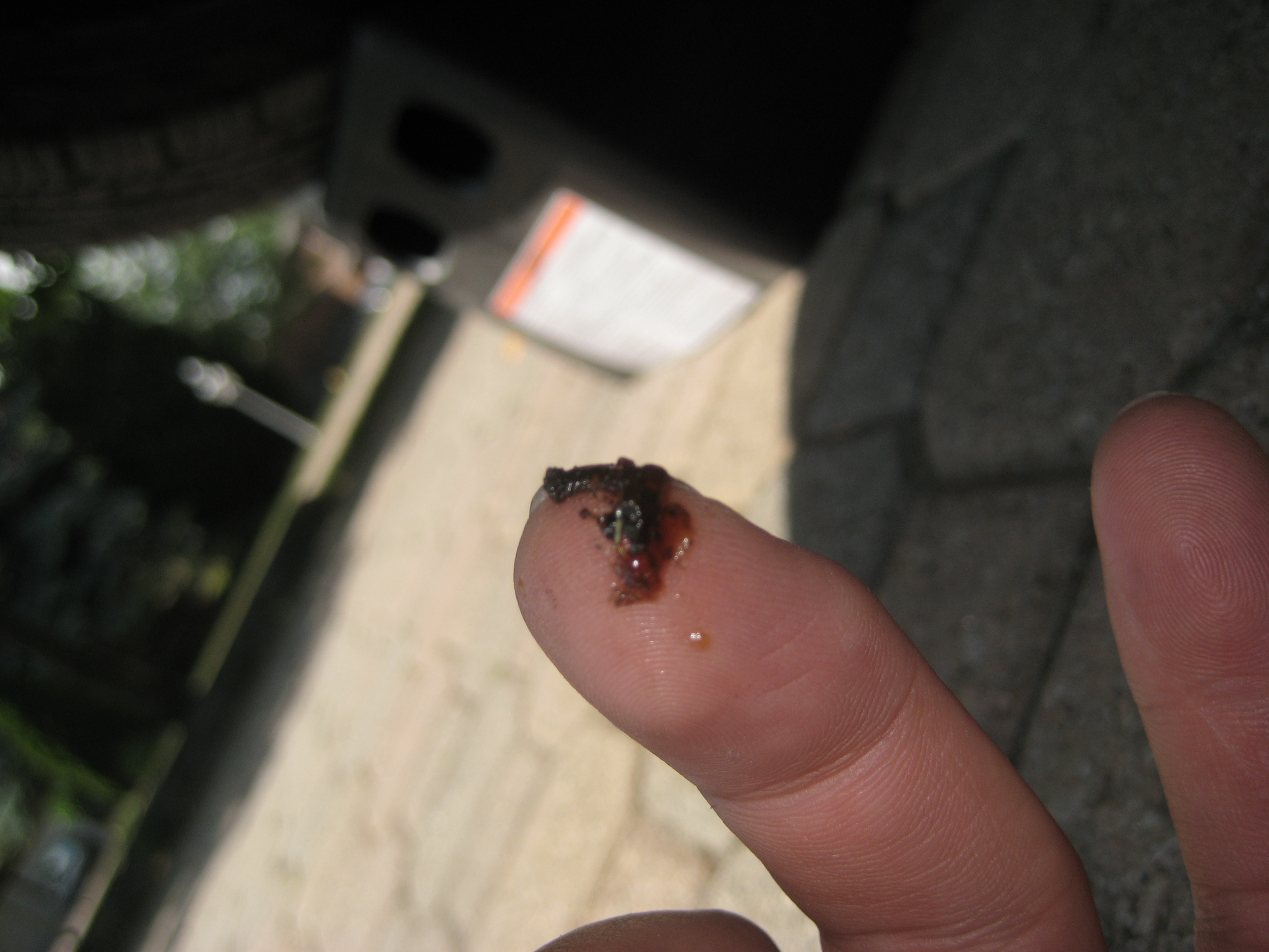

found this oily ,sticky glue type, brown in color thing on upper radiator host...what the heck is it?! anyone?
bottom view
bottom view

That is the intercooler hose and some oil from crankcase vent system condenses and collects there. The hose has some porosity with age and the oil gets through. The rubber from the hose deteriorating makes it gooey.

jimmy57 wrote:That is the intercooler hose and some oil from crankcase vent system condenses and collects there. The hose has some porosity with age and the oil gets through. The rubber from the hose deteriorating makes it gooey.
thank you for your detailed explanation, you totally explained everything... :D
