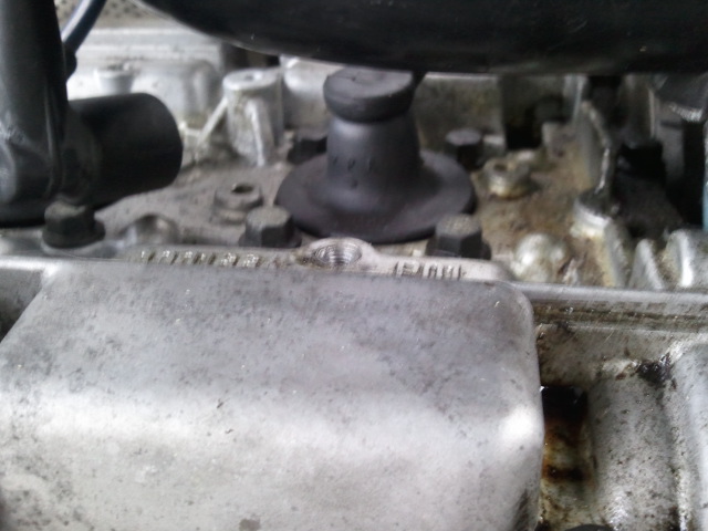

I could see oil on the block towards the rear and about half way around the cam and where it dripped below under TB.

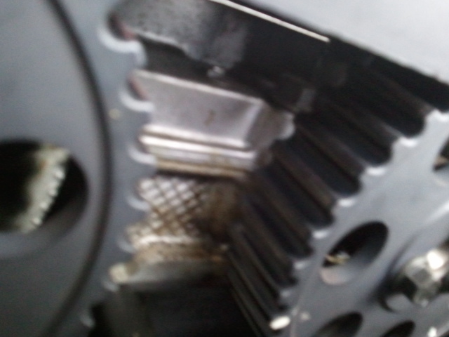

Once I had the driver side of cam more exposed I could see this. There had been more oil around and inside that I cleaned up while getting to it.

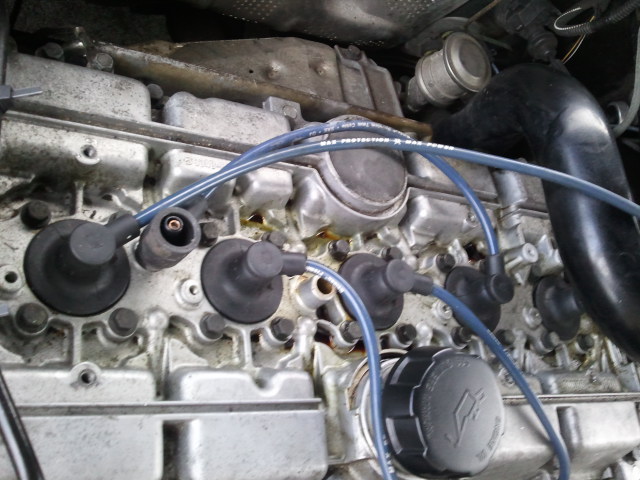

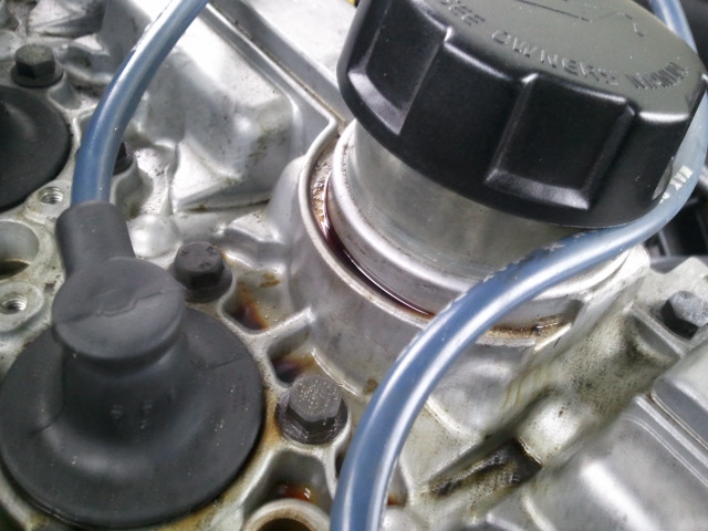

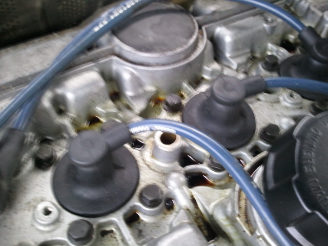

Then I took a more careful look at the top and saw darker areas of oil(old and dry) inside the groove around the oil cap that runs all the way from left to right, emptying above both cams.
I had already looked at the cap, which seemed fine. This time I took the seal out and it had plenty small cracks and easily fell apart in my hand.
Could just a cap leak cause this much leak and could it run all the way down both sides of the engine, spraying the back? I'm thinkin yes, but anybody seen this? The cover really never had much in the way of oil on it.

It looks to me like it could. I have a leaky oil cap & lifted the O ring slightly revealing the small cracks. I haven't had the cover off, but a fair amount of oil tracks along the groove just underneath. Just from your pictures it looks like the groove empties where the oil where the old oil has collected. I'm waiting for a new cap to arrive, but found that I lessened the leak by turning the cap around. I also found that it was a little tighter not turned to it's full turn. If it was me I'd just clean up the oil, put a new O ring or cap on, run around for a few days & see if that solves the problem first.

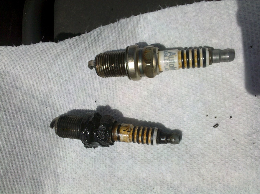

I had this same exact problem. I didn't realize it until the check engine light came on and it started trying to stall so i pulled off the cover and there was a lot of oil in all the grooves and it had also gotten into the spark plugs and ruined them. One of them looked like it was submerged in hershey's chocolate syrup. I replaced the cap with an aftermarket one from pepboys and it still seems to leak but I'm hoping that's only because it's a cheap aftermarket cap.
