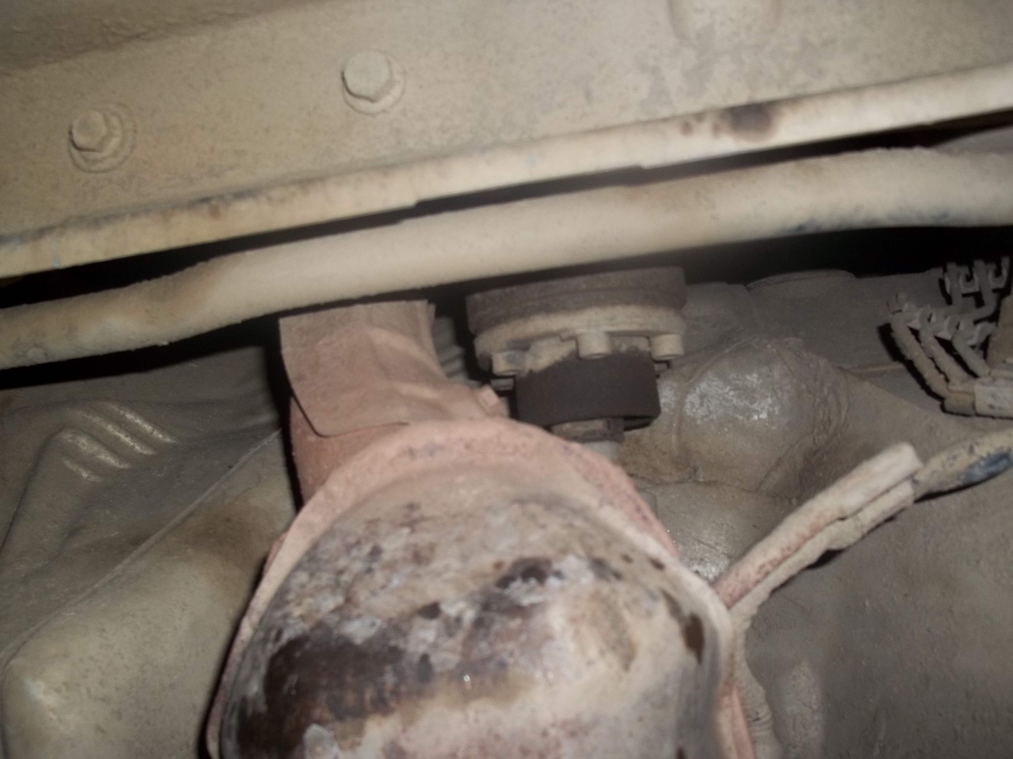

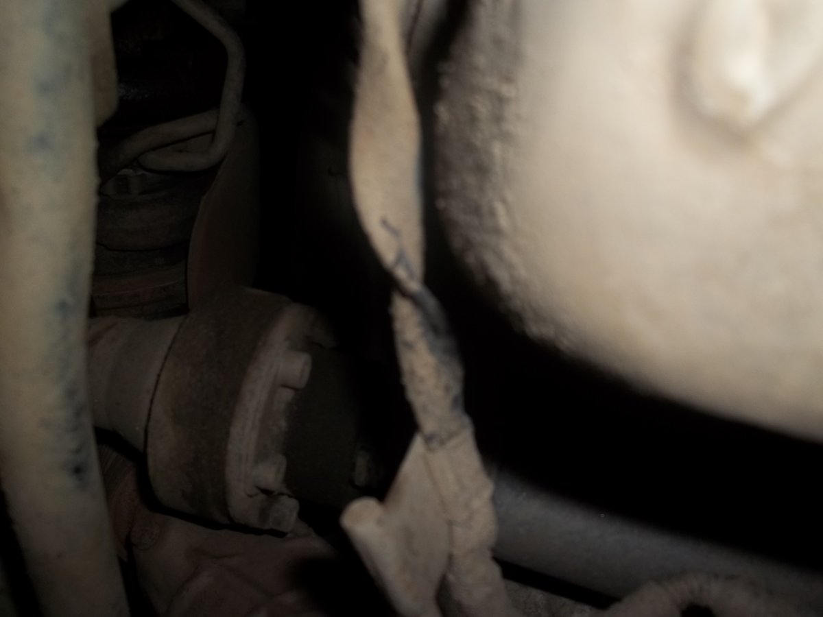

[img][img][/img][/img]I took the six bolts loose on either end of the shaft. Also the two bolts to release the bearing. Bearing seams good. The Boot is bad on the front. I was thinking of a boot that would go over the whole joint, but this boot is not very visibly. it is practically identical on either end. I have pictures I will try to upload. So, I now know that the front joint IS BAD. I guess I was just worried that it would be a problem in front of the joint. So, for now, I suppose I will shoot for a new shaft or just rebuild the front from colorado drive shaft. I live 40 miles from denver too, so I am hoping I can save some money on shipping!

Yeah, I called them today. I am sure that the front joint is bad. The bearing, U-joint, and back joint are all functioning. They do sell a kit to repair just the front joint for about $115 and will install it for you for $130 total. I think I read people on here finding the joint repair kit for over $200. The U-joint does seem kind of crusty, w/ no way to add grease. I will bring the shaft in and see what they think of the bearing and Ujoint. he quoted me at $400 for the shaft if I pick it up. They said they are selling them for $475 now. If I pay $400 it still saves me $350 from having the independent volvo mechanic do this for me.
