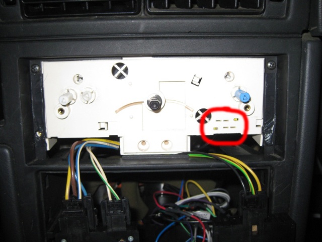

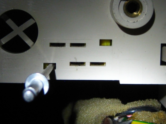

7. Disconnect the power connector at the lower right corner of the climate control panel.
There are locking tabs on the ends of the connector which need to be released; I used a stem from a pop rivet to get enough purchase on the tab to be able to release it. Reach inside and pull the connector from the back as you work each tab loose, working from side to side.

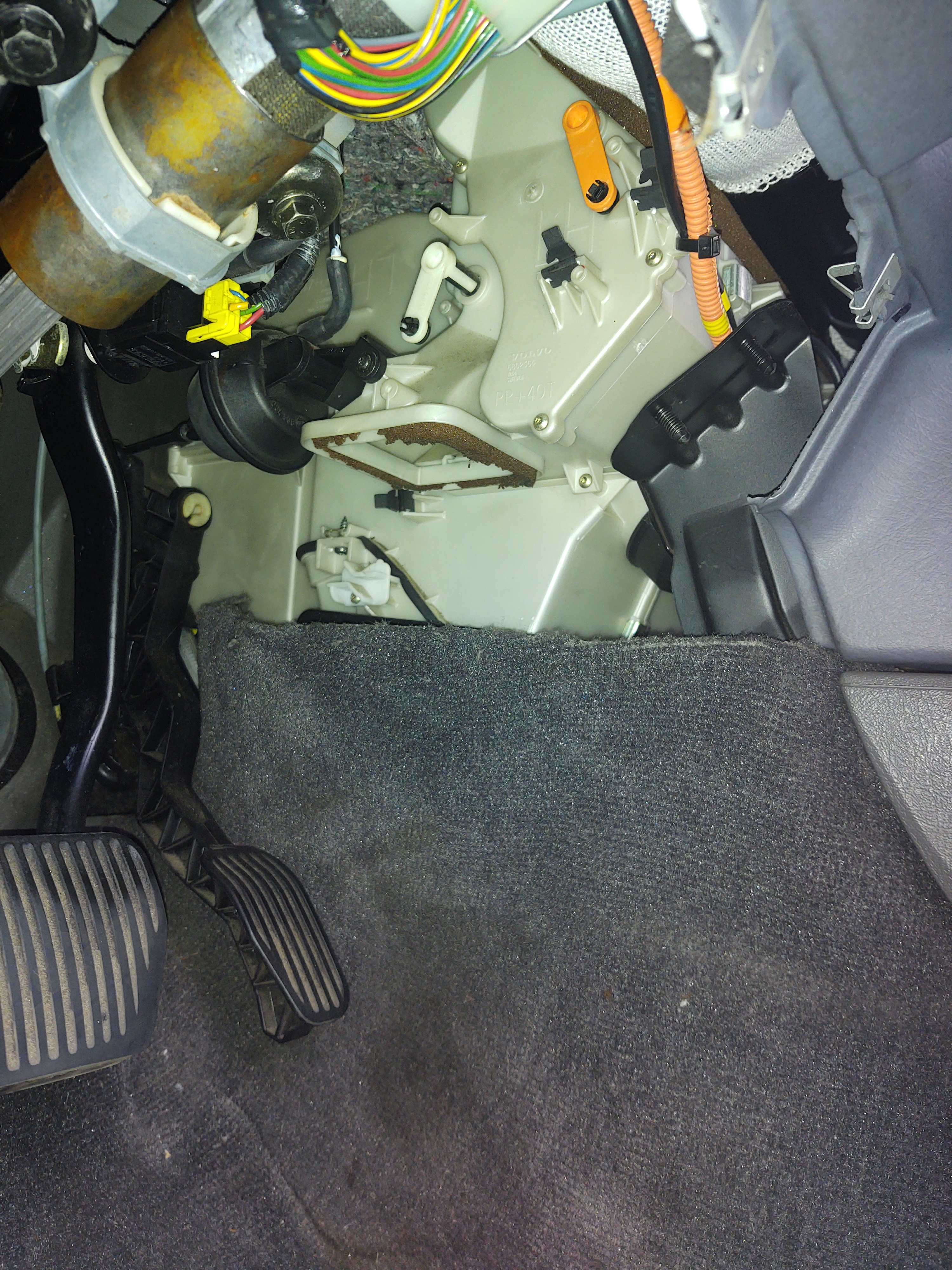

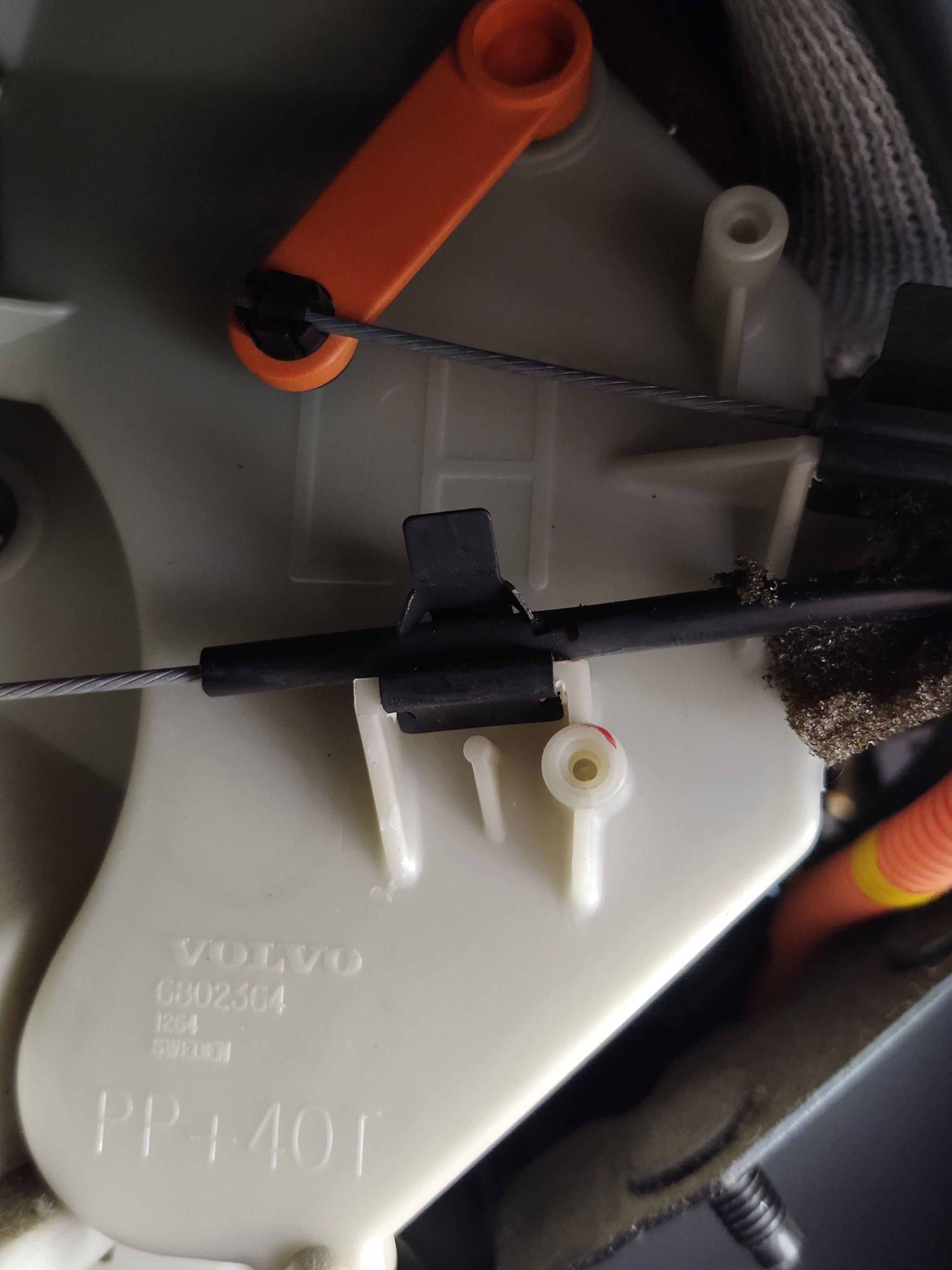

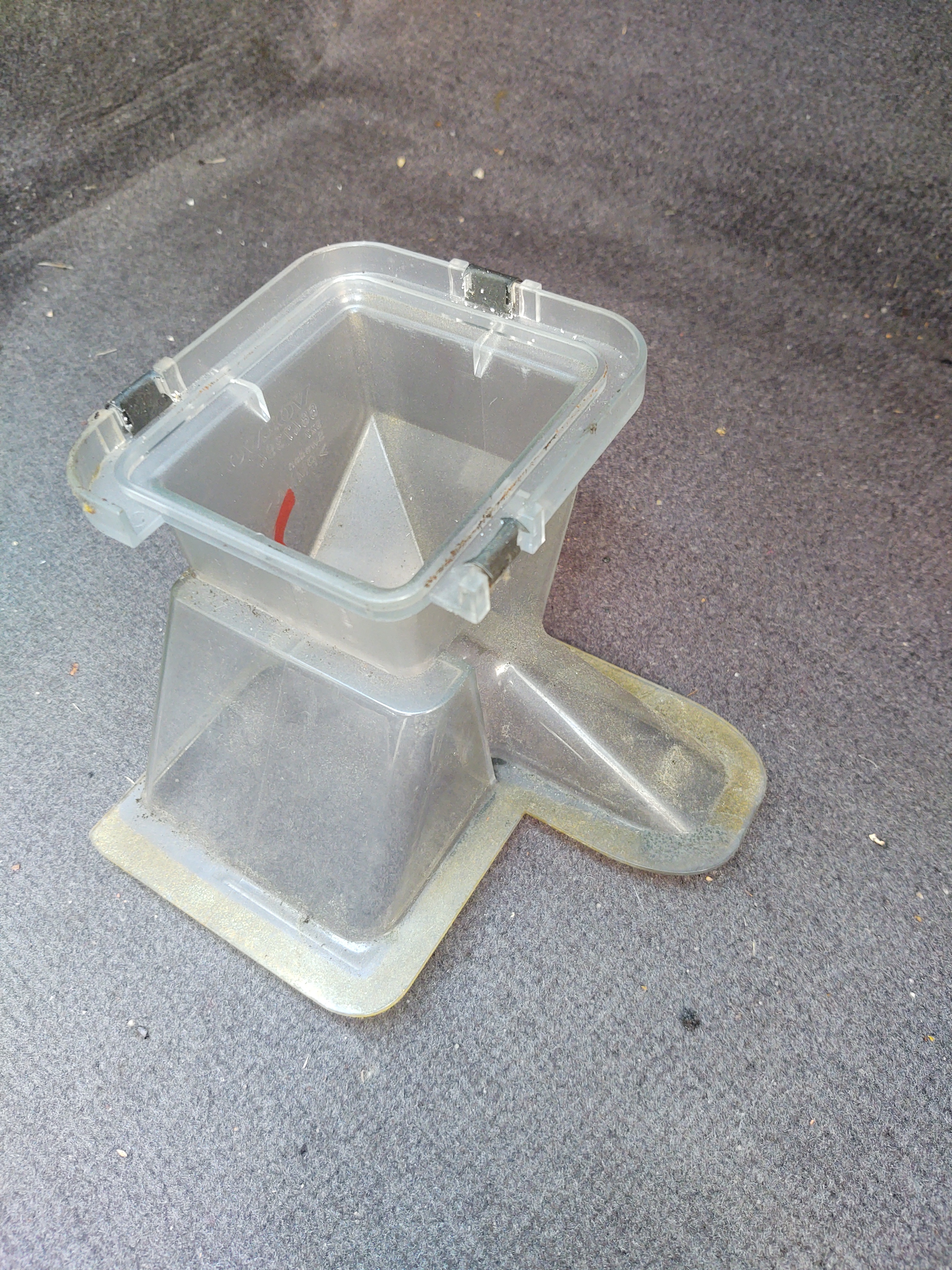

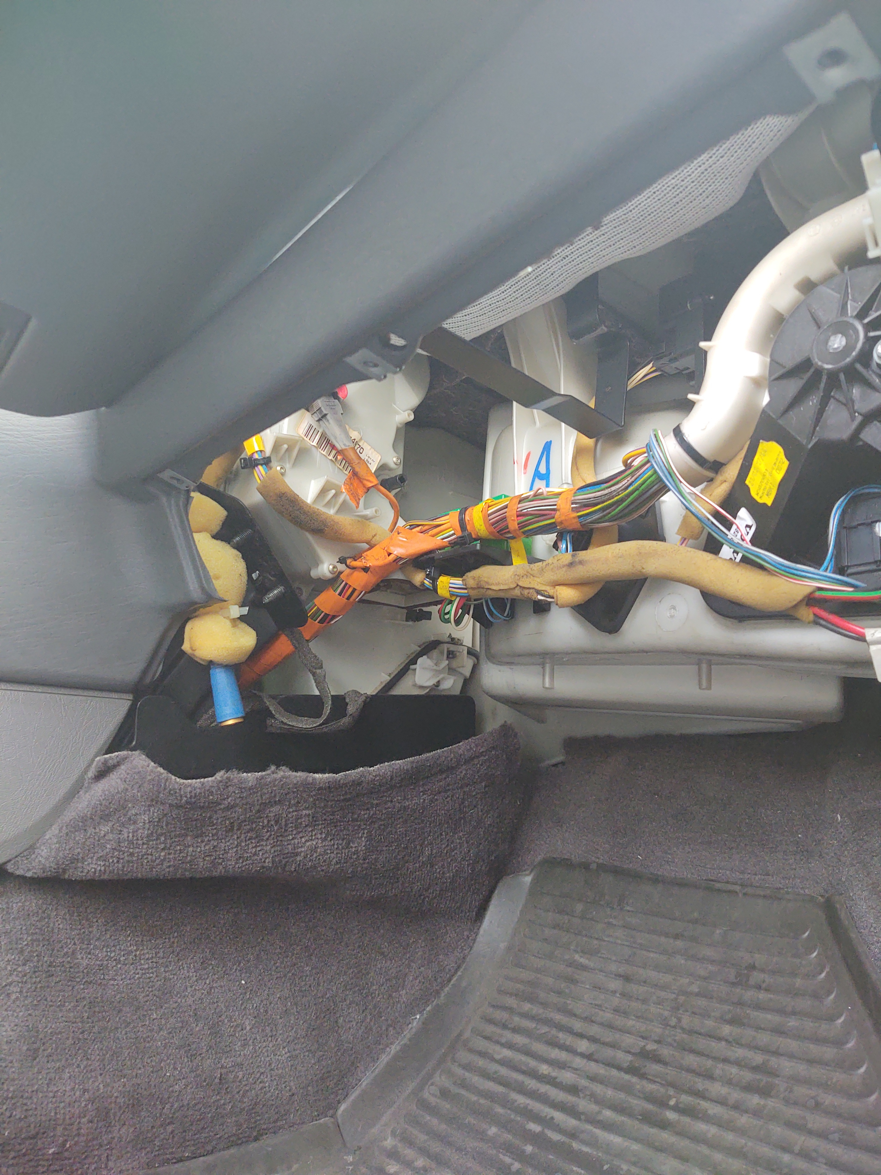

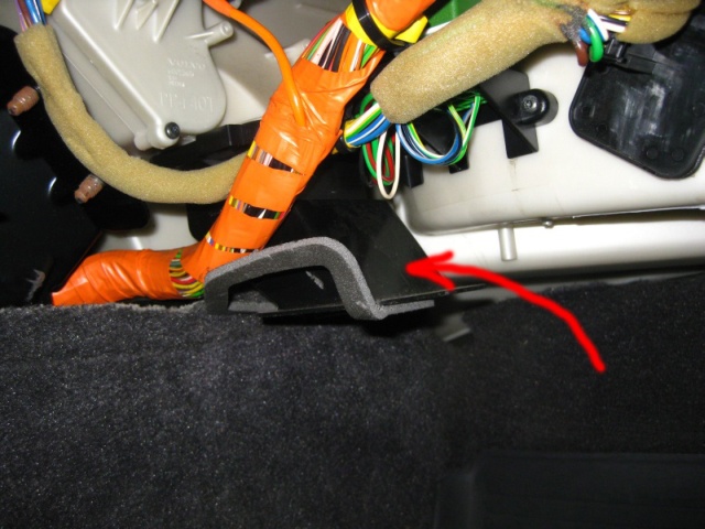

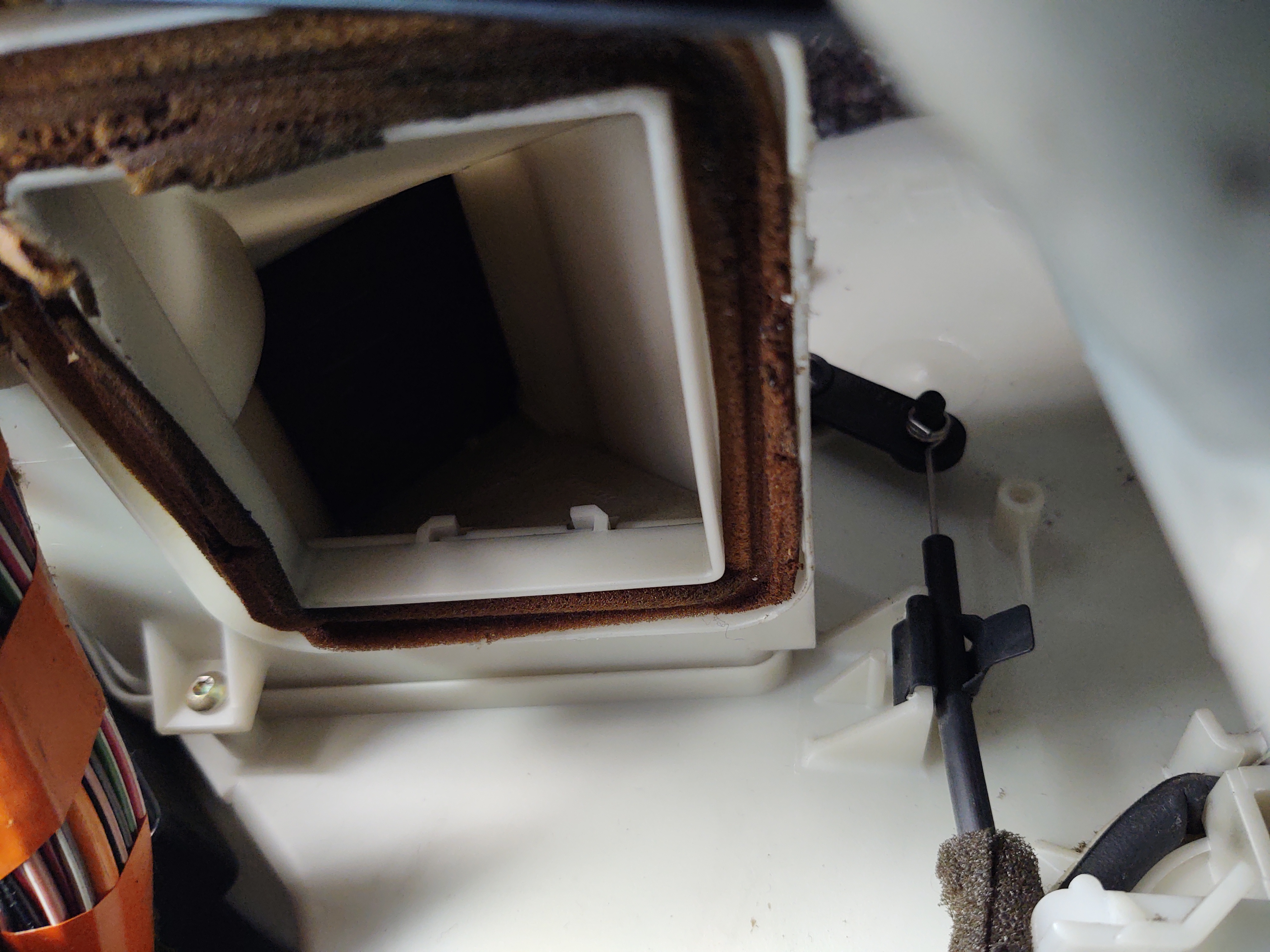

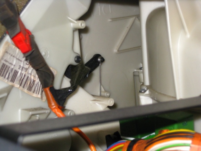

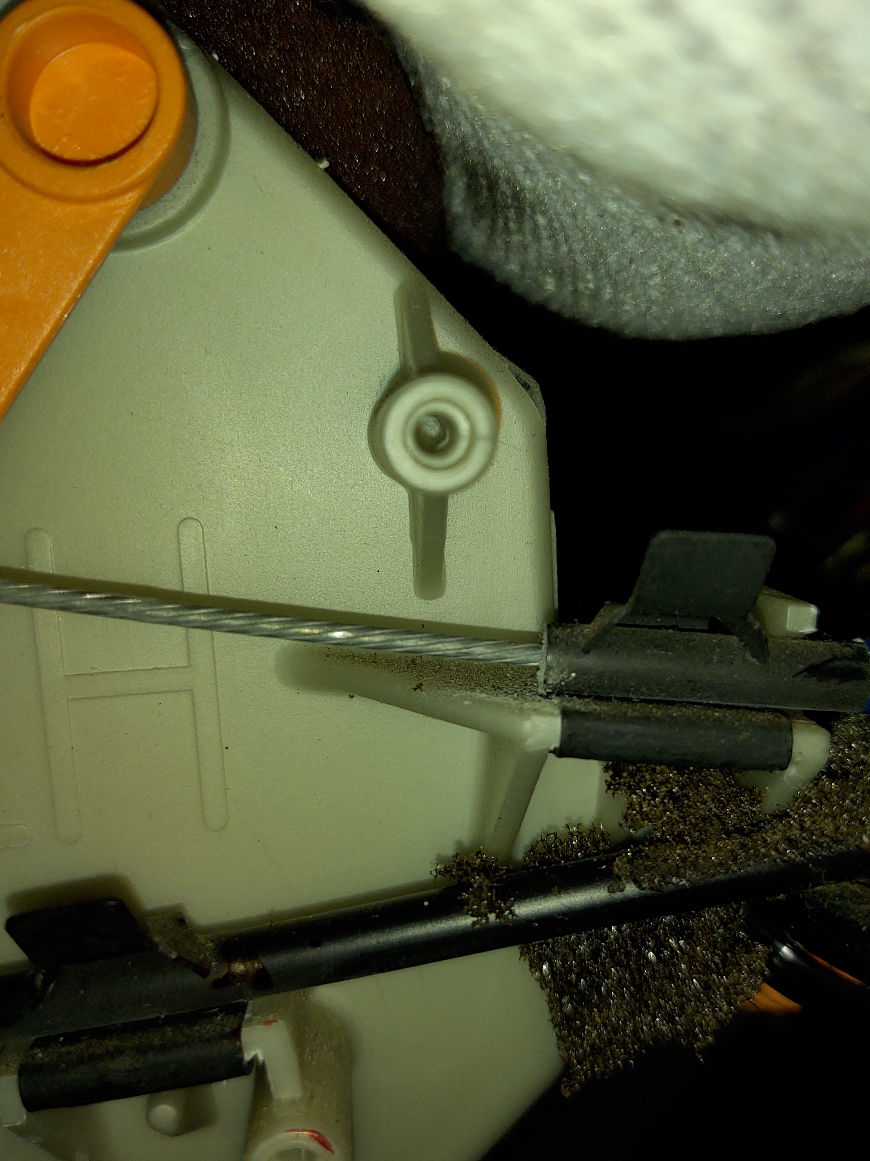

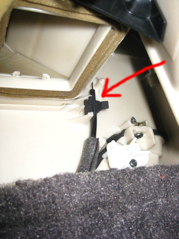

9. Disconnect the far cable ends at the climate control unit. The driver’s heat control and the two mode control cables can be accessed from the driver’s footwell area, and the passenger’s heat control cable can be accessed from the passenger side. There are loops at each end which pop off a pin on the damper arm. You also need to remove the anchor clip that is clamping the jacket in place.
The black duct in this photo was preventing access to the anchor clip on the passenger side, so I temporarily removed it.
Here is a shot of the anchor clip for the passenger heat control, after the black duct was removed.
10. At this point, the control panel should be loose. Push it toward the back and down, toward the driver’s footwell, while guiding the cable that runs from the passenger side so that it follows the whole assembly out the bottom.

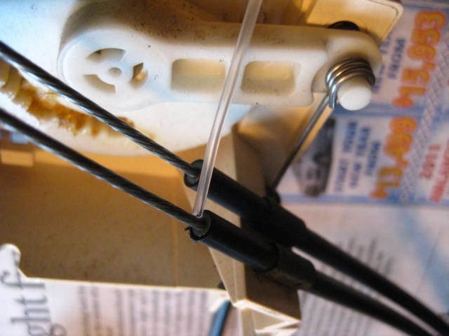

11. Before I installed the replacement control panel, I lubed both ends of the mode control cables with Tri-Flow, per recommendation from the forum. Remove the back cover of the control panel to access the cable ends that attach to the cams. The heat control cables are solid-wire, so lubrication isn’t as important with these.
12. To install, start by threading the passenger-side heat control cable up from the driver’s footwell into the area where the control panel sits, then continue to work the new control panel into place, attaching it with the mounting screws. Snap the power connector back in place (it’s keyed, so it will only go one way. I believe the pink wire is at the bottom center.)
Make sure you dress the driver's and passenger's heat control cables behind the trim panels on the center console side of the footwell, and that there are no kinks in any of the cables.

The two pins connector hidden behind the MCC panel was a bit difficult to remove. Instead of using a rivet pin, I used 2 small flat tip screwdrivers to push connector clips outward while the pulling the connector from the back side of the MCC panel.

For passenger side heat control cable, I did remove the vent (clear color in 1995 instead of black color in 1997 model) to get more space.
