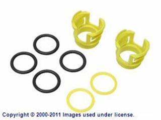

okay well have decided to do the work this weekend, waiting on parts. but before i order everything the part number for the o-rings for the heater hose firewall side and orings for the heater core are the same part number just listed differently. my question is do i need 4 of the part number 3545586 or just the 2
JDS60R
- Posts: 3532
- Joined: 21 February 2009
- Year and Model: 2007 S60R 2016 XC70
- Location: Mount Juliet, TN
- Been thanked: 3 times
I believe at the fire wall coupler there are two on each line on each side. The heater core has one on each line.
To just replace the heater core you need 2 orings.
To replace the seals on the interior side of the coupler you would need 4 for the coupler +2 for the heater core.
- coupler interior seal components.jpg (9.1 KiB) Viewed 2241 times
