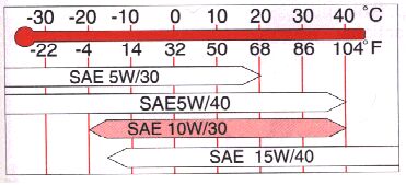

It's really up to you.Both of them are great oils.If you live in moderate or mediteranian climate area i suggest 10w-40,because in those areas the winters are not that cold.
5w-40 is for ambient temperatures from -30 to +40 Celsius.
10w-40 -------------------------------------- -20 to +40 -------- .
Check this Volvo oil viscosity recommendation: Direct recommendation from Castrol,Mobil,Liqui Moly...etc,for these cars is usually 10w-40,but as you could see,it depends of ambient temperatures.
Recommendation from Haynes manual is 10w-40(winter or all year round) to 15w-50(summer time).
Personally,i use 10w-40 all year round and sometimes 15w-50 in the summer,but i live in moderate climate.Car is near 300k km and it runs like new.

You couldn't made a mistake by any chance.
Fully synthetic oils are much,much better than mineral oils.They provide much better protection to engine than mineral oils.
If you used fully synth,i guess that you didn't used anything thinner than 0w-40 or 5w-40 for your climate conditions.
0w-30 or 5w-30 are preety thin for n/a engines in these cars,especially in the summer(see the table from previous post).

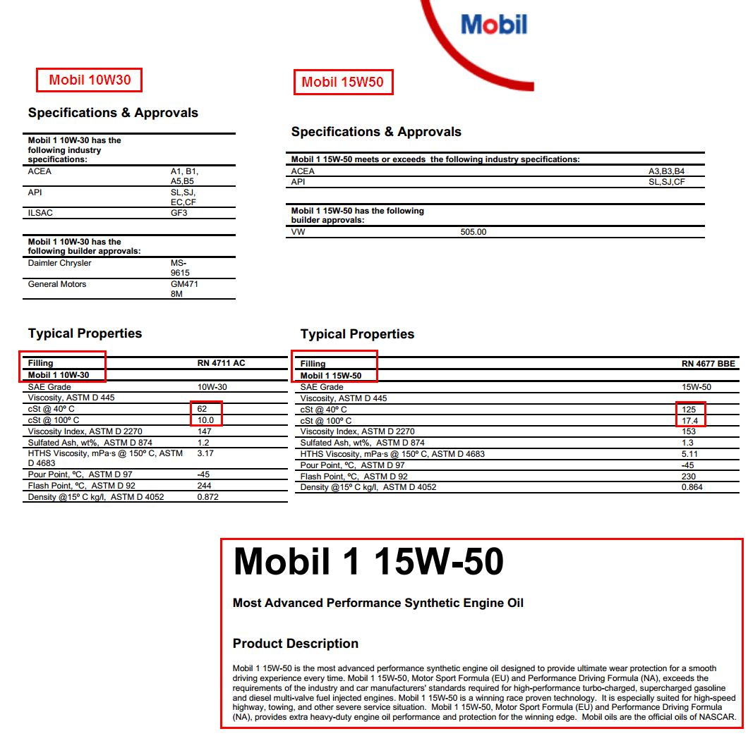

Anyway, I just changed the oil using Mahle Oil Filter and Mobil 1 synthetic 15W50 just for the summer. In the winter I use synthetic 5W30.
For high-mileage vehicles (mine has 150K miles), thicker oil such as 15W50 is often used.
Car "seems" happy LOL.
I will report back from time to time.
PS: I have used 15W50 and 20W50 in my high-mileage BMWs in the past, zero problems.
jblackburn
- Posts: 14042
- Joined: 08 Jun 2008, 15:54
- Year and Model: 1998 S70 T5
- Location: Alexandria, VA
- Has thanked: 9 times
- Been thanked: 20 times
Omg, 15/20W50 in a modern engine? What are you doing?!
'98 S70 T5
2016 Chevy Cruze Premier
- Posts: 8358
- Joined: 31 Mar 2010, 09:54
- Location: Omaha NE
- Been thanked: 504 times
LOL, it is no longer modern engine, it is 15 years old with 150K miles.
At that mileage, the rings, valve seals, crank bearings get a little worn, so the thicker oil "may" be better, especially for my turbo engine.
Data straight from Mobil website:
