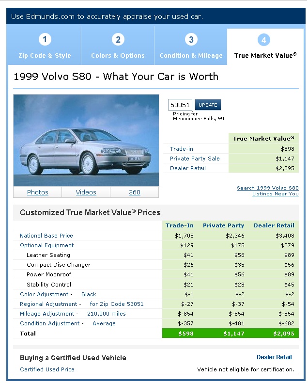

Price is too high for my comfort zone. The market might dictate otherwise, but judging from the edmunds TMV its overpriced. KBB values are good for an insurance claim, thats about it. Ive attached the TMV result, its a little on the low side considering that its a very comfortable, reasonably powerful sedan, but it gives you a bargaining chip.
