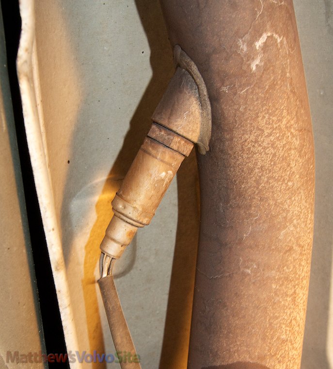

Thanks Justin. I'll try that if it continues. Misha, yes -- it points to the cat. But I don't think it's the cat.
Backstory: I just replaced my rear O2 sensor, and continue to get a P0422. The catalytic converter does not show signs of failure, like rattling when tapped. The rear sensor replacement did double the distance I have to drive to trigger the Check Engine light.

Justin, the heat shield already makes the stock setup tight. Any ideas on how to squeeze an additional part in there that'll add an inch or so?
I think I'd forego the special O2 socket, for starters.
http://www.o2-simulators.com/?gclid=CJW ... TAod52EQsw cheaper

That angle spacer thing may work too.

Hm. Ok, I'll get the IPD one then, and try to get in there with a big box-end wrench to tighten it, rather than buying another specialized tool. Thanks Justin.
