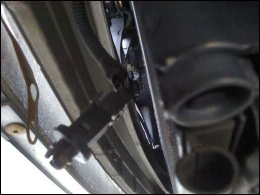

I have noticed some type of sensor on a bracket hanging on the back side of the bumper slightly to the drivers side in front of the radiator.
It looks like it may be broken. it has a plug on the rear side... (see Pic) Couple this is a problem?

This appears to be the ambient air temp sensor (only talks to the A/C) and should not be relevent to your symptoms. Sounds like some unmetered air entering your intake. Did you say you already checked for vacuum leaks (they're sometimes tricky to locate)?
