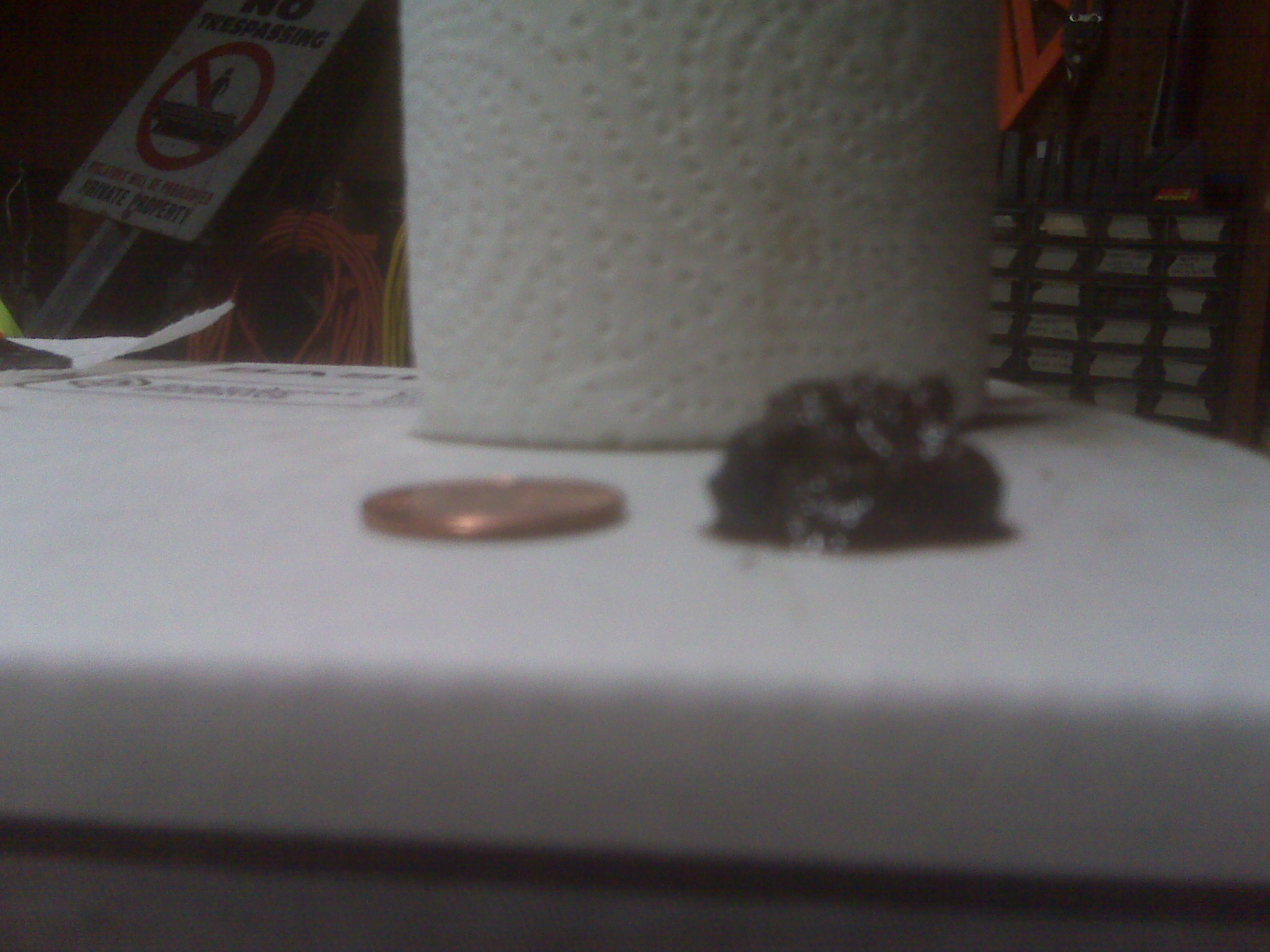

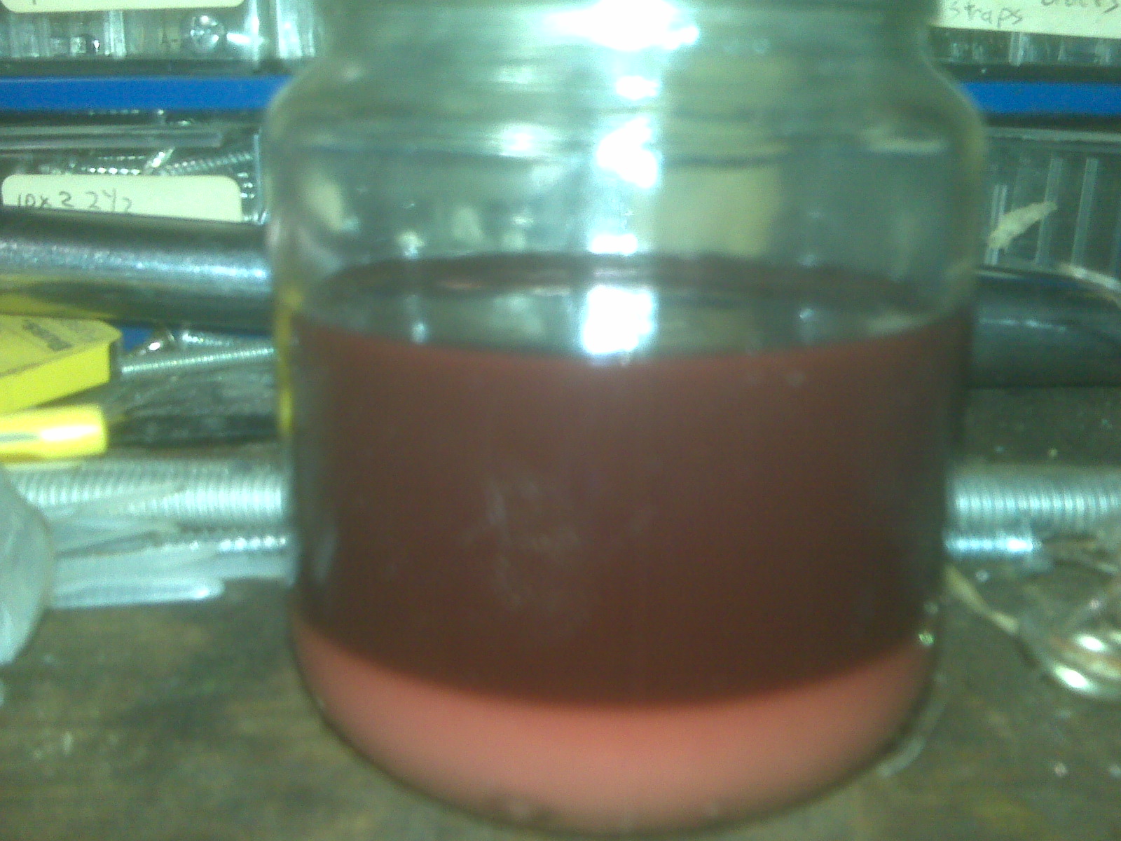

Drained the transmission pan today. Its been sitting for about 2 weeks. Doesn't smell burned but looks milky and pink, not red and clear. Would any entrapped air bubbles be gone by now? I put some of the fluid in a glass jar and it doesn't separate like I'd think it would if had water in it.
I flushed with AMSOil a few months ago, could that have dissolved built up varnish etc and clogged the filter? I guess the next thing is to remove the pan and check the filter.
Any additional thoughts are appreciated. Thanks.

Filter was full of sludge, but no metal in the sludge. What is the sludge made of? It was so plugged that the pump had actually bowed the metal strips on top of the filter trying to suck up fluid. Also, the fluid I've set out has started to separate into red and milky pink. Wonder if flushing the trans and then replacing filter again after a few hundred miles might fix things if the pump isn't toast. I have some pictures of the sludge and the fluid if that is helpful.
Thanks anyone.

Oh. If I pile all the sludge together its about the size of a big marble.
fluid after about 3 hours
sludge in filter
sludge in filter
