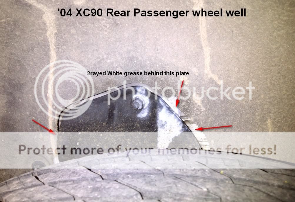

Well last night after I got home from work I tried to pin point the sound of the "thud/bang" and narrowed it down to something behind the passenger wheel well.
I spray down in the area and the noise stopped - tested by bouncing the rear of the car form the bumper.
I took a picture of where I sprayed the lub - this time I used white grease:
Anyone know what's behind here and why the noise stops when lubricated?
The noise came just before I pulled into work...so it's a temp fix.
Anyone have any ideas?
