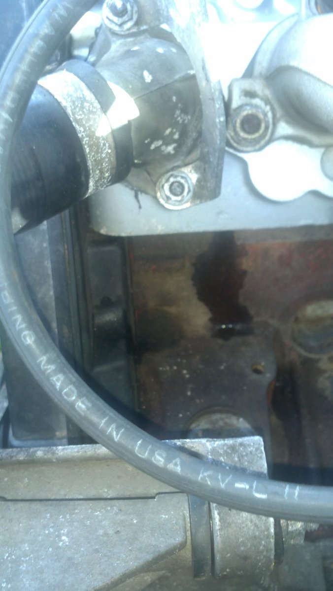

I just had a guy put a brand new head cylinder on my car now I am noticing at the part that sits on the engine is leaking a fairly small stream of coolant, I have only driven this car for 2 days. it is an external leak I am dealing with. Is this a fairly simple fix or am I going to have to drop another grand to get a new head gasket put on. I even took it up to a shop to get a certified mechanic to let me know if all looked good and he said it was fine. The car is a 1993 940 Turbo.

It was all milled, New valves, new everything. I repeatedly tried to crank it up today to see the leak again and it never did! I dunno what to do? Maybe try a fix treatment? It was the first time I noticed so I got a snapshot. Should I drive it around to spot the leak again or is that just going to make things worse?

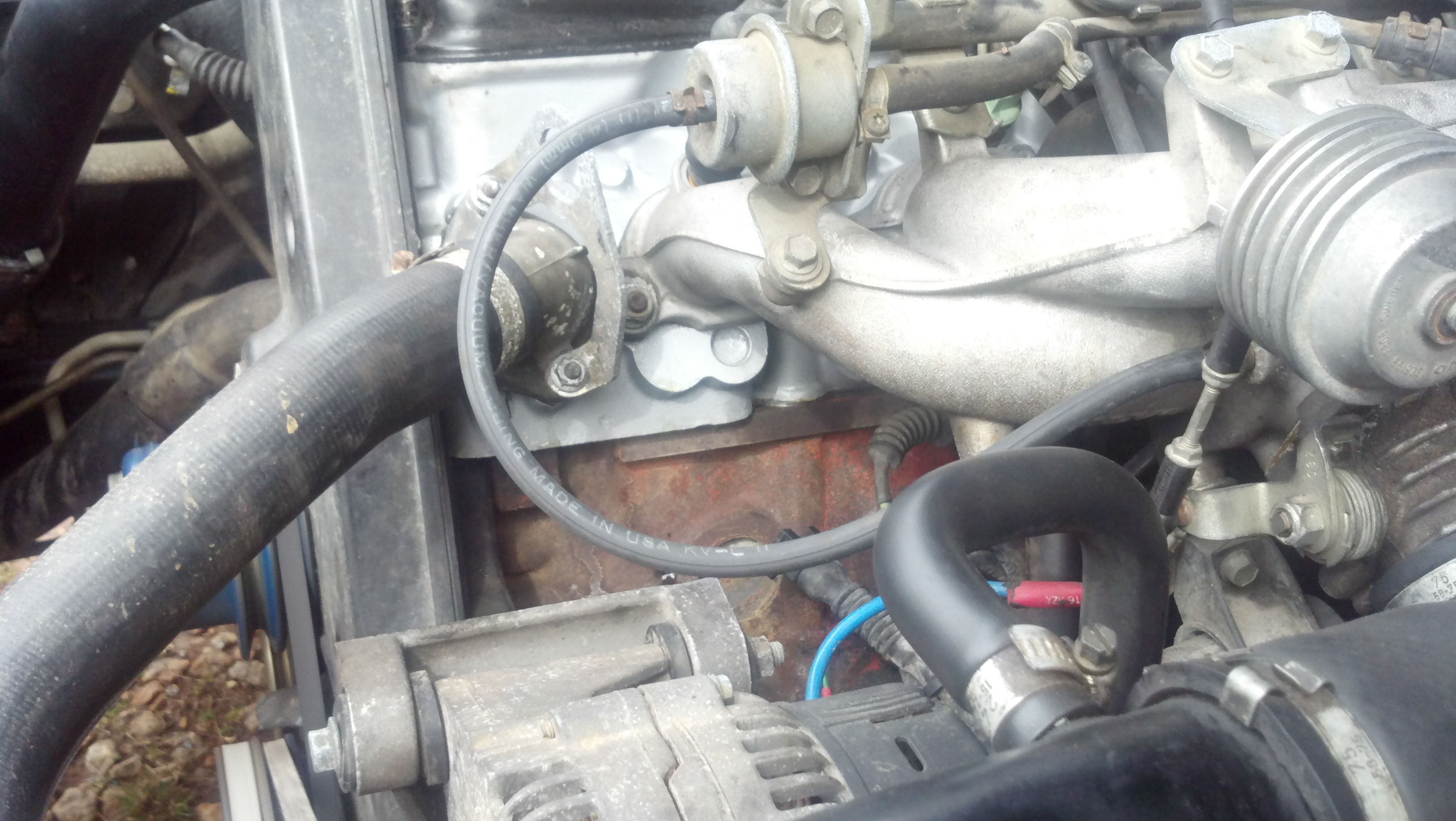

Ok I have made a mistake. I got up this morning and cranked it up to find the leak coming from 2 spots. One appears to be part of the air intake manifold but only on the farthest left section and the other the black hose, part of the coolant system? It is both the metal joints that bolt to the head in the picture. Is this still a major problem or do I simply need to re seal those joints?

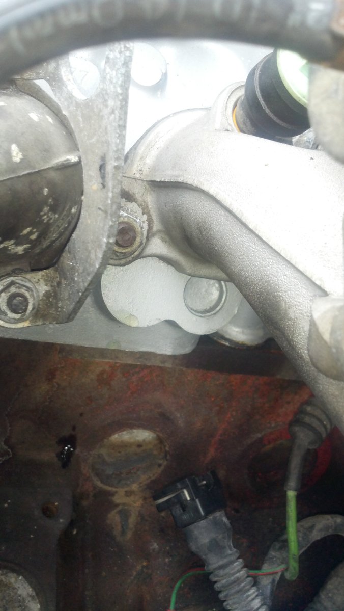

Close up. Both leaking where the metal joints from the black hose attaches to the head and the air intake manifold attaches on the head.

Post by JDS60R »
If "the guy" who put your head on removed the intake etc then have him fix it.
