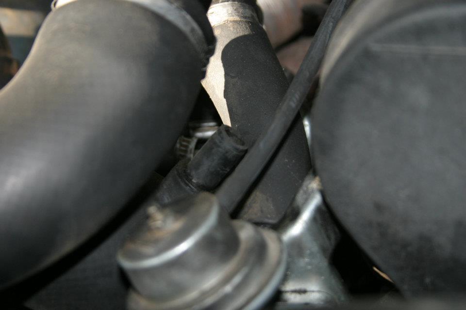

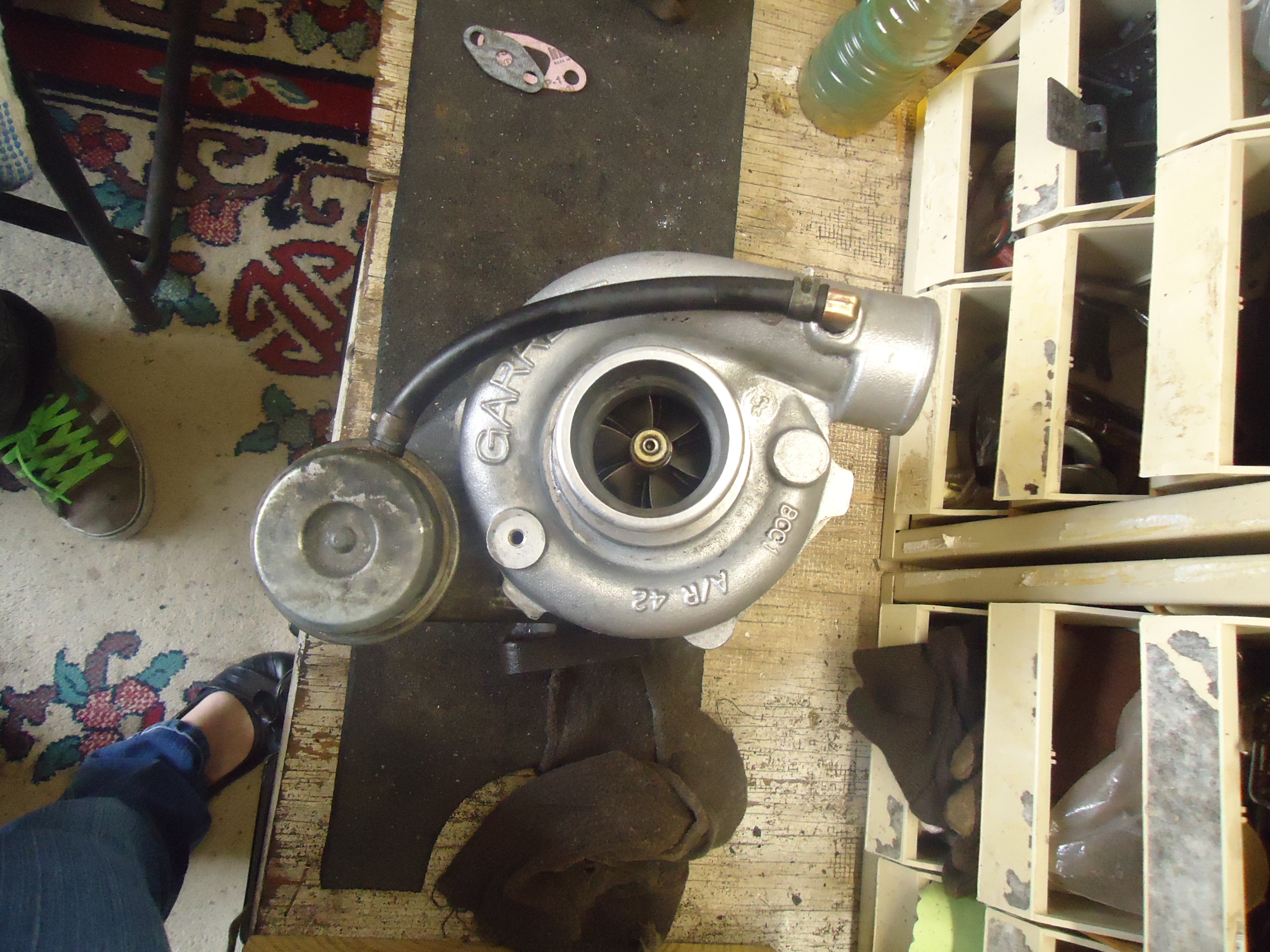

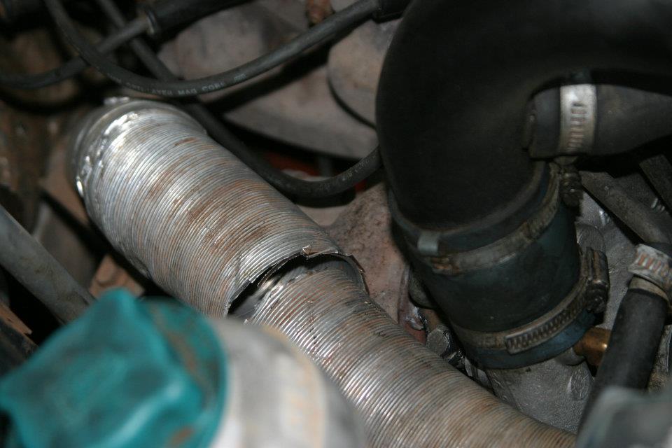

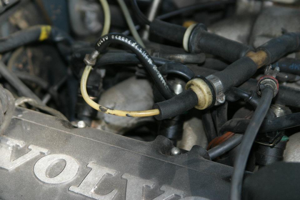

Just some images to share. If you look at the bottom you can see the hose that is missing going over the motor, you can see the one pipe is not missing, and that the windshield fluid line is not cut, there is also a bolt in one of my hoses above the motor, and Idk what it goes to. :[
- MISSING HOSE ALL TOGETHER.jpg (41.86 KiB) Viewed 914 times
- Connecting turbo to block, I dont even know what the black shit is, but its not holding the oil...
- BLOCK TO TURBO.jpg (78.38 KiB) Viewed 914 times
I am suprised my Volvo ran at all, I obviously got screwed over, but I honestly dont know where to begin. I need more Volvo knowledge! Please share what ever advice you can give me, I obviously have a lot more on my hands than a fuel leak... The mechanic who worked on it still wants another 800 dollars out of me, but truth is my car was better off with a cracked head gasket than it is now, at least it had all its hoses and shit was cut up, plugged up, and there werent sun flower seeds in the bottom, and other ghetto what nots. Ugh.
- WTF.jpg (67.83 KiB) Viewed 913 times
- BROKEN.jpg (67.87 KiB) Viewed 913 times

The pink and black wires are from the in-tank pump and, no doubt, the hose is from the same place. You don't say whether the car is a saloon (sedan for US members) or estate (wagon). In either case the in-tank fuel pump can be accessed through an inspection hole in the floor of the luggage area. On the saloon the tank is mounted centrally under the floor and the inspection hole is in the middle. On the estate the tank is mounted at the side and the inspection hole is, of course, at the side. First course of action is to get access to the in-tank pump and get the wires and pipe reconnected. I feel that this could be a cause of the poor starting/running. The fuel system does need two pumps. The in-tank pump is a priming pump for the main pump. If the in-tank pump is not working the main pump will struggle to pull fuel through, especially if the fuel level is low. If you can fix this yourself, and I am sure you can, it will cost a lot less than $112. The only drawback would be if the wires have pulled the tags off the pump rather than just pulling the connectors off the tags.
Looking at the pictures, which should be in the Black Museum, you can do a temporary repair on the silver coloured hose by pushing the smaller hose into the bigger one and wrapping it with duct tape.
The hose from the turbo needs to be replaced. The black mess on it seems to be some sort of sealer which is not up to the job of keeping oil in the pipe and never will do. Who did the turbo swap? That should have been changed at the same time. I like the shiny turbo, it contrasts nicely with the green shoe laces.
The missing hose and the hose with the bolt in the end have me scratching my head at the moment but I still have several books to go through. The most important job for now is that fuel hose/wires.

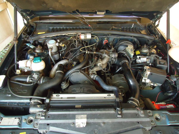

And what I think caused my fuel pump to break is that exposed hose, which I think has my motor exposed too, if you see in the picture of under my hood before I took my car to that guy who claims to be a mechanic.. :[ you see a hose going over the top of the motor from the left to the right to the fuel injection side, from my turbo,
This Edward fellow on this page www.justanswer.com/volvo/3h1n2-89-volvo-760-turbo-problem-fuel-pumps-breaking.html suggested the person with fuel pump woes to check his/her turbo hoses, and that a hole in the hose could cause and put significant stress on the fuel pumps, so I am thinking that my fuel pump may not even be busted now if I had that hose, so its a pain a bunch of things I got to fix. :[ That werent broken before, I feel bad for my Volvo now though I was mad at it for repeatidly letting me down, but now I see people just did terrible jobs at taking care of and fixing it. :/
