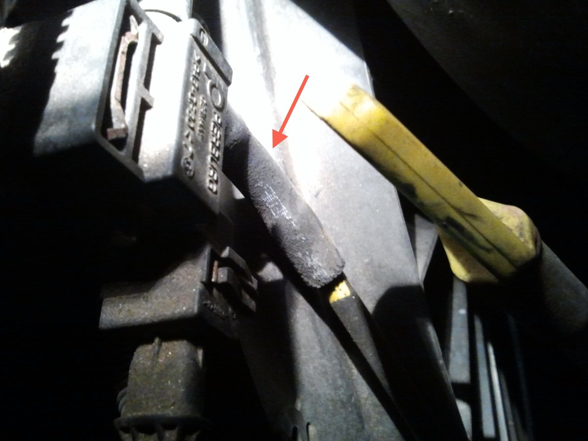

A couple days ago I had my CEL come on. I check the code and it showed a p0442 (small evap leak). After reading through many different posts regarding it, I checked the basics (gas cap, J-hose, and other hoses that I could get my hands on fairly simply). After not finding any cracked/damaged hoses, I resorted to the dreaded dealership to get a smoke test (my normal mechanic doesn't have the equipment and i found a coupon). After $80 for the test, they called me and said they found a leak in "some hose in the evap system" and that it would be another $180 to fix it. After prying, I found out that the hose was $15 and it was the labor as usual. After more prying, I got the part number and a mild description. The part number is 976736 (Hose #976736). The only issue is I am getting mixed feelings about which hose it is. They said it goes from the front of the engine almost to the charcoal canister, but connects to another hose first. (They wouldn't let me talk to the mechanic since the dealership service reps are really just salesmen.) Anyways, I cant find a picture of a new hose, but I would like to make sure I know what I'm getting into before I give in and let them fix it.
Here are a few pic's showing which one I think it is...
(p.s. the location of this is under the big air intake hose next to the battery

It looks like the setup in your car is not exactly the same as in the link you posted, but yes I think you have IDed the part. Your link to the part number follows to this diagram, where you are talking about hose #16:
It looks like instead of a single vacuum line, you car has a rubber elbow to a hard vacuum line, which probably has a rubber elbow at the other end. Could be leaking at either of the elbows or somewhere in the line. That elbow in your pic looks a little crumbly.
If I was in your position I would just buy an appropriate length of silicone or rubber vacuum line, you'll have to figure out the appropriate diameter, and replace it myself. Access may be difficult but there is nothing special or critical about the evap system. And you don't have to route a replacement line exactly the same, you just need to get from the valve to the canister and stay away from the fan or really hot areas, etc.
Now that your car is 12 years old, a lot of the rubber vacuum lines are going to start showing these small leaks. So you may want to get in the habit of replacing them. One approach is to just buy enough vacuum line to replace any accessible lines. Or fix them as they go, but it can be difficult to know which ones are leaking. Just make sure you use lines with the appropriate ID.
