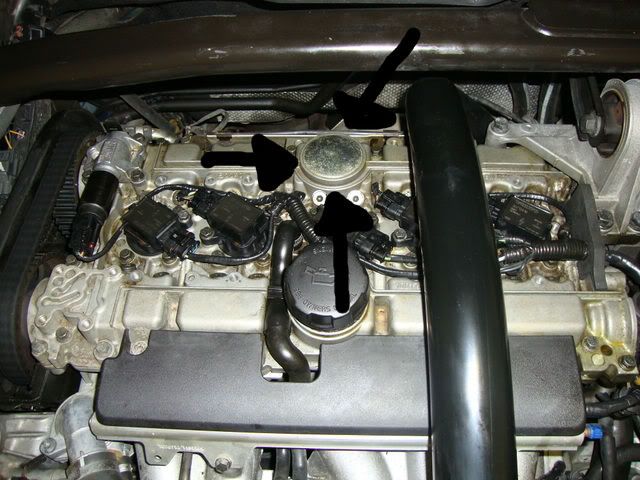

My parents were driving back from Vagas and my mom said she saw smoke coming out of the engine. They pulled over and saw this part:
had blow off, spilled oil everywhere, and caught fire to the fabric that wraps the firewall at the back of the engine. (Not sure if that's an S80 engine pic but the part looked the same n my mom's car)
My questions are:
1. What is this part?
2. What would cause it to pop off and spill oil everywhere?
3. My parents said there were actual flames/fire where the oil was. Is this a known issue?
Any advice or help is much appreciated. My mom is scared to drive the car. Is there an inexpensive fix for this problem?
Thanks again and good to be here!

It's a factory cap that serves no real pupose. Of course if it's not there oil will spew out.
If you have the part clean it up then go and find an engine rebuilder who can advise you of the best heat proof resin to use around the edges to make it stay in place.
Your mom's S80 must have really excessive crankcase pressure as a result of a blocked PCV system or excessive blow-by from worn piston rings. Pretty soon seals will leak and you don't want one of those to be the REAR MAIN seal
Read up on PCV cleanout (the 5 cylinder engine swapout is almost the same)
The intake manifold needs to come out and a new PCV system fitted.
