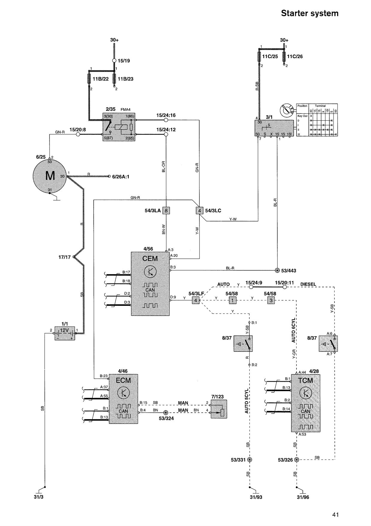

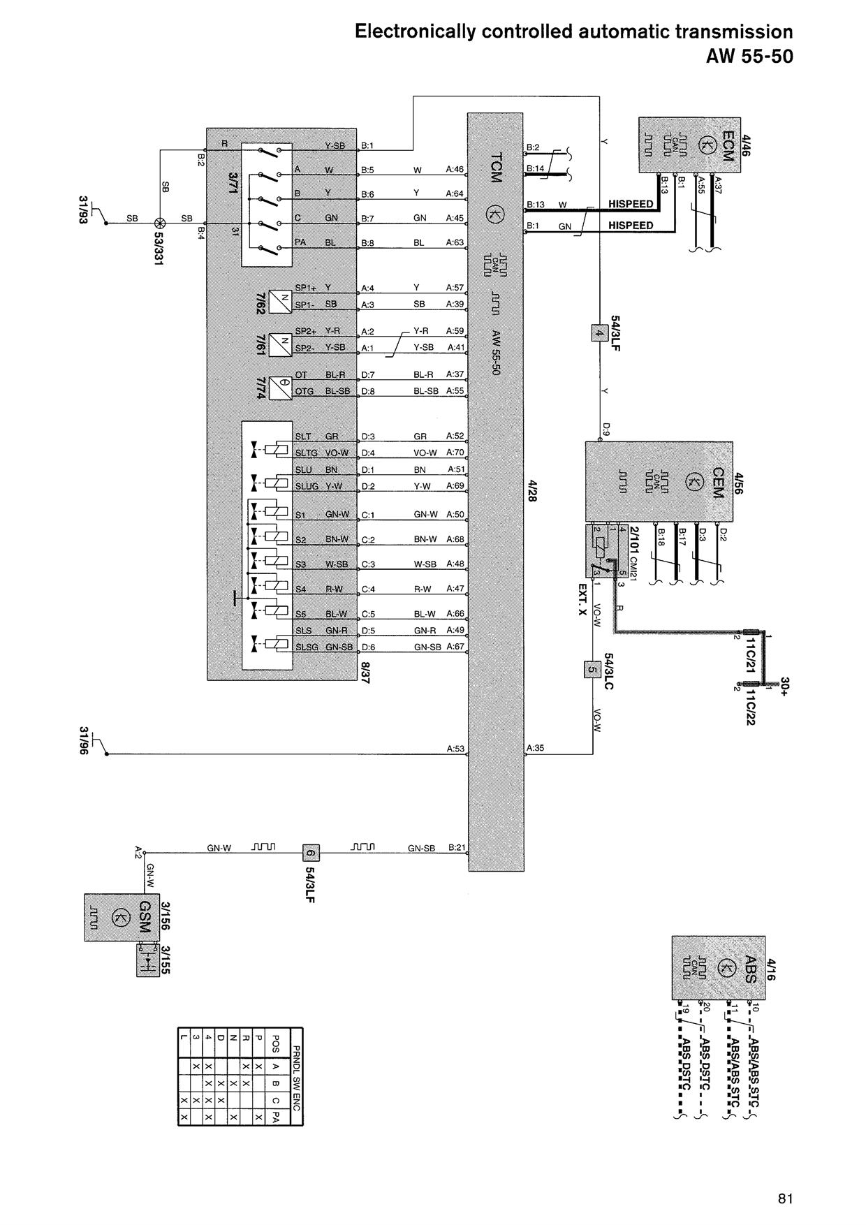

You may have a dirty contact on the "gear position switch 3/71". In the older models its is called the PNP switch.whs3 wrote:Tiz a puzzlement! Do you or anyone else out there have any other suggestions?
Thanks! whs3
Sometimes moving the gear selector rapidly from Park to Lo about 10 times helps clean it.
I include the stater and transmission diagrams. This switch is located on top of the transmission where the lever mechanism is connected.
