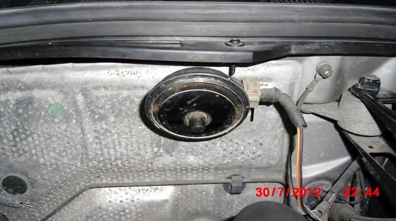

Looks like the wire that goes to this part in the engine bay of my 1998 V70 XC. I don't know what it does, but my car is a 2.4L turbo vice N/A. Anyone know what this is?
What is this? It's to the right of the upper engine mount.
CIMG1910 (800x448).jpg (273.39 KiB) Viewed 2979 times

rspi wrote:The alarm has it's own horn/buzzer. The knob on the tip of it adjust the should of it. Sometimes it falls apart. Here is the alram horn location just in case you are missing it.
I noticed a post courtesy of Mr. rspi that referred to a horn for the alarm system located at the center of the firewall. It does have the look of a horn about it. Does the AWD have a different alarm system than the 850/V70/S70?

no my 94 850 is the same alarm. Yes it does look like a horn but those 2 things in front of the car grill between the lights are the horns. As you can see one is chipped.

The owners manual refers to an optional alarm feature that will sound a separate siren when the battery is disconnected while the alarm system is engaged. Perhaps this horn is the "siren" that they refer to. Those cars that lack this siren, perhaps also lack this "battery disconnect" alarm feature.

The alarm is an option in the '98 70 series. To save money at the factory
and also make it easier to add options later at the dealer, all models share
a full wiring harness.
What I think you're looking at is the connector for the single, round alarm
horn that would mount on the firewall if your car had this option.
(Or maybe the car DID have an alarm and someone removed the horn.)
The two horns behind the grill have nothing to do with the alarm.
Chances are slim that you'll ever see a battery back-up siren on
any of these Gen 1 cars, but many later Volvos had that option.
