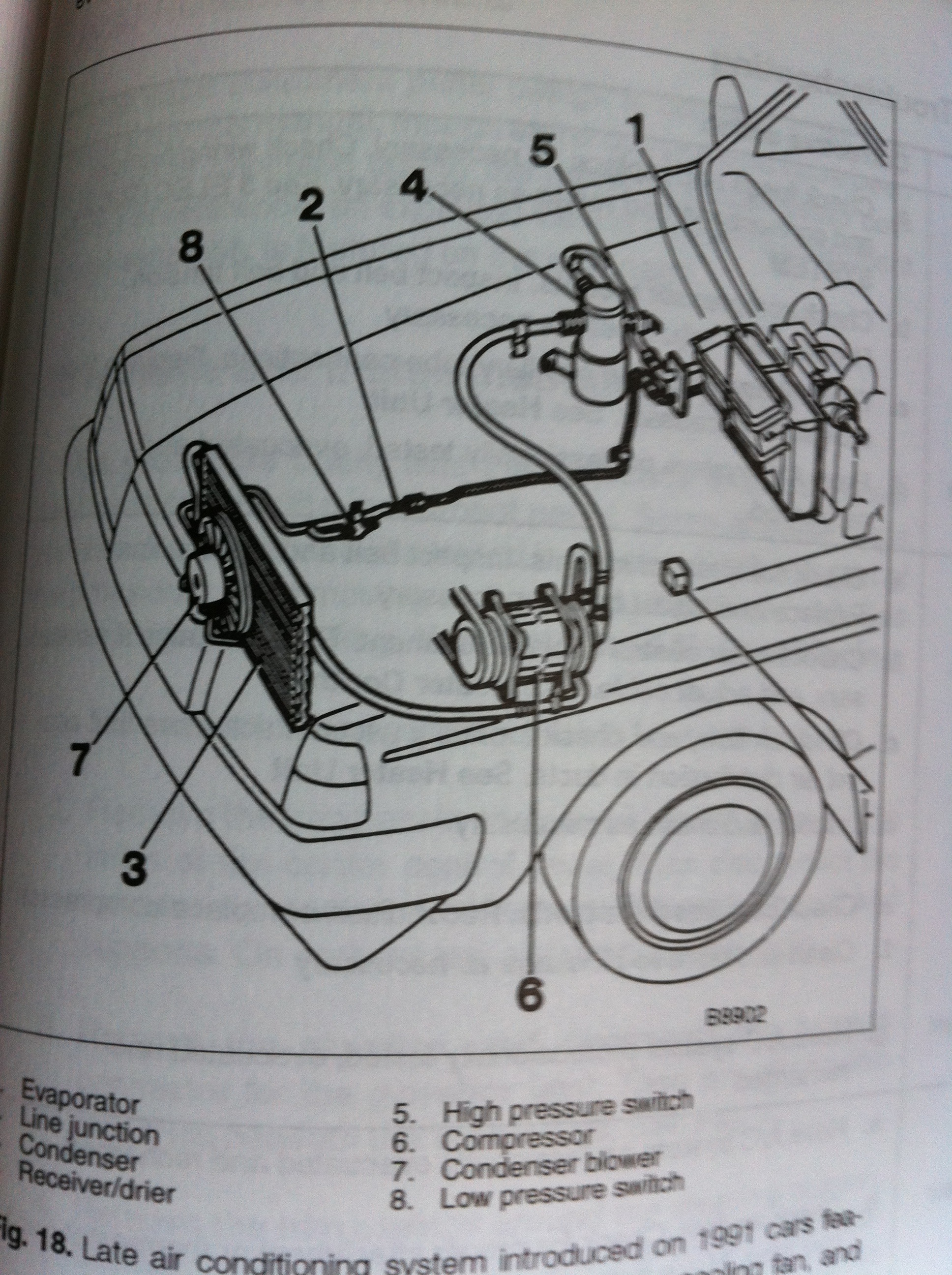

My 1993 240 wagon AC's compressor does not kick on unless I bypass the high pressure switch. Then the AC works great. Nice and cold. it is an R134a system.
When running, the freon pressure is about 35psi - pretty good.
If I quickly hook up high pressure switch, AC keeps working.
When not running, the pressure is 75psi. And of course, the HP switch doesn't let in come back on and I'm back to square one - need to bypass switch again.

You are talking about the switch on the high side line buried down below radiator or the switch on the low side line in back of engine compartment?
In either case it seems you need to inspect the terminals and if those are OK then replace the switch. You do need to be sure you ID the correct part.

I am talking about the switch on the receiver/drier in the back of the compartment (#5). According to a diagram in Bentley's 240 service manual, that is the high switch. But whatever it is, that's what I'm referring to. As far as the gauge, it's simply one that came with a can of freon. Not sure of accuracy.
So if it is on a schrader valve, it should be a simple swap with a new one?
