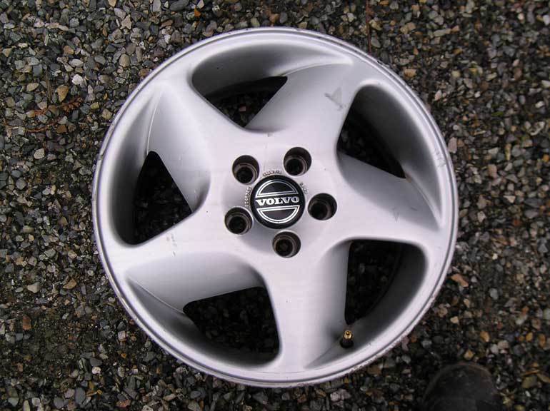

I am jazzing up a really nice 94 960 for a christmas surprise. It currently has the stock alloys, 6x15, on it (see attached). I have a spare set of rims off of an 850 (6.5x16)that would look good (attached also). What type of spaces should I get and what size? any help appreciated!

H & R Springs make a great range of spacers with a 15mm hubcentric kit for Volvo RWD cars which is about spot-on for 850 wheels but they are pretty thin on the ground these days. I snapped a set for my 960 and they arrived with 15mm longer conversion studs which are easy on the rear to fit but require the ABS rings to be removed from the front hubs before they'll squeeze past.
