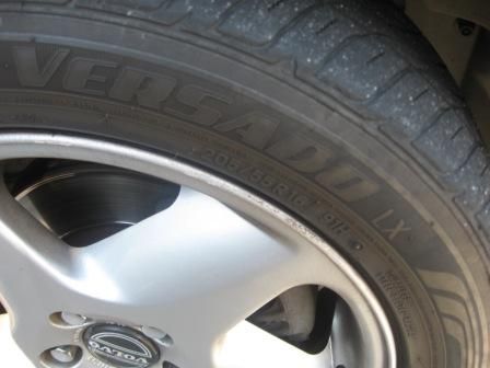

OK...as the topic seems to expanded a bit, I thought I'd post a little more detail so that nothing important is missed, or inaccurate.
Firstly, here are two pictures of the alluded to 'good' Toyos. I am posting these because they appear slightly different than what is currently available. My old ones were H rated, not T rated as the new ones marketed by Toyo. The Versado LX II might be the new equivalent to these as they are also H rated.

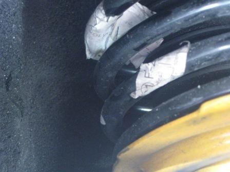

And, a shot of a lurking Koni Sport plus a spring tag, which deserves a long explanation:
When I replaced the front struts, I replaced everything, down to the fasteners as I felt that 19 years was probably enough. This includes the front springs. With worn out stock struts, and I suspect sagging springs, bottoming was an everyday event and I could frequently hear rubbing in the inner fenders (and the marks are still there...). I started to look into finding some stock replacements, and it seemed that I had at least three options based on the following part numbers and descriptions (although I never did find the colors as claimed...):
3546640 AT no AC (supposedly White)
3546641 AT with AC or MT no AC (listed as Blue)
3546642 MT with AC (allegedly Green)
This is where it got interesting. I assumed that a car with AC weighs more than a car without AC (not a big stretch!). I also assumed Volvo wanted all of the 850's to have the same static ride height, and that they would use the same spring material to save on manufacturing and design costs. If all of those presumptions are true, and if I were making springs, then I would change the free length slightly to compensate for slightly different front end weights. In other words, if you design two 120 lb/in springs, one of which needs to support an extra 50 lb at the same ride height, I would wind that one 50/120 longer (about 13/32") so that they would be identical when installed.
With that in mind, I concluded that the MT with AC spring would be wound slightly longer than the MT without AC spring, which coincidentally was the same as my AT with AC spring. I therefore assumed that substituting the -6642 spring for the stock -6641 spring would probably give me an ever-so-slightly higher installed height, which I hoped would help prevent bottoming and rubbing.
I came across a set of new Volvo OEM -6642's for a good price, bought them, and installed them with the Konis.
Interestingly enough, poking around a bit online helped to at least confirm my suspicions, or at least helped me convince myself that the logic was sound. More specifically, I found references from Skandix to free heights for two of their replacement Volvo 850 springs. The -6641 was lsited as having a 435 mm free length, while the -6642 had a 445 mm free length.
I measured it before and after, and after a few months in service I still have about 8 1/2" under the front air dam instead of 8". While this may be purely due to the new springs as opposed to the change in part numbers, new springs plus the front Koni sports made the bottoming out go away along with the inner fender rubbing. And like I mentioned before, the handling was outstanding until I put bad tires on it.

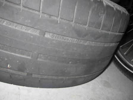

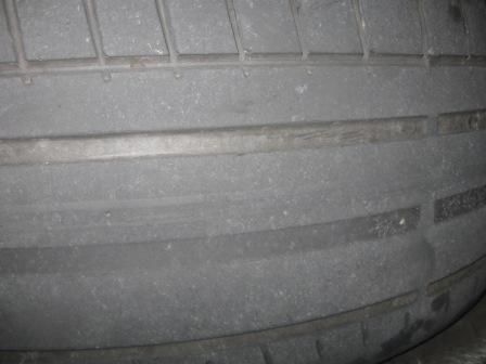

I replaced the Conti DW's today. I got 29k miles out of them, although my rotation schedule was anything but reasonable! Honestly, I was rotating them at least as often as I change the oil, i.e. every 5-7k miles, because the fronts would wear much, much faster than the rears. And...my alignment was done in my driveway with string, jackstands, masons levels, machinist rules, and an understanding of geometry, so you'll have to decide for yourselves as far as the fidelity of my data. But, in all fairness I spent a bunch of time setting the toe to as close to zero as I could which I believe tremendously helps with tire life. It is amazing how far off the toe can be off before one can tell while driving, and I think the alignment shops know this, which means who knows what they really set it to.northernlights wrote:I ended up buying a set of four Continental DW 205/55R16's about 3 weeks ago. I looked at the DWS type, but where I am there is never, ever, ever any snow, so I thought I'd give the DW's a try.JRL wrote:Try a set of Conti DWS tires, you will like them
We'll see how long they last with a careful eye on alignment and a reasonable rotation schedule. Treadware rating is 340, which is pretty darn good for a W rated summer tire.

This is what they looked like at the end....there wasn't much left.
Even at this point, the handling was still good in dry weather, but wet was a different story.
