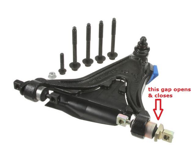

Lately I notice the steering wheel is positioned a bit to the right when going straight (was not the case after the suspension refresh/alignment), and when I apply the brake it corrects to the left, past center. The car does not track completely straight when braking either. I inspected the control arms and noticed that the gap between the front bushing and the outer 'frame' of the mounting pin changes when I turn the wheel; there is a ~3/16" gap when the wheel is straight, and the gap closes completely when the wheel is turned. The arm is moving fore & aft within the bushing. My thought is that this is not supposed to happen, and explains the brake/steering problem I'm having. Can anyone confirm this? Is this something people have seen with the aftermarket (Meyle) arms? I'm not hard on the car...the only thing I do a lot of that most probably don't is U-turns, as I live in the last house on a dead end.

And now that I think about it, do the C70 arms really need to be preloaded? I understand the concept of positioning the bushing at a 'zero' point before tightening, but the C70 bushings just are where they are. They mount to the frame differently than most...see below:
That's the gap that opens and closes when I turn the wheel.

Another thing I noticed last night...I'm actually hearing a small 'clunk' coming from the driver's side. It's not happening all the time, but I heard it twice. Pretty sure it was when I started going after braking.

I don't have experience with the 4 bolt arms, didn't realize you have those, so I don't know to recommend the Meyle part or not.
As for the clunk, that is actually the first symptom when the bushings are bad. I have never seen them so bad as to make the car wander, but 3/16 is a huge gap for that bushing. So yes, the clunk when first applying accel or decel is likely due to a bad control arm bushing.
