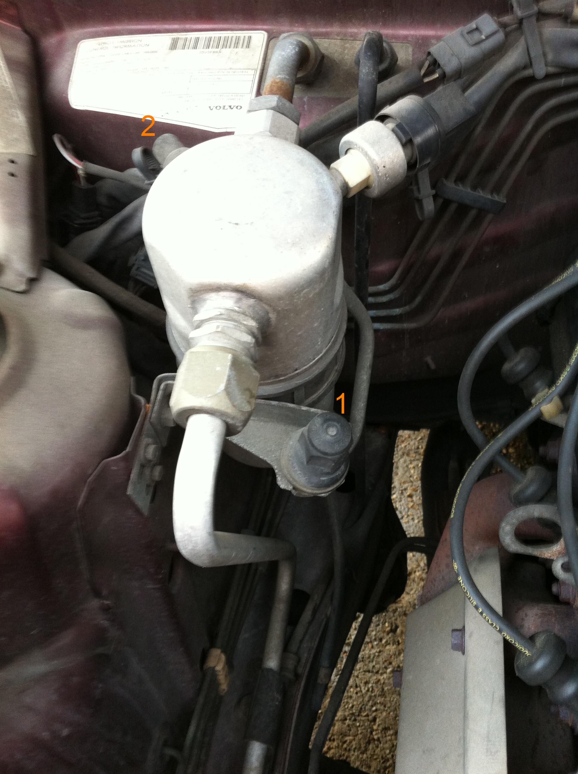

Hello friends,

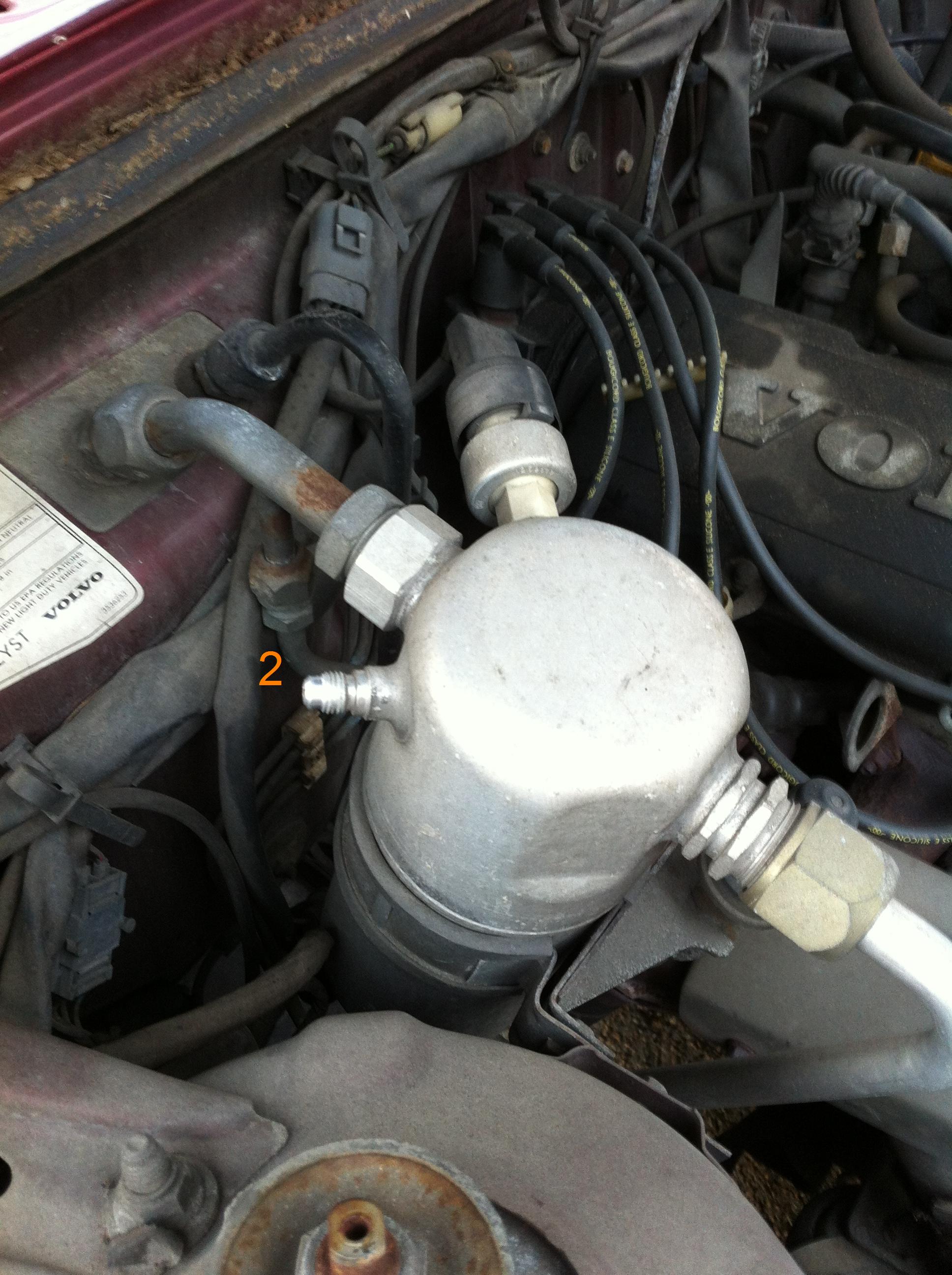

I need to charge the AC on my 91 740, I have done it on my 850 from the low pressure side, i don't know about this model, if anybody knows what freon to use and how to charge and share here, i would appreciate it.I am attaching a photo, kind a guessing the "1" is the low pressure side but also there is a smaller port I am showing "2" which I am not sure what it is...

1 is a high pressure factory fill connector that is not the same as R134a quick connect fittings you may have seen.
2 is your access. Is it still using R12?
