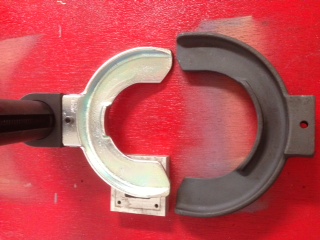

Update: So I thought that I'd buy a spring compressor with the money that it would cost me to have a shop install my springs. Went with the Baum McPherson unit that looks similar to the Volvo tool. The Klann tool was too pricey for me. The Baum tool is very well made. Problem is that the Volvo spring requires the largest of the 3 claws which is too big to fit in the tight quarters of the rear suspension. Also I couldn't get the compressor even close without dropping the trailing link. BTW, disconnecting the trailing link is much easier with the suspension jacked to the neutral/normal height. So now I'm buying a set of claws that are smaller than the large ones that should fit. Actually buying the Klann claws and praying that they fit the Baum tool. I'm heavily invested in tools at this point but I'll have them for future use. Bottom line is that it would have been much cheaper/easier to have a shop install my springs. I also tried to disconnect the lower control arm supported by a jack and getting the spring out that way. The spring interferes with some other structure and won't come out. This has been a real beast. Not sure what model years allow you to just disconnect the shock and lower the control arm and pull the spring but it's not 2002.

Those instructions pretty much sum it up. When I first read about removing the brake caliber I thought it was because there was going to be so much droop that it might damage the brake line. HA, no way. The caliper is removed to allow the spring compressor to reach the spring. You will also notice in the diagram that the pictured compressor has extension blocks on both claws to provide an extra inch of reach to avoid interference with the trailing link. The Baum compressor came with only 1 extension block to be used with conical wound springs. That's why I had to drop the trailing link from the wheel.
I received the Klann #1 claw today and it fits my Baum cylinder so I should be set. The included pictures show the Klann claw (silver) vs the two different Baum claws (black). The smaller Baum claw is just slightly too small to fit the rear spring. The larger Baum claw is just a little too big to fit onto the spring while the spring is on the car. It's important that the spring fit down in the recess because the raised area at 9 and 3 o'clock holds the spring in the claw. So as much as I wanted to use the small Baum claw, the spring just did not sit down properly and it would be dangerous. The Klann #1 is perfect.
- claw1.JPG (37.88 KiB) Viewed 7397 times
