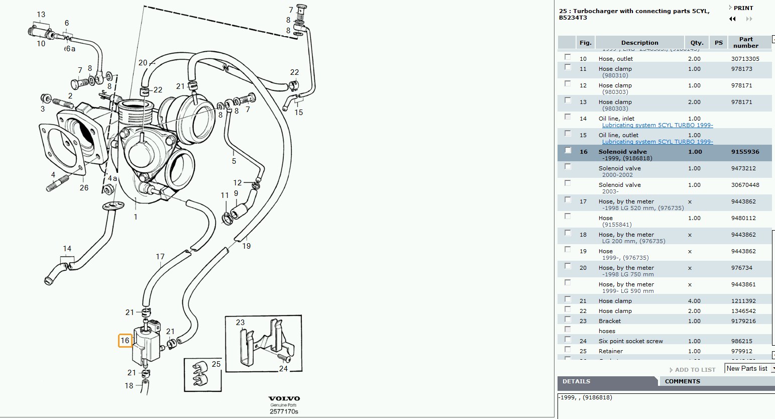

Very doubtful. This valve controls pressure to the wastegate. If it's defective, your boost will either be above or below expected levels, depending on the failure mode. It does nothing at idle or during deceleration/braking.tatsnturbos wrote: Would a broken BCS/TCV cause my car to act like this?
Yes. BCS refers to "boost control solenoid" and refers to the older-style boost pressure control devices found on 850s. TCV refers to "turbo control valve" and references the newer-style boost pressure control device found in the S/V/C70 cars. "Officially", in the parts guide both are simply called a "solenoid", but folks tend to refer to them as BCS/TCV. The operational concept is similar, just an updated design.Does my car have a BCS or TCV?
The valve is extremely simple, it is a small device near the passenger's side of the airbox with three air hoses connected to it. Attached is the turbocharger parts pictorial which depicts the valve as item #16. The only consideration for replacing it is to connect the hoses to the same ports as they were disconnected from. Mark the hoses and/or take a picture before removal.And does anyone have an installation guide for this? I am a beginner at doing repairs on my own, so please bare with me if the answers are obvious to my question.
Regardless, your problem is likely elsewhere. Given it is throwing cylinders 3 and 5 only, and not the random code, I'd start by checking the condition of the plugs, and comparing plugs from 3 and 5 to the others, noting if they look different.
