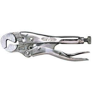

The job got put on hold since I had the wrong e-brake shoes. I also bought the Vise grip 7LW. I plan on getting the 4LW as well, pictured below, since it goes smaller than 7/16".
