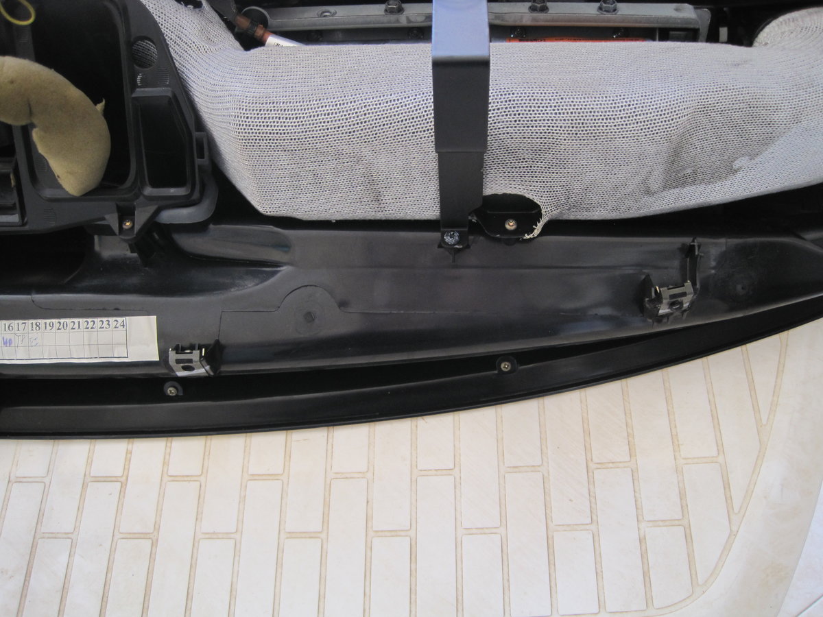

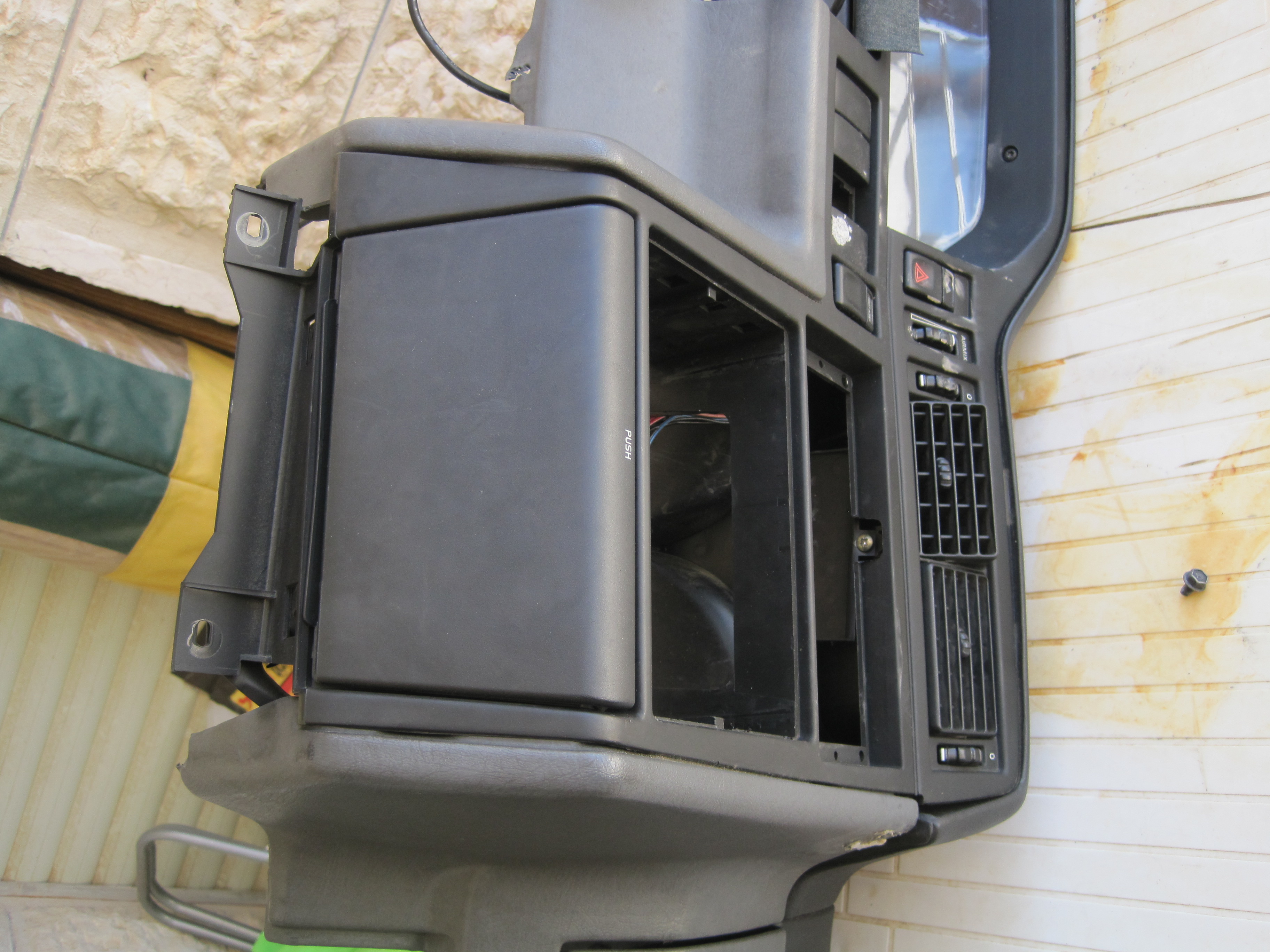

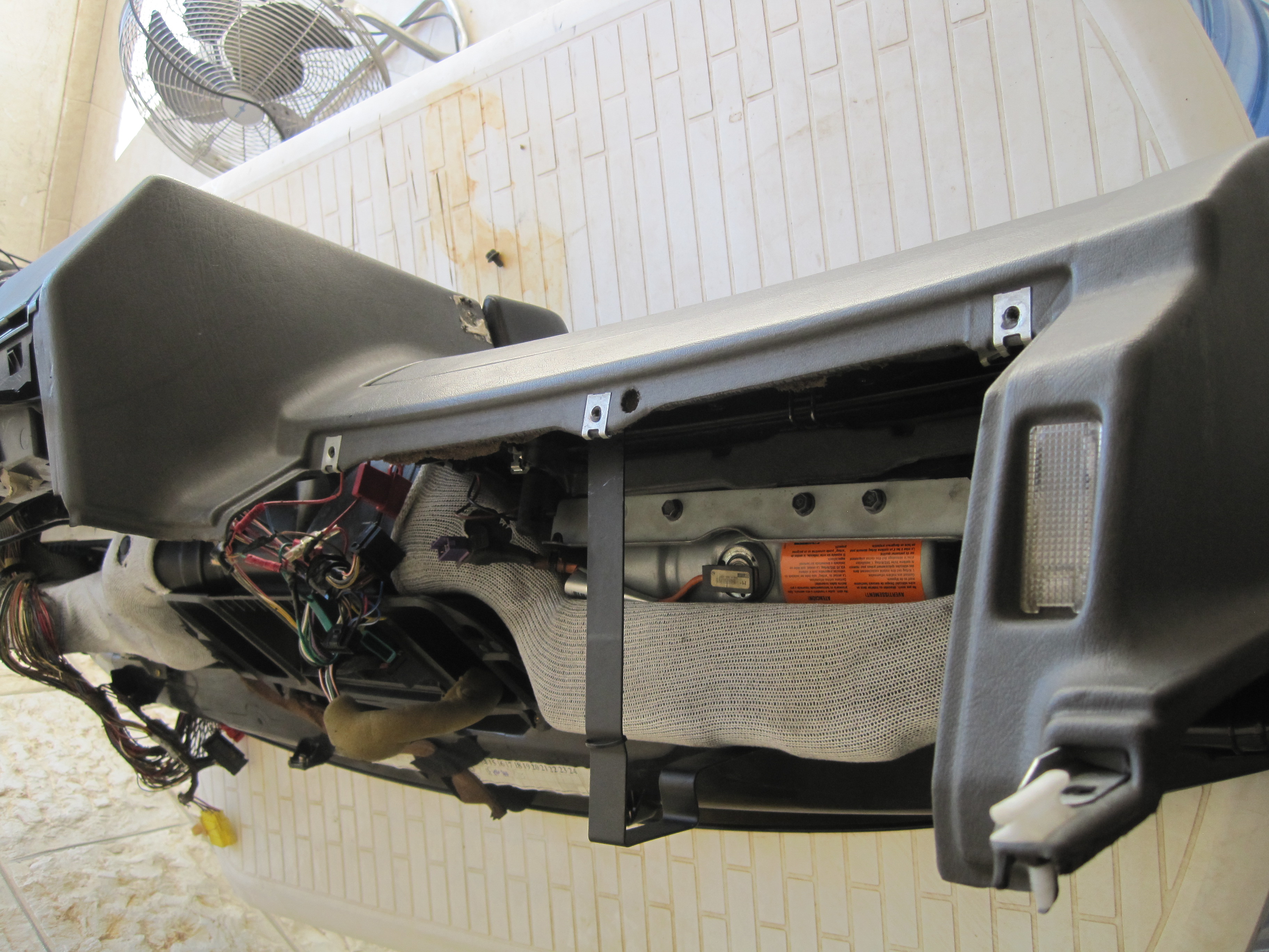

Yesterday I had the time, and I took apart the dashboard of the 850 Year 95 I got for free.
I decided to dismantle the dashboard along with the top so it will be more stable and less likely to crack the brittle plastic.
I needed some help to get out of the car dashboard, (thank the anonymous passerby who helped me).
I brought home the dashboard, and I was very pleased to have just one small crack nonsignificant, see pictures.
I am looking for time to dismantle my dashboard and replace them.
But meantime I'd love ideas and tips on how to strengthen and prevent dashboard cracks. Now that the dashboard is lying on the table is the time to strengthen and improve it.
ideas and tips will be welcomed..

Those mounts are so perfect that I hate to tell you to do anything. My original reinforcing method seemed to prevent otherwise good mounts from completely breaking but they also created a new weak point for the mounts that had broken up badly before.
You likely found it already but here is a link to the simpler reinforcement method that I have used.
https://www.matthewsvolvosite.com/forums ... hp?t=15115
...Lee
