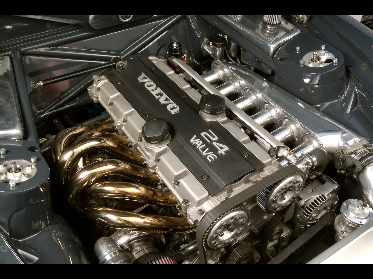

But here is photo I picked up a few years ago, someone with a lot of money and time. Sure is beautiful though. It is reported to be 600 hp.
DanR '94 964 387,000 miles (153,000 on the new engine)

That's a good looking engine bay I must say. I know this is the white block but that's all I know. I've heard with proper maintenance, it's bullet proof so to speak. I just don't have any experience with this motor.
