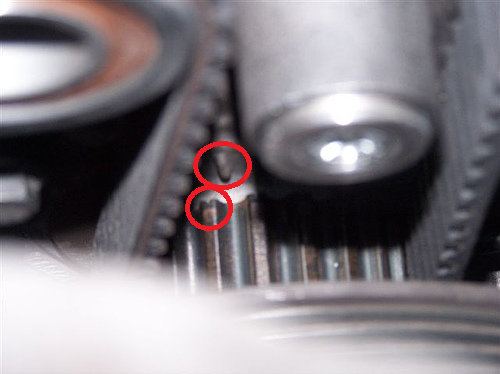

Here they are:
There is a solid post with a line on the end that is directly above the pulley. This matches up with a tiny notch in the corner of one of the teeth on the pulley. Please note they are NOT aligned in the photo.
You want to turn by hand the crank shaft pulley two full cycles to ensure the tension remains constant and you are not misaligned by a notch. After the two cycles all three marks should still be lined up!
- timing marks.png (299.59 KiB) Viewed 521 times
