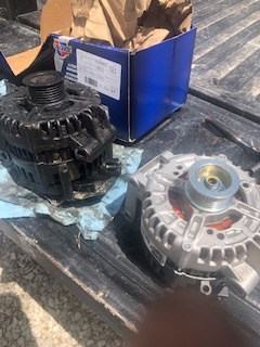

I have searched and searched on repairs and FINALLY did the amazing Alternator replacement. I bought a ReManufactured from AdvancedAuto with promo for like $180 total. Anyways.....
I got my old one out new one installed which took all of 8 hours. 1 day later My POWER SYSTEM FAILURE SERVICE URGENT came on the dash. I found that my LIN wire connector on the Alternator was loose and would only slide up and down and would NEVER clip into place onto the Alternator. I bought a replacement Alternator plug off eBay for $8 and used cut off the OLD Connector. I used a Tap Splice connector and plugged the new harness / connector on to the Alternator but it was stil not charging. I thought F**K I may have to drop the Alternator again and have it tested. I also NOTICED my Washer T connector on the Pass side was also broken on the bottom which dumped Fluid down towards the alternator, so i replaced that as well.
