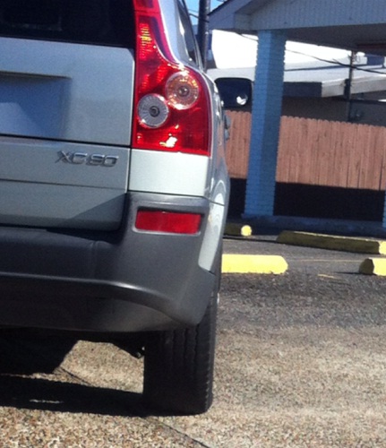

Thanks for your reply,
Here is a picture of the rear tire.
The other side of the rear tire is angled in the opposite direction as well.
- xc90.jpg (74.24 KiB) Viewed 828 times

http://forums.swedespeed.com/showthread ... ment-Specs
You have negative Camber which is normal. Although the XC90 in the link has 18" wheels the rear calls for more Neg. Camber than Pos. even though both can be within Specs.
