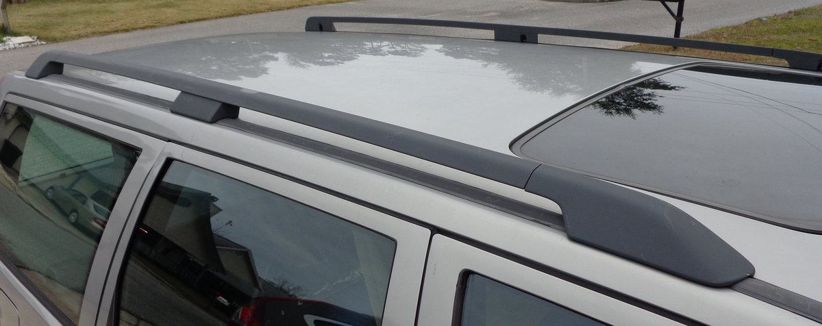

I bought a set of so-called "Euro rails" off eBay and I'm having issues with the trim bits-- the semi-ovoid bolt cover plates and the rear gutter cover pieces. The new rails did not come with these pieces, and the pieces from my original rails do not fit.
Pics should be attached. If they don't show up, please be patient until I figure it out.
1. What kind of rails do I have?

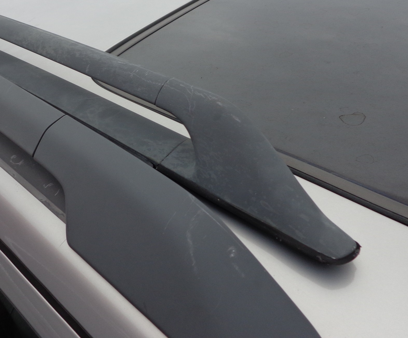

The original rail is sitting to the inside of the "new" rail, which is mounted.

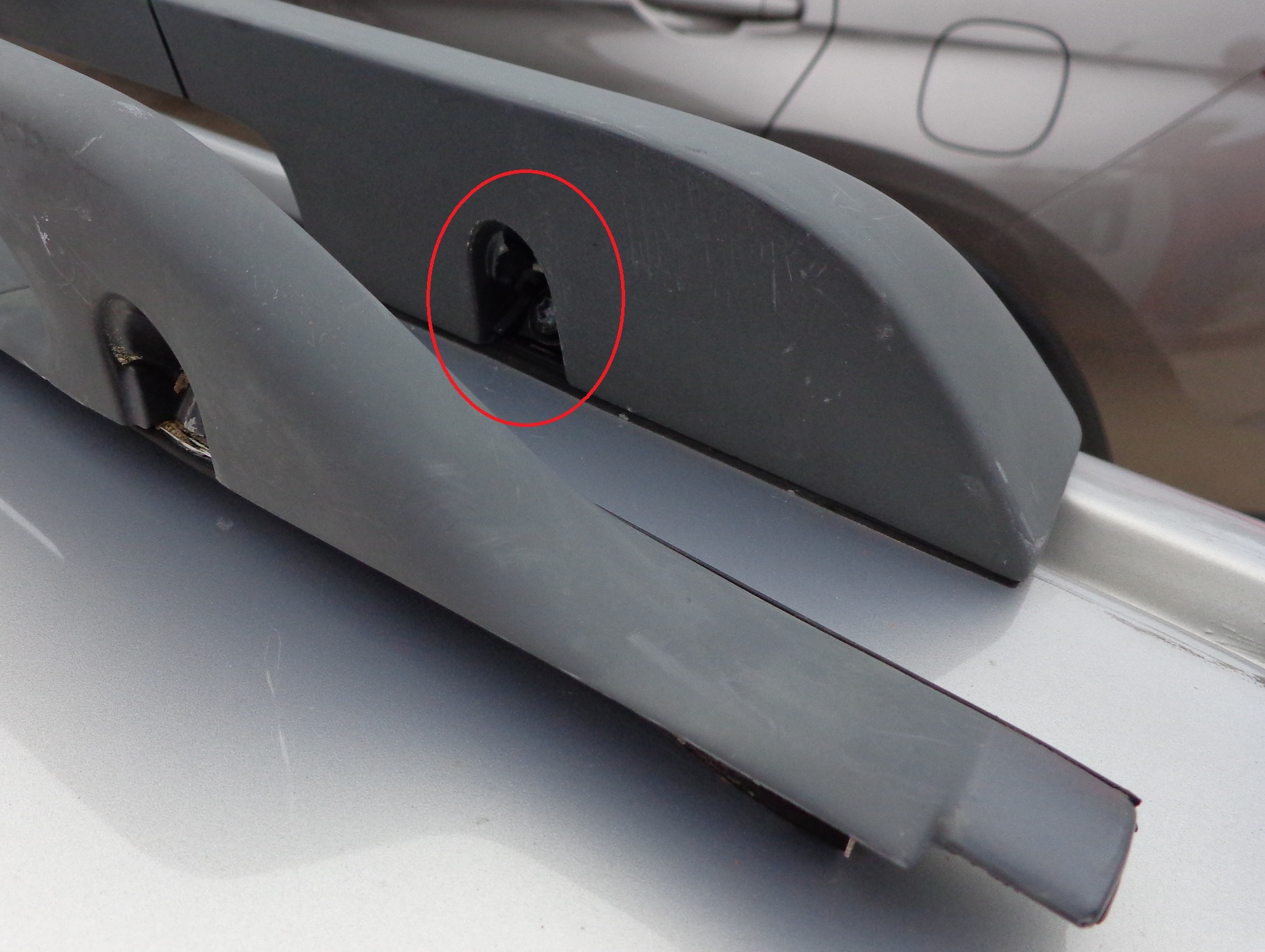

2. The bolt recesses on the new rails are about 50% larger than the original ones, so the little plastic covers don't fit. I have been to the dealership and searched the parts catalog for the 855, V70, and XC70; they only list one part for all these models, and it's the small cover.

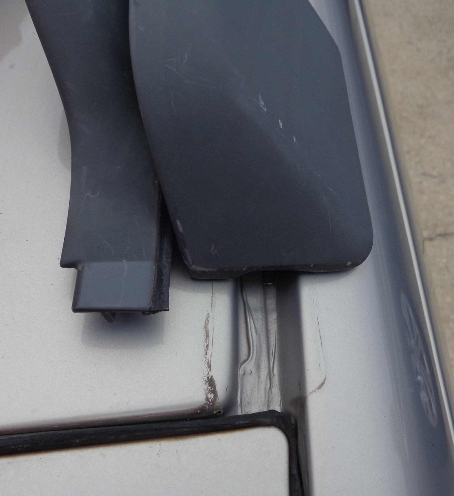

3. The new rails leave a longer portion of exposed roof channel than the original ones. Thus, the original trim pieces that cover the rearmost couple of inches behind the rails are too short. I positioned the old rail next to the new one to show the extra gap.

There are two types of rails
Standard rails and the thicker XC rails
Those newer rails may be P2 (2001-2007) rails which are entirely different

The thicker style roof rails were fitted to the 99- phase one V70 cars in the UK/ Europe, mine has them on it, I will look up the part numbers for the missing trim parts in the morning on Vida - Mike
mikealder
- Posts: 817
- Joined: 25 October 2009
- Year and Model: V70 2000
- Location: Blackpool
- Been thanked: 13 times
Front/ Rear Cap (4 off) 9178516
Centre Cap (2 off) 9178649
LH End piece trim (1 off) 9178517
RH End piece trim (1 off) 9178648
If the main dealer is still messing about tell him to go to section 8 (Body and interior) sub section 89 (miscellaneous) Rails V70 CH 587536-, V70XC and look at diagram 8a of the two types shown on the screen - Mike
