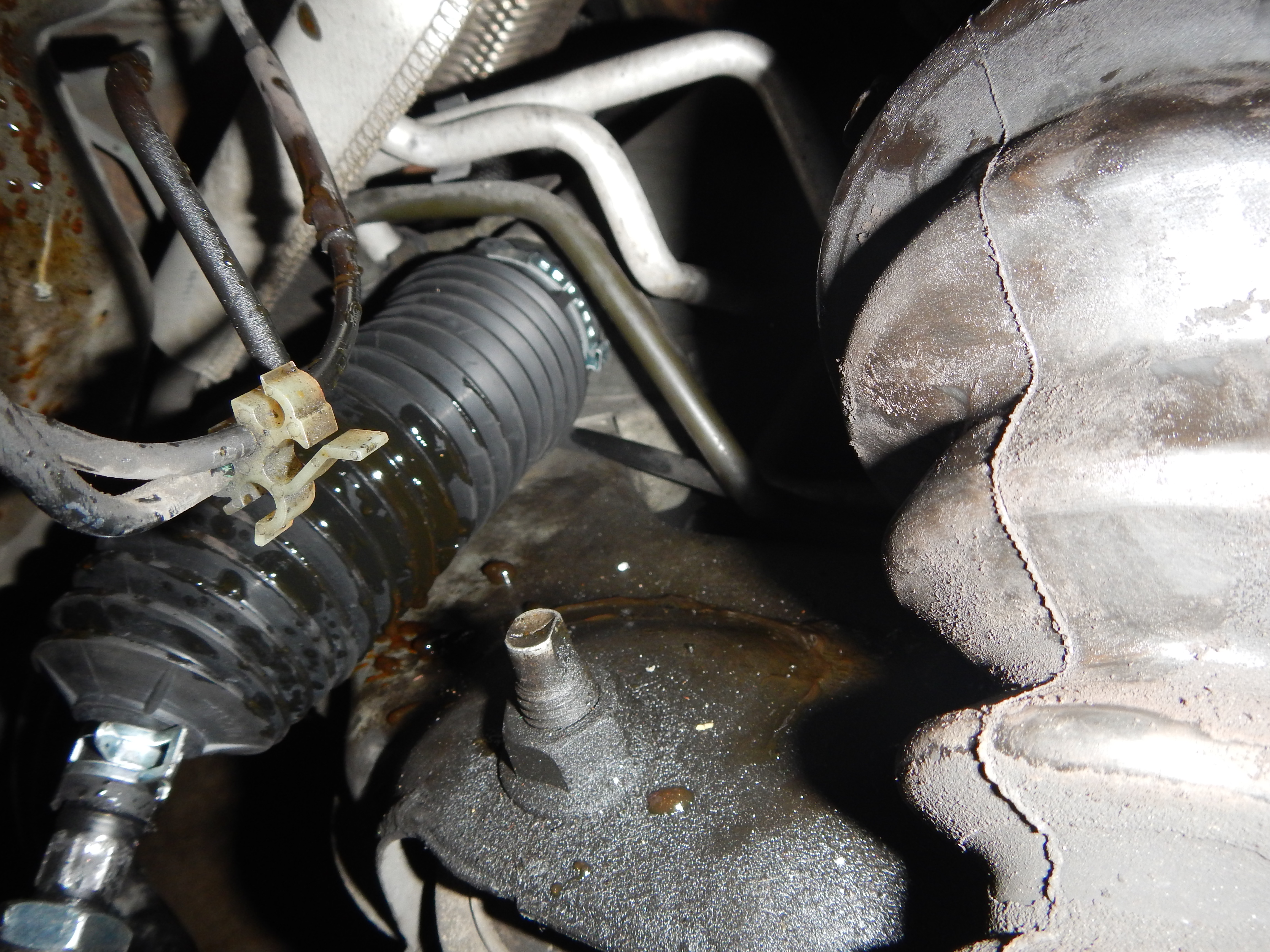

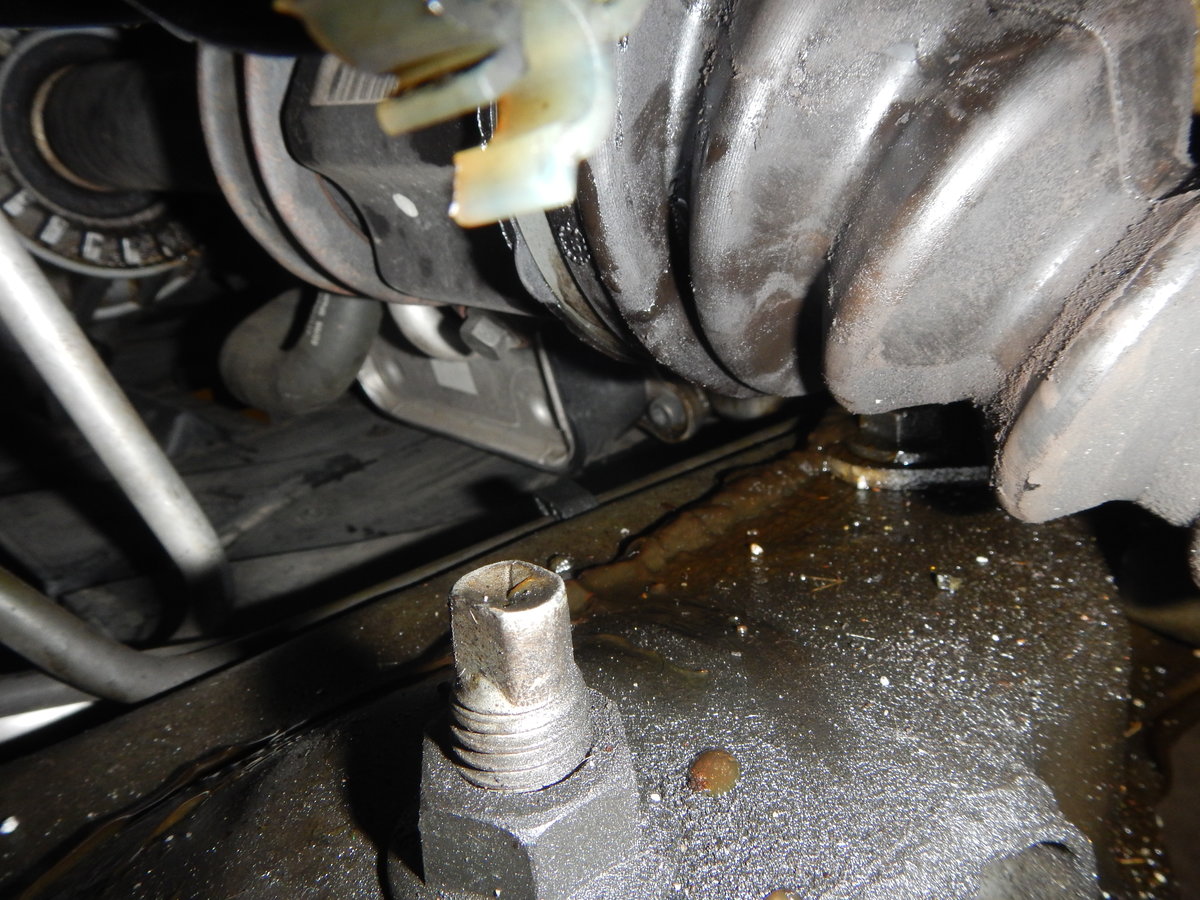

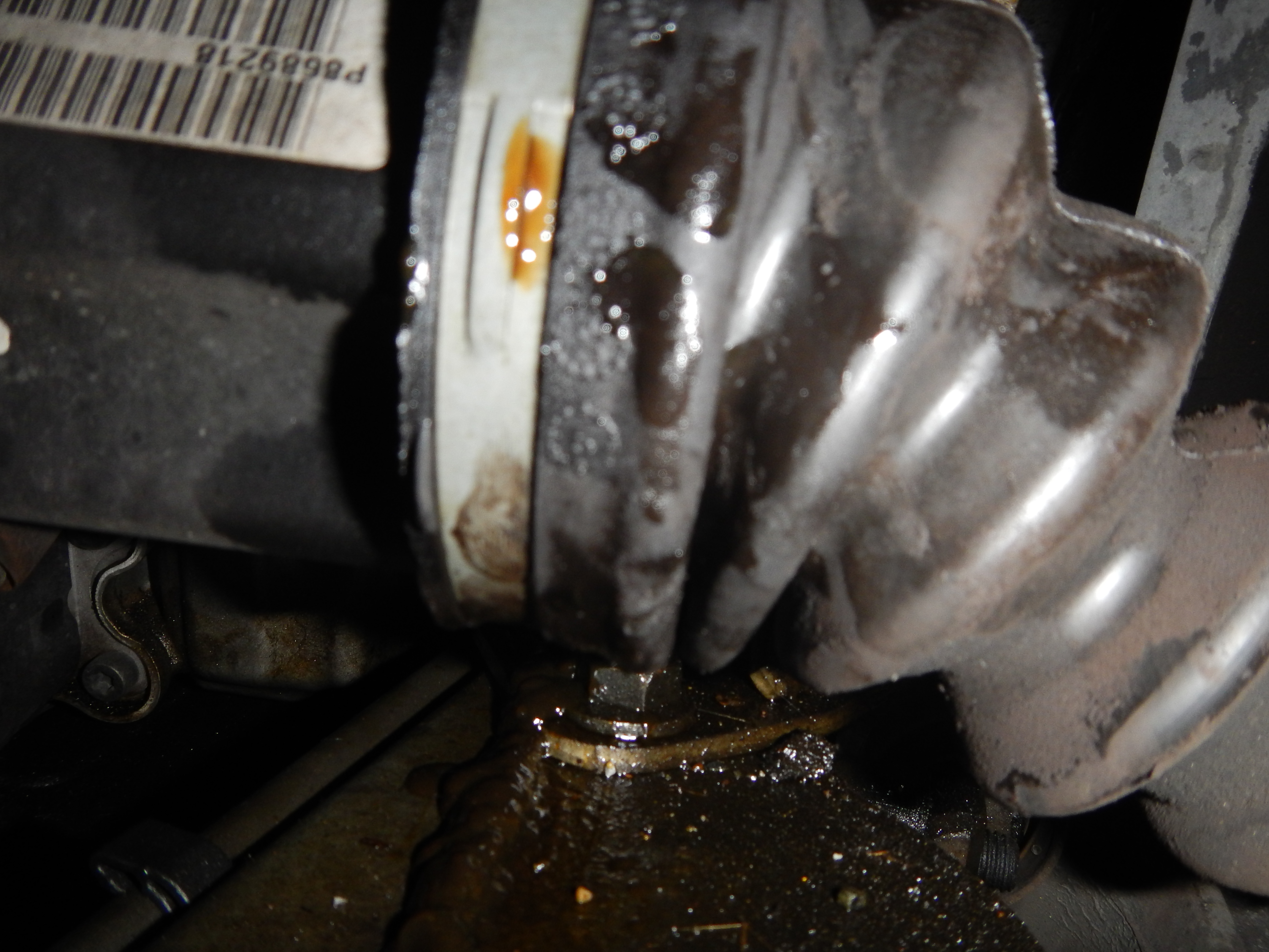

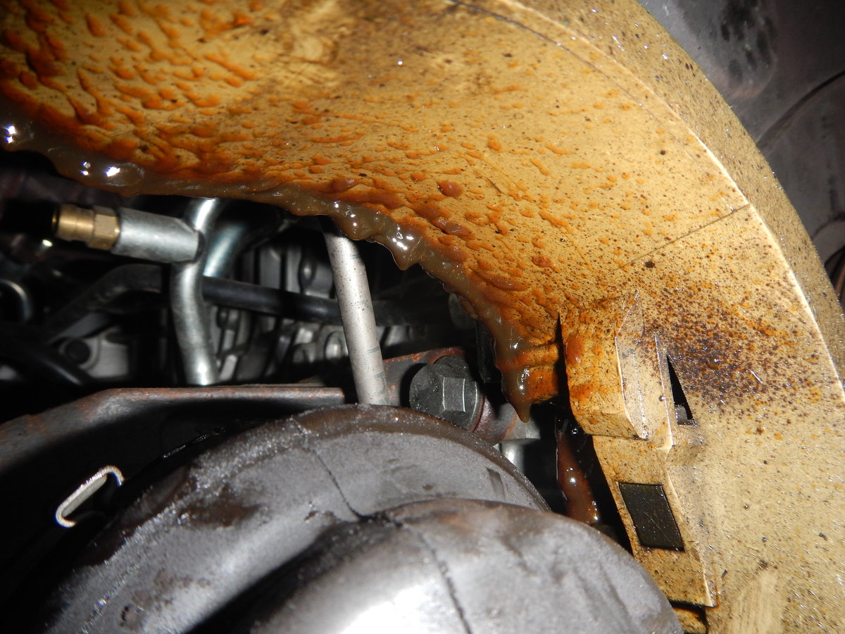

Hey all, so today I noticed there were quite a bit of grease around my inner CV join passenger side, I took the wheel off and noticed there was quite a buildup on the parts around the inner clamp on the boot. I just replaced my shocks and I'm thinking they're related somehow, maybe the boot got stretches too far when I was pulling on the knuckle to get strut back on.
I'm curious, the car has 165k miles on it, would it be best to get a new axle all together or just replace the boot? I've never done anything like this and curious how hard it is to get the passenger axle off and on. See pictures for grease, the texture is more greasy than just oil
Any advice appreciated, thanks!

Update: Decided to replace axle, got the axle out with instructions from other posts here, appologies for making a new, should have done a better search first.
Noticed there were some different instructions on how to get it out but I took off what I'm more familiar with starting with ABS cable, bottom end link, tie rod end, then I went for the two strut bolts since I have lifetime alignment on this vehicle. Made it very easy to get shaft out, I also took off the bearing carrier but don’t think that was necessary. Got a new unit from local auto place and installed in reverse order. Great posts on how to do this already here and I'll make sure to do a more thorough search next time.

I was wandering about your final fix of the leaking CV joint. I have a very similar scenario--in my case, the old joint was leaking, then put a new one on and that was leaking, and yet put another new one on, and that was leaking. Are we all sure that the joint/boot is the culprit? How about other things at play?

actually turned out to not be a split boot but the seal on the "inside" of the boot was leaking and trowing out grease. I bought a new one but also got a boot for inner and outer from IPD. One evening I was felt like it I took it apart and marvelled at the engineering in there, after cleaning it up. it took me a few days to take it all apart and get thoroughly cleaned out but eventually got it greased up and back together, its now a spare part on the trophy wall.
I'm not super happy with my new axle, there is some vibration on right turns when giving some gas, might be I'll go back to my spare next time I take that side apart since it was so easy. I think the original, even with my fix, is better than the after market. GIven how fast it was to get new, put back in and how long it took me to clean CV joint I'm glad I went that way, all in all it was $120 for new axle and driving in 2 hours.
