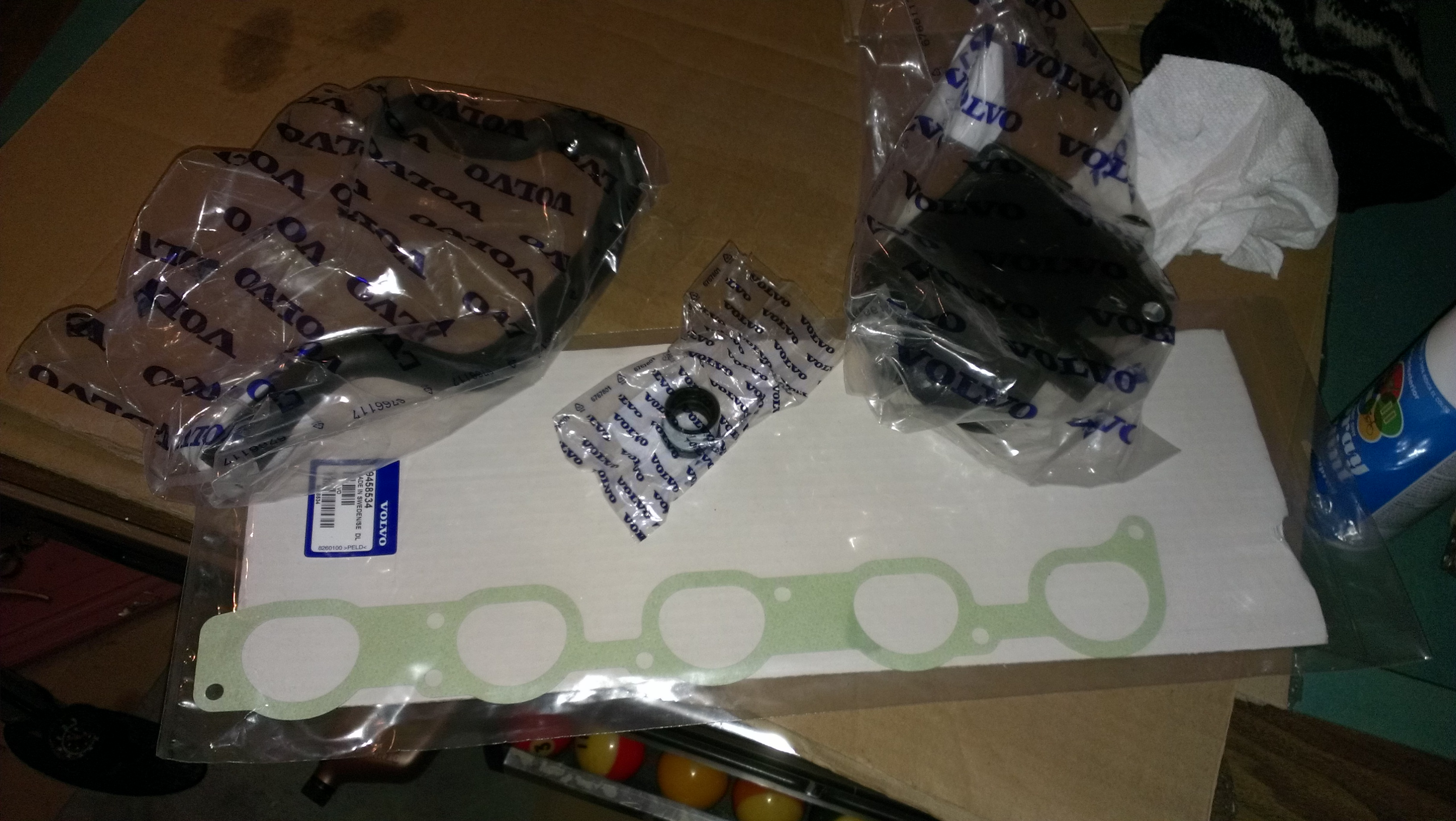

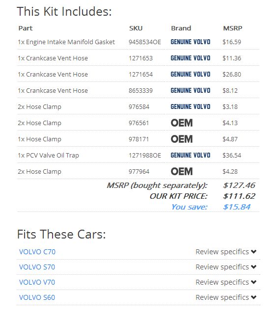

i bought the kit that's marked as OEM from FCP and i believe the parts all came in blue-box cartons and volvo shrink-wrapped packets:
http://www.fcpeuro.com/products/volvo-p ... bo-v70t100
pic attached is what i got in the mail. between this and all the wrappers for the radiator hoses, my garage is absolutely pornographic for the blue-box faithful.
this was for a 99. i dunno if the same parts can be used for earlier cars. FCP does not seem to think so. you can check on the page for their kits exactly what parts will be included and by whom they were manufactured.
EDIT: the point of all this is that if FCP says it'll be OEM, you can trust it.
