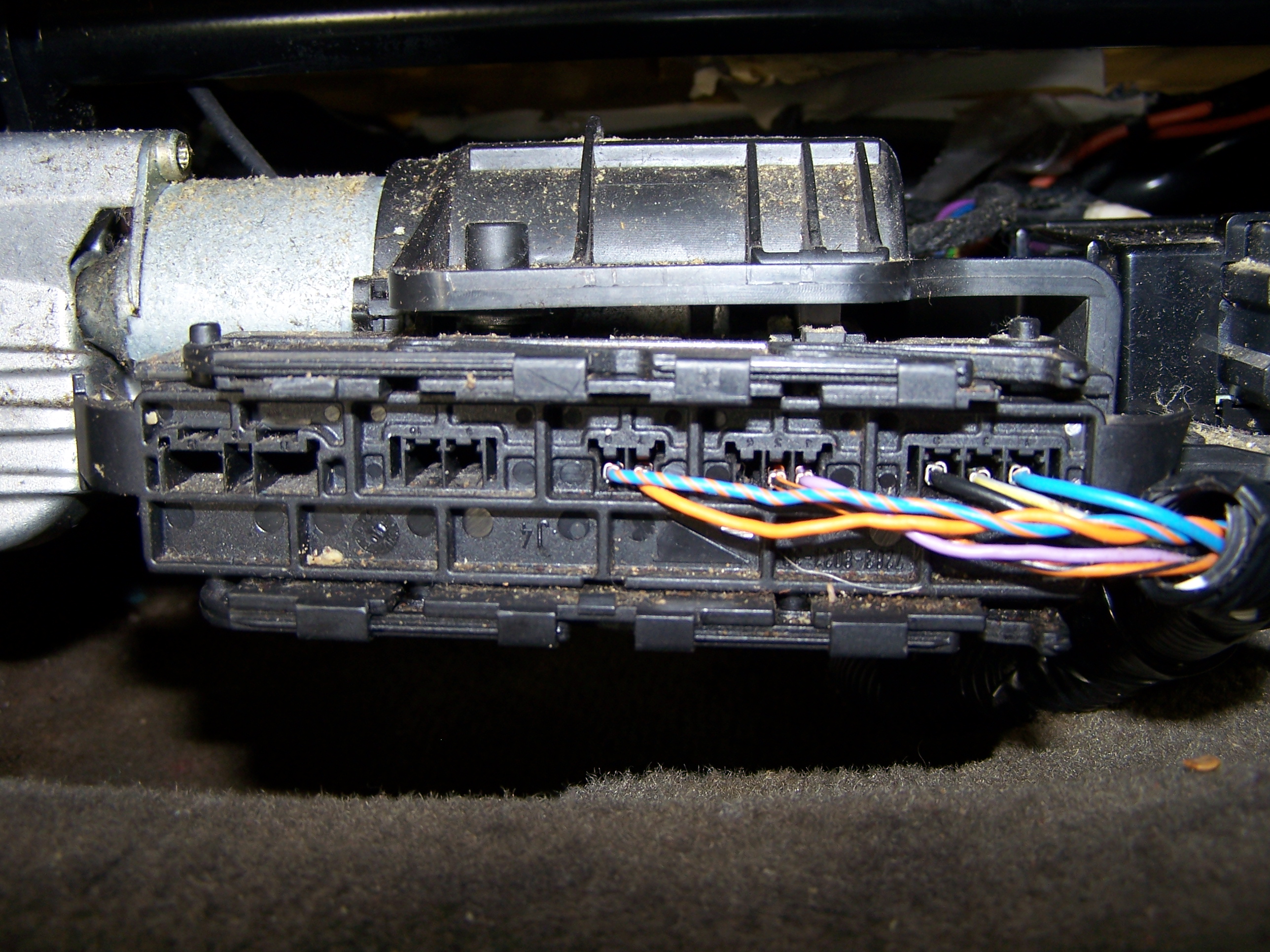

Well it seems that the sips bag wire going up into the seat back from the bottom of the seat is completely separated from the seat bottom. Now, Im trying to remove the plugs in the seat belt module under the seat but I cant get the plug to come out of the housing. It looks as if the sliding lock comes off of the top and bottom but I dont want to force it off and break it, so i need to know exactly how it comes apart. Would anyone happen to know? I need to take the whole seat out of the car to repair this wire. Thanks for anyone's imput.

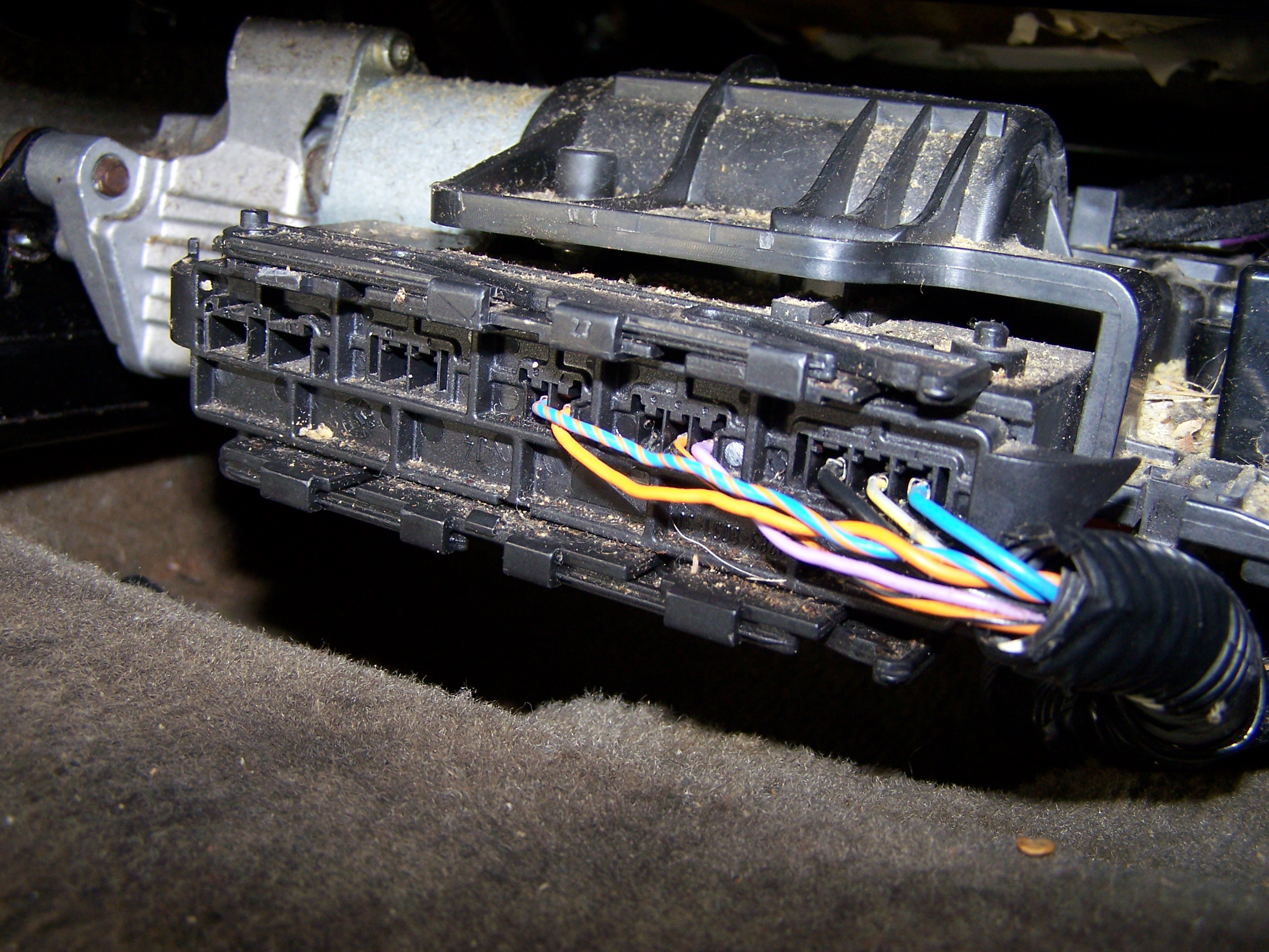

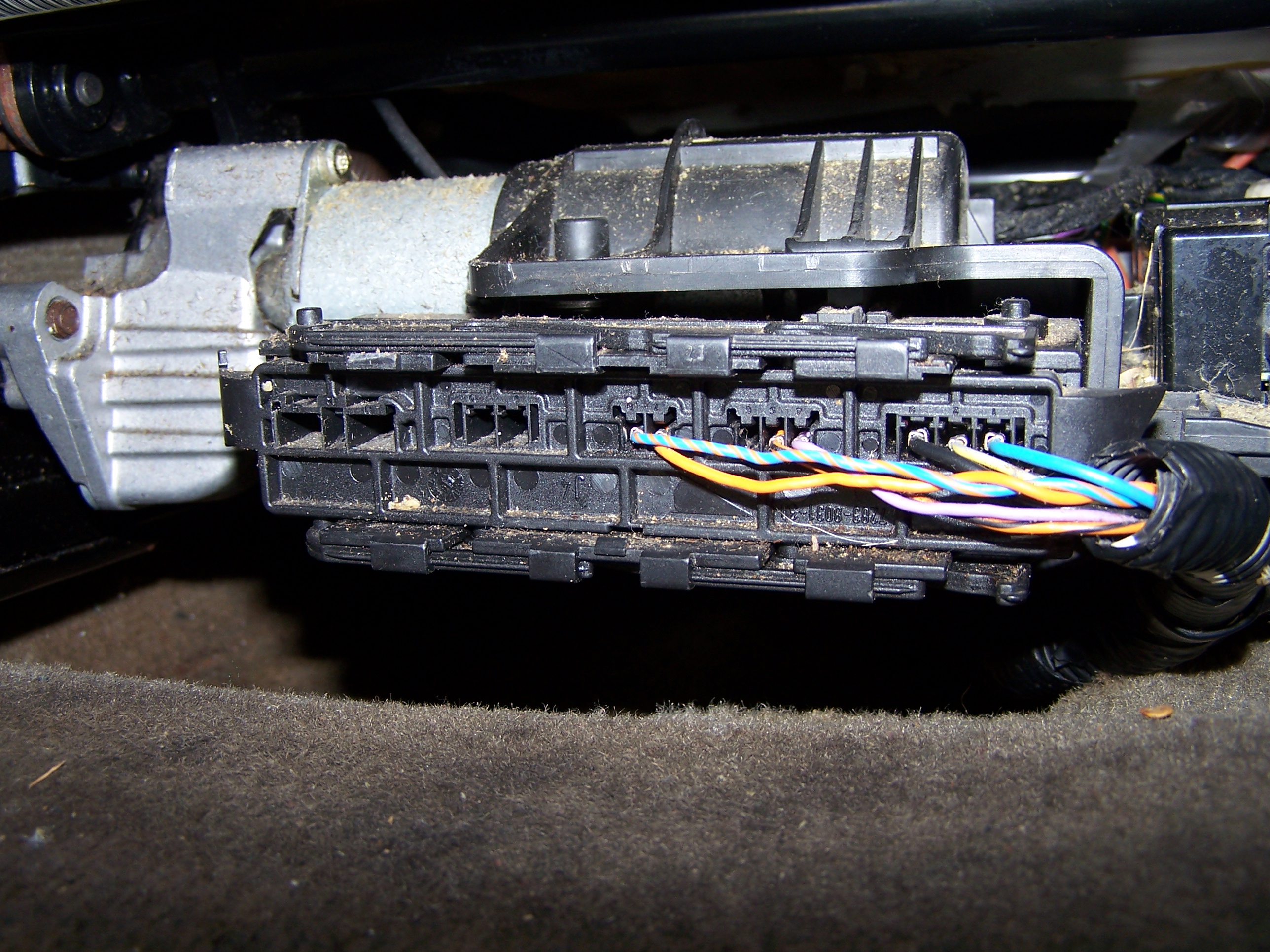

This is the plug Im trying to get apart. What I don't know is if the slide locks on the top and bottom have to be removed from the socket or just slid to unlock the plug bank? Anyone ever took this plug apart? Thanks for any help!
Do these slide locks on the top and bottom of plug bank come all the way off or just slide to unlock and remove the whole socket?

It looks like the same style used on the TCM and ECU... Those just slide to one end and you pull the plug.

Yes, that did work Spenser. They were just a little tight and I did not want to force it and have it break. Thank you.
